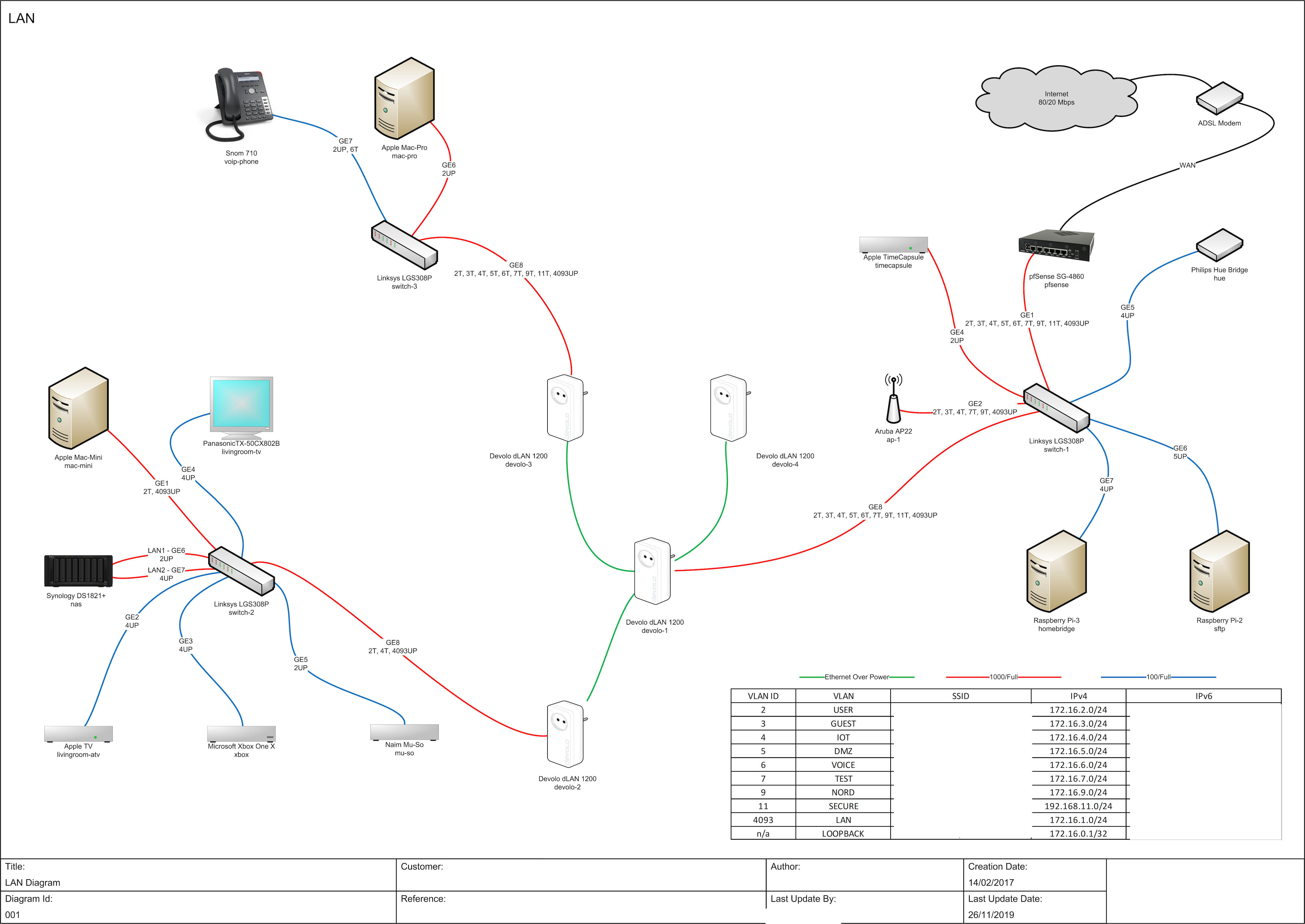

                  pfsense -- vlanSwitch1 -- powerlineA --- powerlineB -- vlanSwitch2 -- devices..
                  It works John, I do it, the LLDP neighbours just look a bit odd.
                  Andy
                        @terramoto said in LAN + VLAN on same interface:
                        @johnpoz
                        The tag, untag would have to be done at each powerline node.
                        Nope it would be done off a switch the other side of the powerline device.
                        Like this, just imaging the AP hanging off switch-3:-
                        Ah the powerline devices are doing the Wi-Fi as well, you need access-points.
                        Andy
