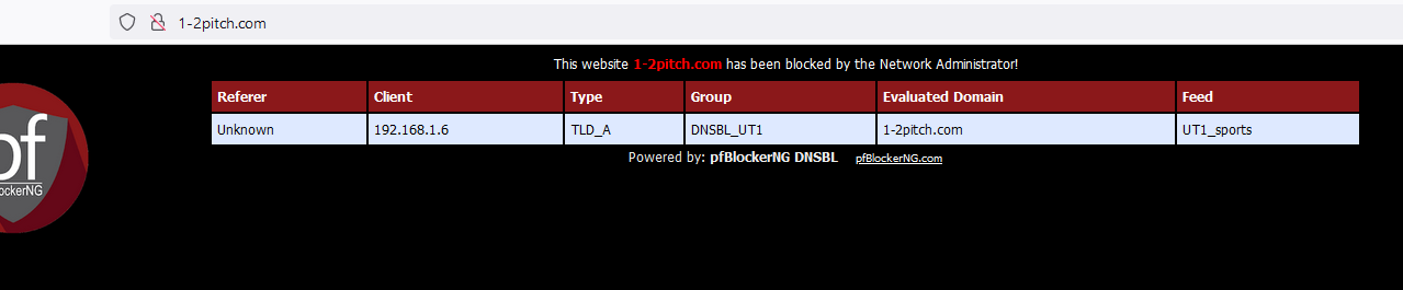

          When I use "1-2pitch.com" in a web browser on my PC, I got the famous :
          although this is very rare.
          Most sites are https these days, so that page can't show. You just see a browser error.

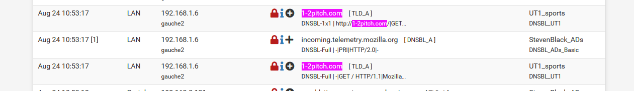

          In the Alerts log of pfBlokcerng-devel I saw :
          and Is have now :
          as there were 3 hits.

              I am not getting any blocking page (https pages)
              These do not exist !!
              Remember, I already said :
              @gertjan said in PfBlockerNG Not Blocking Categories:
              so, you won't see the image I've shown above when you visit a https site.
              The pfblokcerng-devel wb page that shows that page only works if the browser wanted to visit a http site. Pire http, not https site are very rare these days.
              "1-2pitch.com" was one of them, so its probably a site that isn't maintained any more for years now. edit : correction : the domain is for sale now.
              1-2pitch.com will still get blocked : the web sit doesn't show up. That's what counts. For the end user it looks like the site doesn't "work". That's enough. They will abandon after hitting Refresh xx times.
