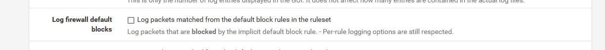

                  Keep in mind that the last rule for every interface is a hidden one.
                  You chose if that one should log :
                  To see your rules, look here : /tmp/rules.debug - looking at that file, and you'll understand why pfSense has a GUI ;)

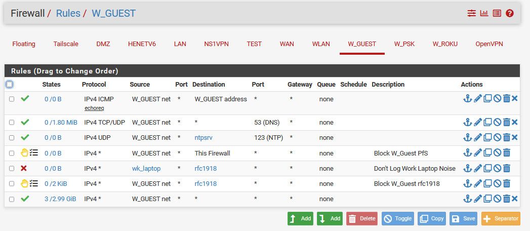

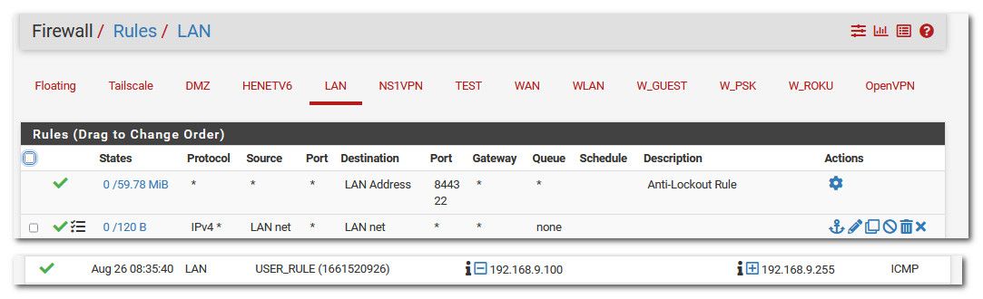

                      edit: Here I created a rule to log traffic to lan net, I then sent ping to the broadcast IP of that "lan net" in my case 192.168.9.0/24
                      You can see it logged it via that rule
                      How would pfsense IP 192.168.9.253 not be included in that "net"

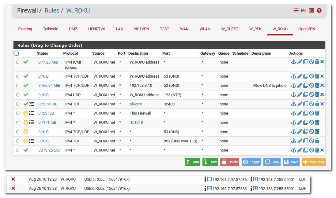

                                  Here is a vlan that I see blocked broadcast in my logs, but that is expected and if I didn't want to see it would be easy enough to not log it. But I don't see enough of it to be a concern as log spam, etc..
                                  If I didn't log that rfc1918 space, and the last rule would allow it and not log it, etc.
                                  I personally if I see a lot of broadcast noise that I have no use for - I block it at the switch, same with multicast. Vs just not logging it - why have the noise on the network if I don't have any use for it. If I would need it and just didn't want it in the logs I would redo the rules and logging so I don't see sort of thing.

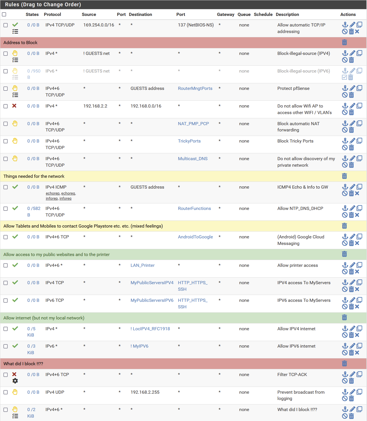

                                    John, hereby my guest rules.
                                    Note that IMHO for FW IPV6-is a crime due to the "unpredictable" source addresses, with as result that filtering on source IP is no option any longer. Filtering on GUEST-net or !GUEST-net is not working (in case IPV6). That is the reason that I did disable the third rule and I assume that your rulesets using "xyz-net" as source selection will not work in case IPV6
                                    Further on see picture below
                                    • johnpozJ Online
                                      johnpoz LAYER 8 Global Moderator @louis2
                                      @louis2 first thing why do you have that 169.254 address rule - are you routing that, out of the box that address space doesn't route, and normally the ttl is 1 on traffic from it so it doesn't even route if you even allow for it, etc.
                                      It has 0/0 so traffic has ever been seen.
                                      Your rule 192.168.2.2 to 192.168/16 would block and not log any broadcast traffic to 192.168.2.255
                                      Then the next 3 rules pretty meaning really. No hits on them, not sure what trickyports are - but no hits. But unless you have UPnP enabled on pfsense, that would never be allowed anyway. And if you were going to enable it, you could lock down who could do it in the UPnP settings.
                                      That blocking multicast dns - you understand that would only be to pfsense.. A device on that network can still talk to every other device on that network and discover it. Pfsense has no control over what devices do between themselves on the same network, be it unicast, broadcast or multicast.
                                      Your use of bang rules is would would be causing you to see broadcast from other than 192.168.2.2 which your not logging.
                                      If you just had a block rule above those that blocked access to rfc1918 space and you didn't log it. And then a allow rule any for internet, you wouldn't be seeing the broadcast noise.
                                      Why do you have source as any? Are you using this network as transit, the only real possible traffic that could ever be seen into this interface would be coming from devices on this network 192.168.2/24 Why would you allow all other traffic - doesn't make a lot of sense. Notice on my rules above the source is always the network net of that interface.
                                      • L Offline
                                        louis2 @johnpoz
                                        @johnpoz
                                        because I noticed that sometimes, even given DHCP availability, that emergency procedure is used
                                        I want to assure that the WIFI-repeaters from my networks do not communicate via the WIFI
                                        • I disabled Upnp, the idea that a computer is allowed to open FW-ports ..... never
                                        • Tricky ports is a collection of ports which should never be allowed telnet ..... RPC, netbios etc
                                        yep and no. It is only the guest lan and even not that, since the guest network is largely configured as a private lan
                                        I do not understand this. Note that 192.168.2.2 is the WIFI Access-point
                                        I fix that at the end
                                        because
                                        • LAN-net is not working for IPV6 (I disabled the rule)
                                        • and I do filter <> LAN-net as one of the first rules (for IPV4)
                                        • also not that it is extra security, but normally spoken other addresses than lan-net should not / can not occur
