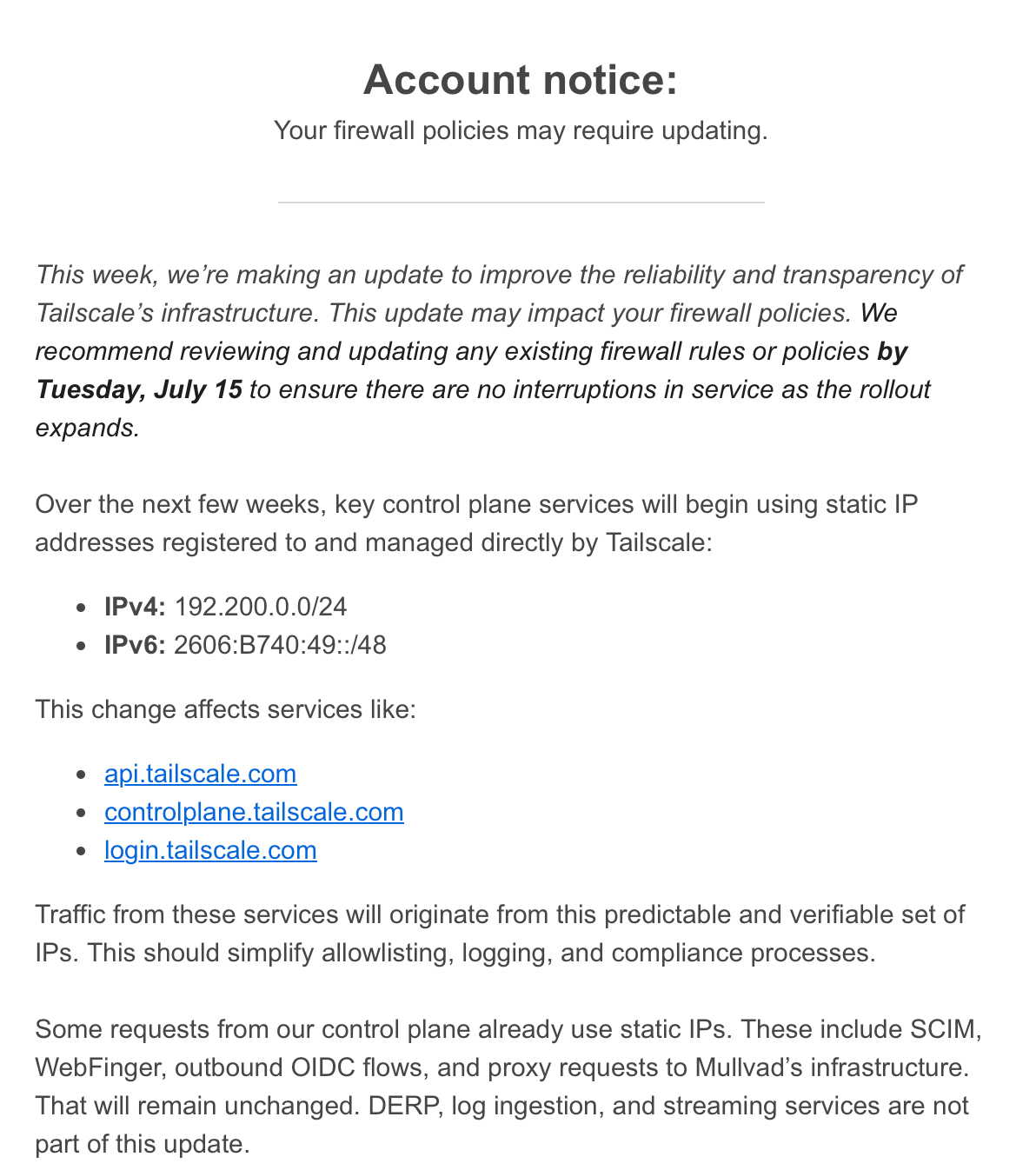

                          Anyone else get the following notification from Tailscale?
                          And what, if anything, do we need to do?
                          TommyMooT V 2 Replies Last reply Reply Quote 0
                          • TommyMooT Offline
                            TommyMoo @elvisimprsntr
                            @elvisimprsntr I got this mail too, an hour ago, also dont know, what we have to do right now...didnt had time yet to read full instructions and what consequences it will bring for us
                            • V Offline
                              veddy254 @elvisimprsntr
                              @elvisimprsntr they're updating the backend control structure to use new IP addresses. If you use tailscale's own servers for management instead of a self-hosted Headscale instance, you just need to make sure that your pfsense firewall does not block connections to those IP ranges. By default, both ranges would be allowed so unless you've added restrictive rules, you don't need to do anything. I'd still recommend verifying that they're not blocked first though.

                                • E Offline
                                  elvisimprsntr @veddy254
                                  @veddy254
                                  Thanks
                                  ping 192.200.0.1
                                  PING 192.200.0.1 (192.200.0.1): 56 data bytes
                                  64 bytes from 192.200.0.1: icmp_seq=0 ttl=45 time=120.432 ms
                                  64 bytes from 192.200.0.1: icmp_seq=1 ttl=45 time=129.154 ms
                                  64 bytes from 192.200.0.1: icmp_seq=2 ttl=45 time=121.636 ms
                                  64 bytes from 192.200.0.1: icmp_seq=3 ttl=45 time=132.175 ms
