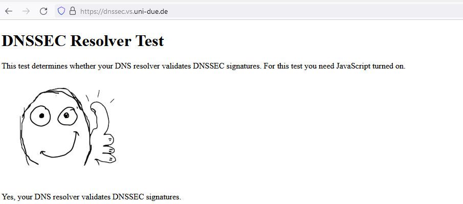

        So it's indeed a time sync problem that prevents DNSSEC to work.
        Also, changing to America/Sao_Paulo actually set the clock right this time, so, it was fixed in pfsense 2.5.

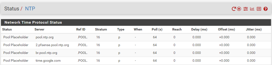

              If I look at Status / NTP
              It's not synchining and I've added several pools to try.

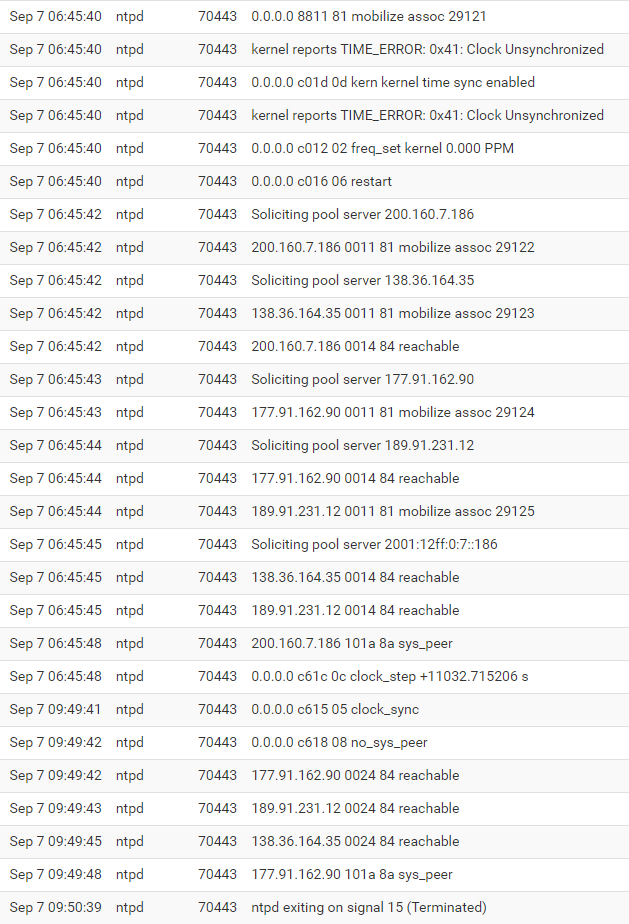

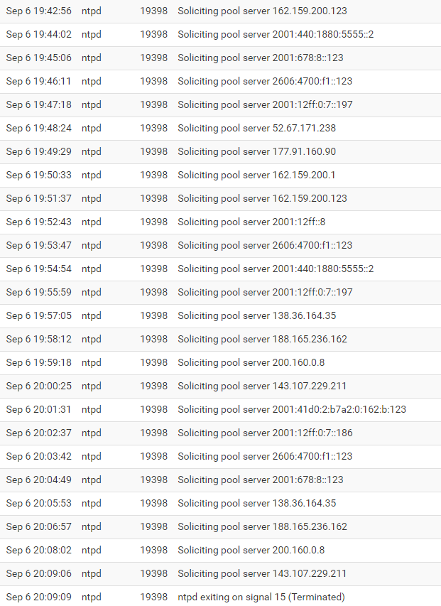

              Here's the log for the NTP service trying several servers without any success:
              https://pastebin.com/Hqna2gvQ [too big to post here]
              The lan ip is the android server that is off for now.
              I have no idea how it managed to sync that only time but as you can see something (proably my ISP) is blocking it because I see this same problem with windows server, with unraid.. and so on.

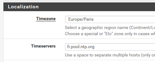

                      Pick your NTP pool or server from here https://www.ntppool.org/en/, or, why not, keep the default one.
                      There is only one important setting in pfSense :
                      This one :
                      and you can consider to select a pool nearby. But that's optional.

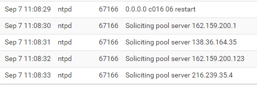

                                  I did a quick capture here looking at the NTP logs:
                                  And the capture:
                                  11:08:25.168577 IP 135.181.21.151.59574 > ***.***.***.***.64050: tcp 1435
                                  11:08:25.172578 IP ***.***.***.***.123 > 162.159.200.1.123: UDP, length 48
                                  11:08:25.180765 IP 135.181.21.151.59574 > ***.***.***.***.64050: tcp 1435
                                  11:08:25.180994 IP 135.181.21.151.59574 > ***.***.***.***.64050: tcp 1435
                                  No response.

                                  Nothing here too
                                  11:08:32.264276 IP ***.***.***.***.64050 > 135.181.21.151.59574: tcp 0
                                  11:08:32.265292 IP ***.***.***.***.123 > 162.159.200.123.123: UDP, length 48
                                  11:08:32.265896 IP 135.181.21.151.59574 > ***.***.***.***.64050: tcp 1435
                                  11:08:32.265941 IP 135.181.21.151.59574 > ***.***.***.***.64050: tcp 1435
                                  Again, nothing.
                                  I just removed my IP from the capture but that's it, no response.

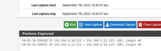

                                        @fandangos so you on your sniff you show traffic leaving pfsense where the source is not 123, and they get no answers either. Or did you disable their ntp servers and just use your work around..
                                        Just want you to have as much info as possible when complaining to your isp. A good sniff showing traffic with source port 123 and other with other source port that your not getting any answers to anything that you send to port 123 ntp..

                                          not sure if I follow.
                                          I don't know what those TCP packets are. I just pasted those to show that right after the UDP 123 request there's nothing comming back at 123.

                                          Now I've found a docker container on Unraid called NTP that by the description uses chrony:
                                          https://hub.docker.com/r/cturra/ntp
                                          installed it and used
                                          pool.ntp.org, time.google.com
                                          as NTP_SERVERS
                                          Log from this docker container:
                                          2022-09-07T14:43:54Z chronyd version 4.1 starting (+CMDMON +NTP +REFCLOCK +RTC +PRIVDROP -SCFILTER +SIGND +ASYNCDNS +NTS +SECHASH +IPV6 -DEBUG)
                                          2022-09-07T14:43:54Z Disabled control of system clock
                                          2022-09-07T14:43:54Z Could not read valid frequency and skew from driftfile /var/lib/chrony/chrony.drift
                                          2022-09-07T14:43:59Z Selected source 143.107.229.210 (pool.ntp.org)
                                          2022-09-07T14:43:59Z System clock wrong by 74.923575 seconds
                                          2022-09-07T14:43:59Z Could not step system clock
                                          2022-09-07T14:44:01Z System clock wrong by 74.923624 seconds
                                          So I set my unraid box as ntp server on pfsense and look at this:
                                          10.27.33.198 is my unraid box.
                                          So... I'm lost, the docker is able to access the NTP pool but Pfsense and unraid itself is not?
                                          Sep  7 11:58:53 Tower root: Stopping NTP daemon...
                                          Sep  7 11:58:54 Tower ntpd[1525]: ntpd 4.2.8p15@1.3728-o Fri May 21 19:02:16 UTC 2021 (1): Starting
                                          Sep  7 11:58:54 Tower ntpd[1525]: Command line: /usr/sbin/ntpd -g -u ntp:ntp
                                          Sep  7 11:58:54 Tower ntpd[1525]: ----------------------------------------------------
                                          Sep  7 11:58:54 Tower ntpd[1525]: ntp-4 is maintained by Network Time Foundation,
                                          Sep  7 11:58:54 Tower ntpd[1525]: Inc. (NTF), a non-profit 501(c)(3) public-benefit
                                          Sep  7 11:58:54 Tower ntpd[1525]: corporation.  Support and training for ntp-4 are
                                          Sep  7 11:58:54 Tower ntpd[1525]: available at https://www.nwtime.org/support
                                          Sep  7 11:58:54 Tower ntpd[1527]: proto: precision = 0.043 usec (-24)
                                          Sep  7 11:58:54 Tower ntpd[1527]: basedate set to 2021-05-09
                                          Sep  7 11:58:54 Tower ntpd[1527]: gps base set to 2021-05-09 (week 2157)
                                          Sep  7 11:58:54 Tower ntpd[1527]: Listen normally on 0 lo 127.0.0.1:123
                                          Sep  7 11:58:54 Tower ntpd[1527]: Listen normally on 1 br0 10.27.33.198:123
                                          Sep  7 11:58:54 Tower ntpd[1527]: Listen normally on 2 lo [::1]:123
                                          Sep  7 11:58:54 Tower ntpd[1527]: Listening on routing socket on fd #19 for interface updates
                                          Sep  7 11:58:54 Tower ntpd[1527]: kernel reports TIME_ERROR: 0x41: Clock Unsynchronized
                                          Sep  7 11:58:54 Tower root: Starting NTP daemon:  /usr/sbin/ntpd -g -u ntp:ntp
                                          Sep  7 12:00:17 Tower ntpd[1527]: receive: Unexpected origin timestamp 0xe6c33036.73536c7b does not match aorg 0000000000.00000000 from server@216.239.35.12 xmt 0xe6c33081.7014ee6e
                                          10.27.33.1 is the pfsense router.
                                            johnpoz LAYER 8 Global Moderator @Fandangos
                                            @fandangos
                                            see here
                                            That is your IP talking to that 162, see the .123 is the port your talking from the "source" port.. and then the .123 on the 162 address is the "destination" port
                                            If you notice in my traffic, that 69 address is mine the source port is 23455, and the destination is 123..
                                            When traffic is natted through pfsense the source port is almost always changed.. This is how napt (network address port translation) works.
                                            So you could have your machine 192.168.1.100:X talking to 8.8.8.8:443 when pfsense nats it to your public IP it would be like this
                                            Your public IP 1.2.3.4:Y going to 8.8.8.8:443
                                            Its common for many ntp clients to use source port 123, pfsense would use that or should - here for example is client on my network talking to through pfsense to my ntp server.. Since they are on different vlans. See how its source port 123 to destination port 123
                                            Its a possibility that your isp is blocking traffic that has a source port of 123, because the return traffic to that would be to 123.. So it would be good to see if you still don't get answers to ntp with the source port is not 123..
                                            Any client behind pfsense trying to talk to ntp out on the internet, be it using 123 or not would be natted on pfsense to some other source port.
                                            Which if your saying no ntp client works behind pfsense, that its most likely not the case - but its good to have that info to tell/show the ISP when you complain.
