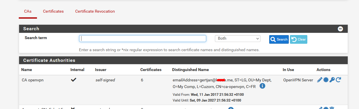

              On the server side, pfSense, you should use your own main CA certificate like :

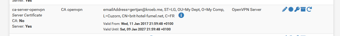

              (you have to make one) and a certificate for the OpenVPN server based on this CA :
              This certificate is used in the server instance :

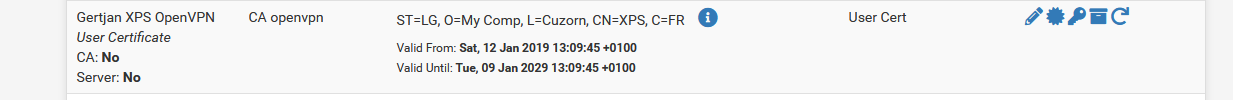

              For every openvpn client user you also make a cert :
              and that one gets exported for 'client' use.
