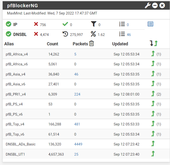

                              • GertjanG Online
                                Gertjan @StormGate
                                @stormgate
                                Just don't.
                                PHP is parsing that file. PHP isn't the tool you want to parse such a file.
                                I've activated that DNSBL_UT1 on my 4100-MAX : even the restart of unbound took 30 seconds to start.
                                When you see things like this in the pfblokcerng 'update' log, you know you should back of.
                                TLD analysis........xxxxxxxxxxxxxxxxxxxxxxxxxxxxxxxxxxxxxxx completed [ 09/12/22 17:13:06 ]
                                ** TLD Domain count exceeded. [ 800000 ] All subsequent Domains listed as-is **
                                Anyway .... a list with 4+ million DNSBL ...... and only 4 hits ?
                                [ Force Reload Task - All ]
                                UPDATE PROCESS START [ v3.1.0_4 ] [ 09/12/22 17:07:16 ]
                                UPDATE PROCESS ENDED [ 09/12/22 17:16:27 ]
                                Yep, 10 minutes, as it needed 6 minutes to download this U1 file.
                                And now I have to deal with :
                                so using this U1 feed is a no-go for 4 Gbytes.
                                S 3 Replies Last reply Reply Quote 1
                                  StormGate @Gertjan
                                  @gertjan I'll go have a look thank you.

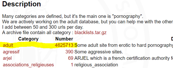

                                    StormGate @Gertjan
                                    @gertjan Looks like the "Adult" category is the large database.

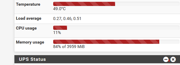

                                        StormGate @StormGate
