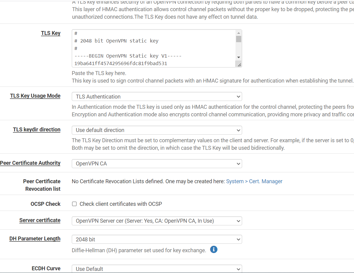

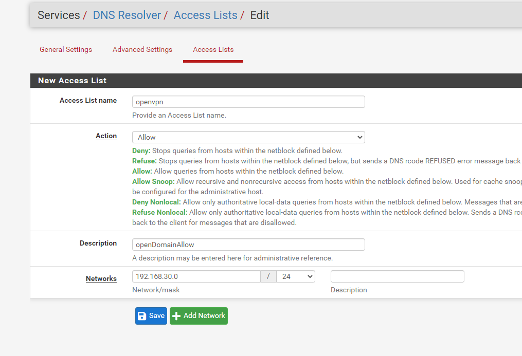

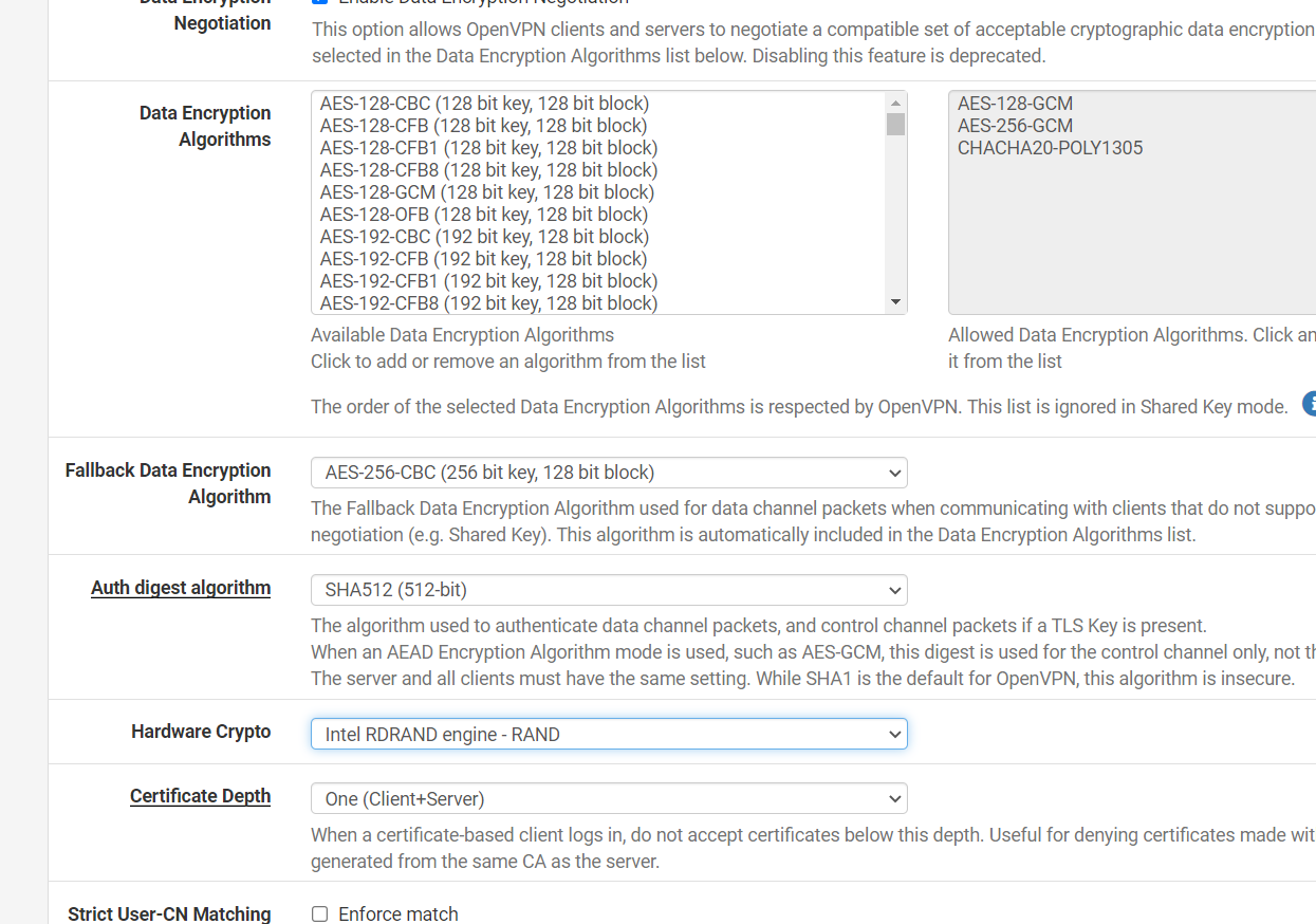

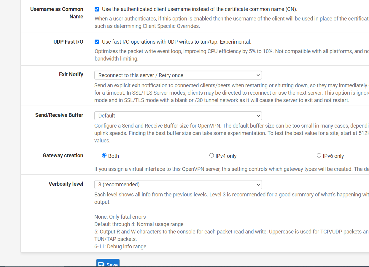

        config like this (3.PNG 2.PNG 1.PNG image url)

          Any reason for using a CBC cipher and setting the hardware crypto to "Intel RDRAND"?
          When you run pfSense on a modern Intel CPU, set the hw crypto to "none" and use the GCM cipher instead.

            -I chose the Intel part because it solves my Speed ​​related problem, but it didn't.
            By GCM do you mean the "Data Encryption Algorithms" part above?

              Also ensure that the DNS server is accepting the DNS requests from VPN clients. Possibly you have to add the tunnel pool to its ACLs.

                Unfortunately I couldn't solve it. I also gave the OPENVPN NETWORK Address to the DNS resolver part, but there was no solution.
