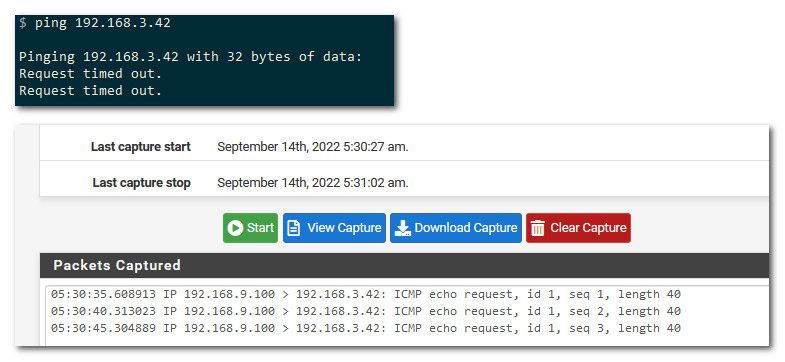

        To prove it to yourself that pfsense is allowing the traffic and sending it on, sniff on the dmz interface for icmp traffic from your source IP, get a ping going - do you see pfsense sending on the traffic? Then your issue is with the device your trying to talk to on the dmz.
        example, pinging 192.168.3.42 (device on my dmz, that I know will not answer).. from my 192.168.9.100 (lan device)
        So clearly ping timesout, but as you can see from sniff on my dmz interface - pfsense sent on the traffic.

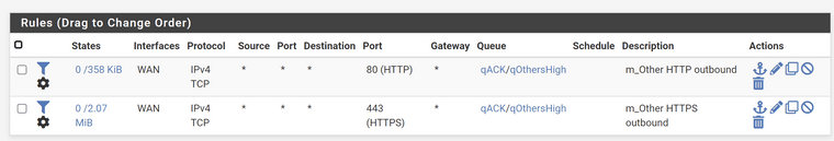

                                          @johnpoz Well I didnt show the entire LAN ruleset because during troubleshooting I moved the any any rules to the top so the rest didn't really matters since everything passed thru that.
                                          As for the floating rules, here it is
                                            johnpoz LAYER 8 Global Moderator @VincentEmmanuel
                                            @vincentemmanuel well floating wouldn't have any issues. What other rules did you have on lan that you moved. If you had created a state, that say for example sent it out a vpn interface or something, that could cause the issue.
