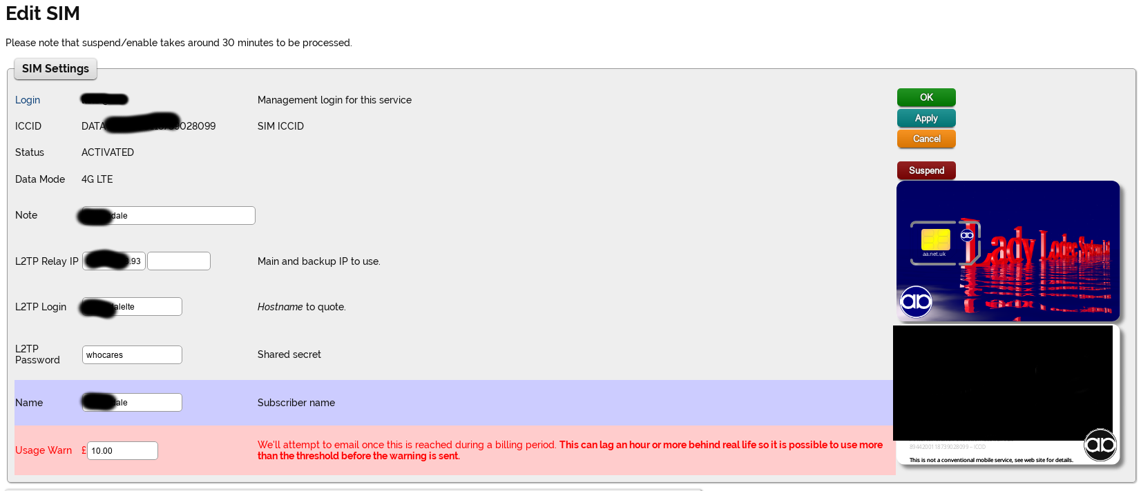

                      If it's any help, here's the setup page on the A&A LNS for each SIM.
                        ruffle

                            For the A&A LNS to PFSense L2TP connection I can set a hostname (aka login) and password (aka secret) for the L2TP connection as the screenshot shows although PFSense doesn't seem to use that info.
                            Each SIM also has a 'dialing number'/ICCID but again PFSense doesn't seem to make use of that.

                                But the first thing to try would be to make sure you have the same hostname set for all clients. The docs there show that will create a single tunnel with multiple sessions across it which is what you need.

                                  Setting the hostname on the A&A SIM control page to the same for each device (well three so far but I'm excited and want to report back ASAP) works :-) :-) :-)
