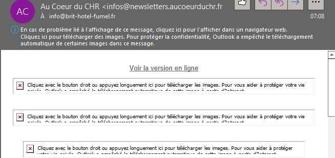

        A mail client can, when receiving a mail from an 'unknown' source, decide not to load any URLs listed in the mail. These are often images, and other content.
        Ones you've selected , Outlook (Office 365) shows this like this :
        ( sorry, French, but you get the picture )
        Ones I click on that text, outlook reaches out to get all the non shown images and other content.
        Btw : this actions often confirms to the sending side you've 'seen' the mail.
        Sometimes a text is shown to 'trust' the host name, or just the mail address, and any further mails from them will get shown immediately and entirely.

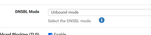

                      Ok, I saw this also :
                      This gets added when you use the 'old' unbound mode :
                      All dnsbl entries, like the feeds, are stored in these files :
                      so unbound reads all /var/unbound/pfb_dnsbl.*conf files upon start.
                      I wasn't seeing /var/unbound/pfb_dnsbl.*conf initially, as I do not use the "unbound mode" any more, the far superior (IMHO) "python mode" was made available when version 3.x came out.
                      Having unbound read in all the DNSBL info upon start is painfully slow. The authors of unbound recommend using this mode when huge file handling needs to take place.
                      • N
                        newUser2pfSense
                        @Gertjan Thanks for that tidbit of info. I now set my DNSBL Mode to Unbound python mode. I'll see if this will strip out unwanted malvertising from my emails.
