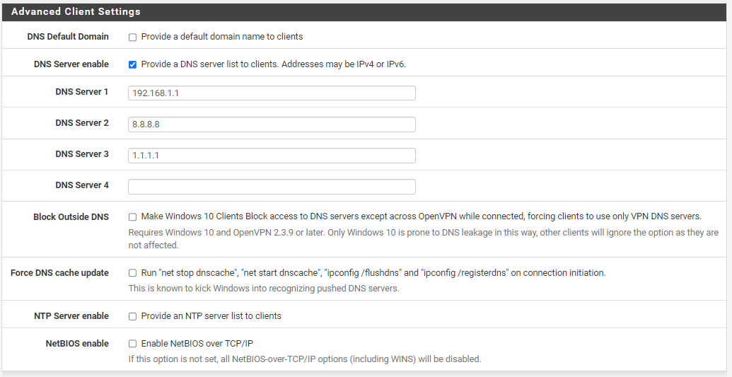

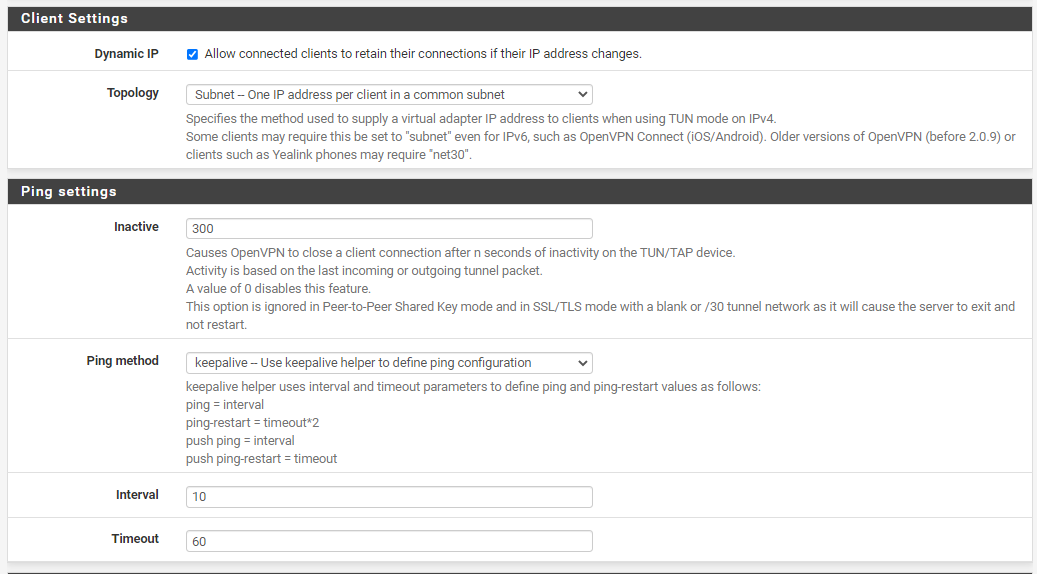

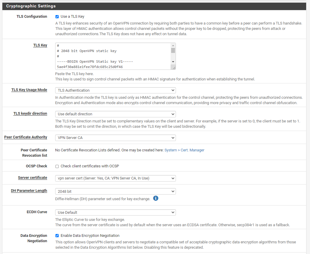

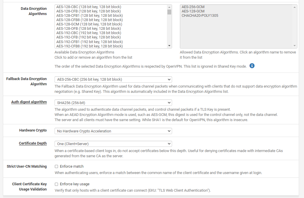

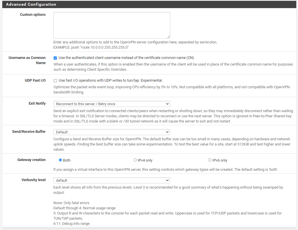

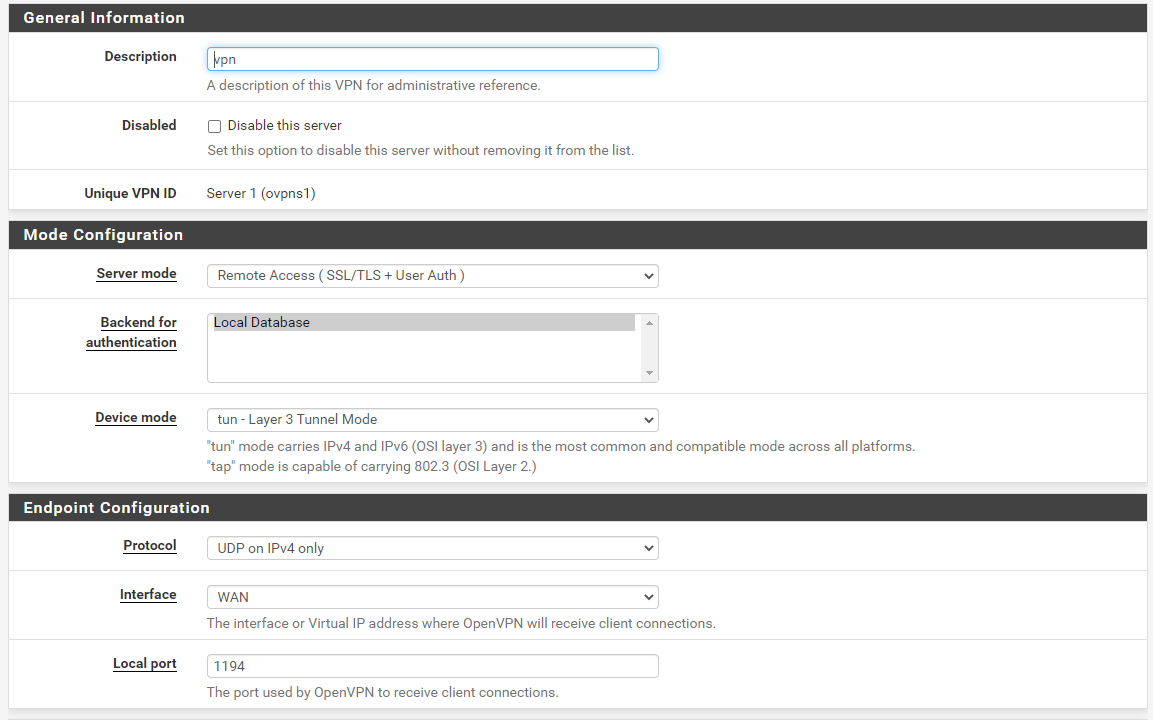

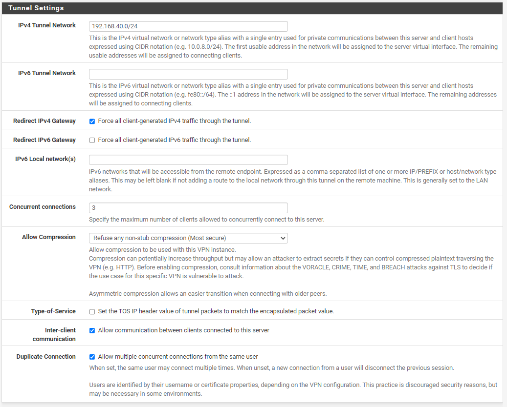

      VPN server configeration:
      7faaa51f-97f7-43da-80df-4d9306b1d392-image.png a2d6e9fc-ac8c-496a-9ef1-4db851048114-image.png
      once again thanks for your help, happy to answer any questions.
