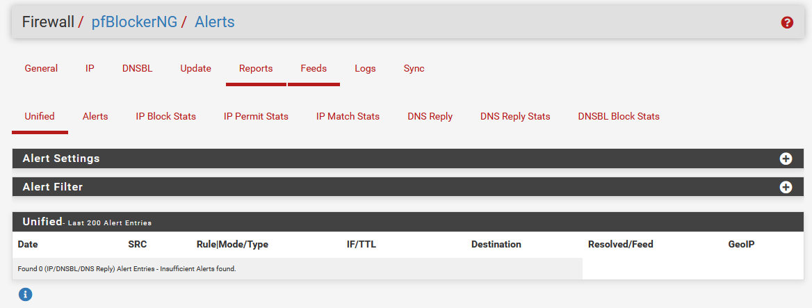

            My Alerts are:

              @noonstarx said in pfblocker is not working. it does not block anything.:
              My Alerts are:
              Your log shows filtered stuff on the WAN interface.
              You have NAT rules ? Or letting traffic in ?
              If not, don't bother filtering the WAN.
