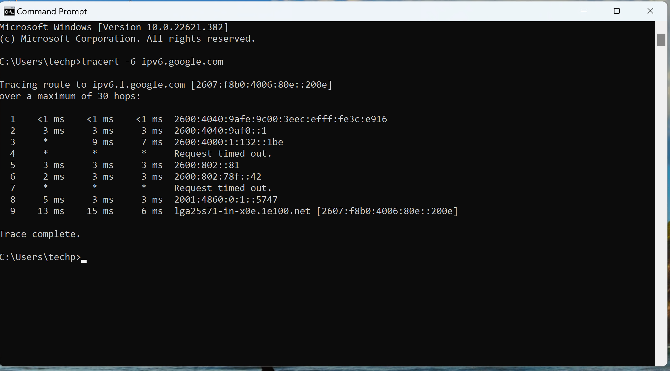

                        • T Offline
                          techpro2004
                          tracert results
                          bad
                          good
                          same network.

                                  johnpoz LAYER 8 Global Moderator @techpro2004
                                  @techpro2004 said in odd ipv6 routing issue:
                                  not sure why it did not show up.
                                  Because from the trace you show that it can not talk to the gateway, has no mac address for what it thinks it gateway is. So it can not send a ping without anyplace to send it.
