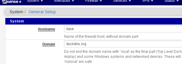

      I have pfsense 2.6.0 -Release with ACME installed, and use DuckDNS. I have created an SSL cert and use it on the webgui -- let's call that host dave.duckdns.org. In System:Advanced:Admin Access I have added dave.duckdns.org to Alternate Hostnames. When I point my inside-the-firewall browser at https://dave.duckdns.org it all renders nicely and works with SSL. In reality the LAN ip address for the pfsense is 10.3.2.1, and if I try to browse to https://10.3.2.1 I get a not-secure HTTPS warning that the certificate is not valid.

        The very first thing the local DNS knows about is this :
        so when your browser asks : who is dave.duckdns.org, then the answer comes back right away : it's me : 10.3.2.1 - so now the browser knows where to connect to.
