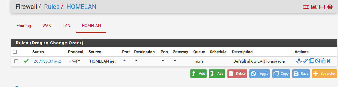

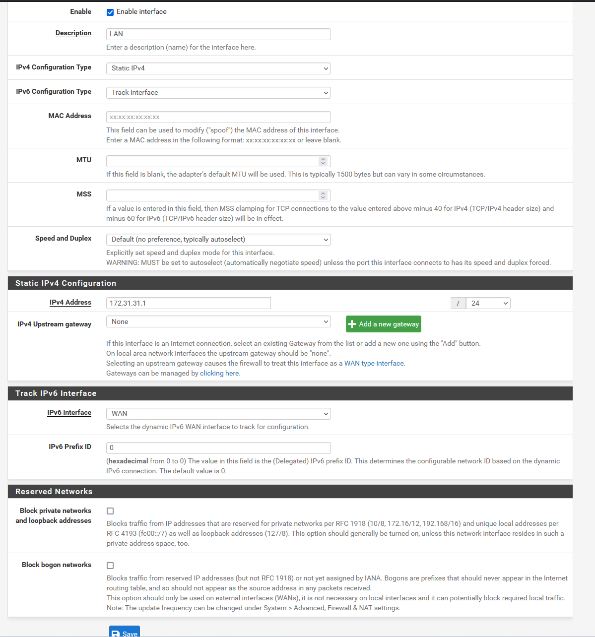

      im new to pfsense i've been banging my head for couple hours into this i just cannot figure it out please help!
      i am trying to have 2 interface , and i want both to be able to talk to each other.
      LAN
      172.31.31./24
      HOMELAN
      10.10.10.1/24
      from both lan i can reach internet / pfsense web page, but cannot reach each other
      PC on LAN 172.31.31.10
      PC on HOMELAN 10.10.10.2
      no ping goes trough....
      here is i think the relaated settings you could use to help me ?
      thank you

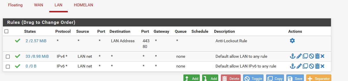

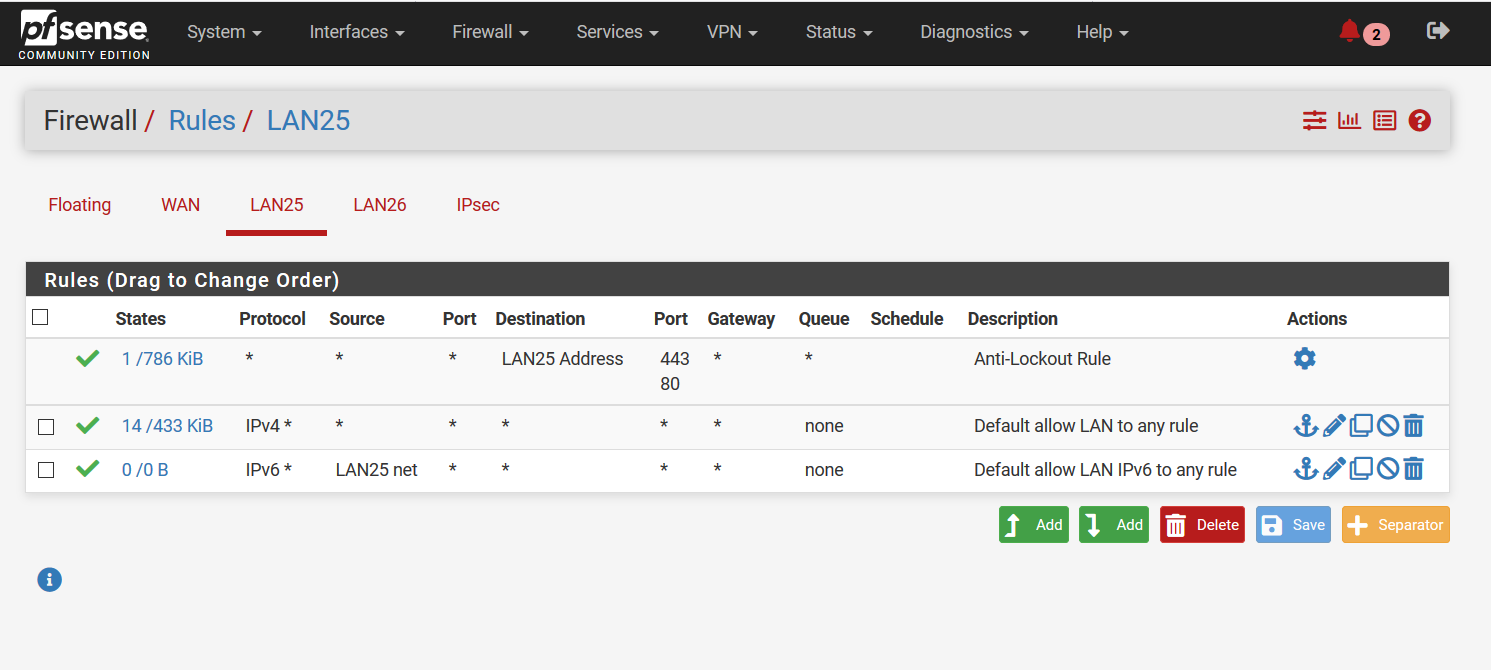

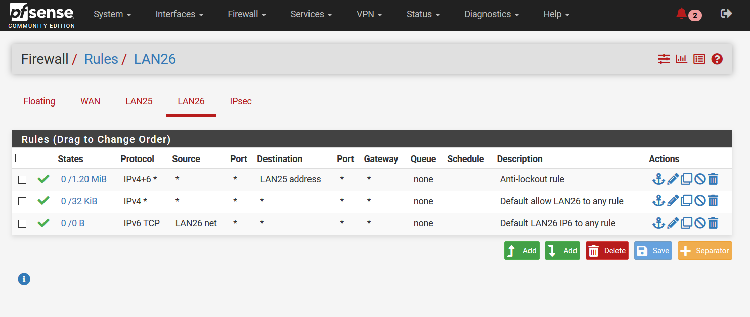

                I have a very similar problem. Configuration: pfsense is VM in Windows Server 2012R2. Just turned off Windows firewall as suggested above but it did not have any effect.
                Pfsense configuration: 1 WAN and 2 LAN ports. Each LAN port can access the WAN, and the internal machines - the server at 25.250 and pfsense gui at 25.1. But I can't ping from a laptop at 25.11 to another laptop at 26.17 or vice-versa.
                Here are the firewall rules
                Looking for suggestions as I've tried everything I've found in these posts.
                J SteveITSS 2 Replies Last reply Reply Quote 0
                  Jarhead @ofcoit
                  @ofcoit Delete the top rule on LAN26.
                  O 1 Reply Last reply Reply Quote 1
                  • O Offline
                    ofcoit @Jarhead
                    @jarhead
                    Change made. What worked still works. What doesn't work still doesn't work.

                            • SteveITSS Offline
                              SteveITS Rebel Alliance @ofcoit
                              @ofcoit said in interface cannot ping lan to opt5:
                              Just to be clear, you did that on the Hyper-V host or on the workstations? The workstations may disallow traffic from outside their subnet.
                              On LAN26 your "default" IPv6 rule only allows TCP not ICMP or UDP.

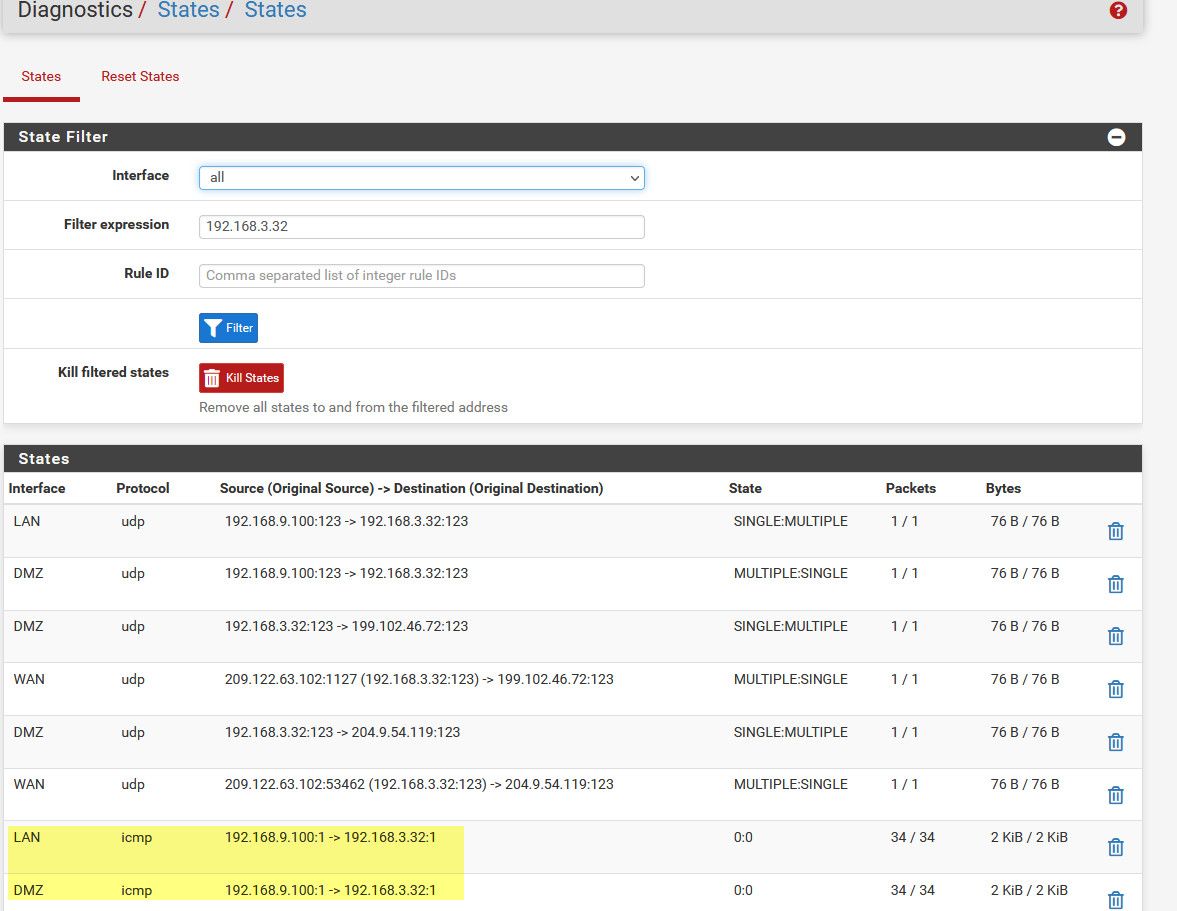

                                johnpoz LAYER 8 Global Moderator @ofcoit
                                It's like pfsense isn't routing at all between the two
                                Pfsense auto has routes for any network its directly attached to.
                                If you can not ping a device on either of those networks from the other network - and your rules allow, which yours show they do. Do you have any rules in floating?
                                It screams firewall or wrong mask, or wrong gateway on the device your pinging. Or pfsense doesn't know the mac of the device your trying to ping in the other network.

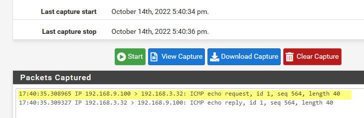

                                If you want to validate to yourself that pfsense is sending the traffic. Sniff (packet capture under diagnostic) on say vlan26 interface while you ping from vlan25 device. If the vlan25 device sent the ping pfsense, then you would see pfsense sending on the packets on the vlan26 interface.
                                You would also see state created. So example get a constant ping going to an IP on vlan26 from 25..
                                So I Ping 192.168.3.32 from 192.168.9.100
                                Here is the states..
                                Here is sniff on my dmz interface for icmp and 192.168.3.32 as the host, you can see request going out, and in my case you see an answer.
                                If you see the request go out and no answer - then the something is downstream of pfsense, most likely the host firewall, or it has a wrong mask, and doesn't think it needs to send the answer back to pfsense.

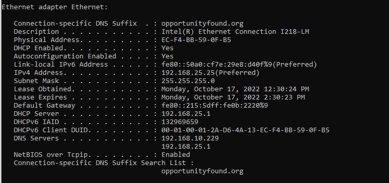

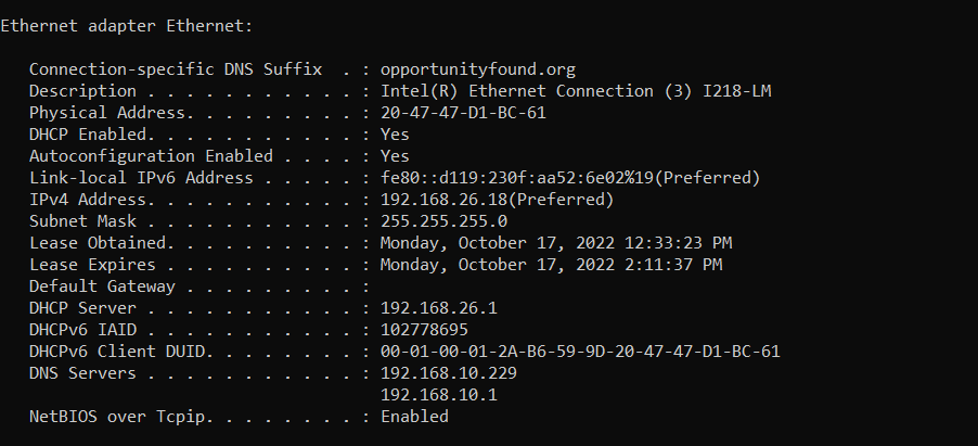

                                  3. Something changed over the weekend - not sure what because now the LAN26 (note these are not VLANs, just LAN ports where each port is assigned a different subnet .25 and .26. ) cannot ping 25.1 nor 25.250/
                                  4. Looking at the ipconfig info, I see that 25 has a Default Gateway fe80::215.... and 26 does not have a default gateway. I don't have detailed records from last week to see if that's what changed or not. Seems to be a problem.
                                    4a. Swapped LAN cables on laptops in case laptop configuration was an issue. Only thing that changed is I got two new local addresses 25.25 and 26.18.
                                  5. The difference in the interface configurations between LAN25 and LAN26 is in IPV6 Configuration Type. LAN25 is set to "Track Interface" while LAN26 is "None". If I try to make LAN25 "None" I get an error saying that the DHCP6 Server is active on this interface.... The Router Advertisements Server is active on this interface and it can be used only with a static IPV6 configuration.

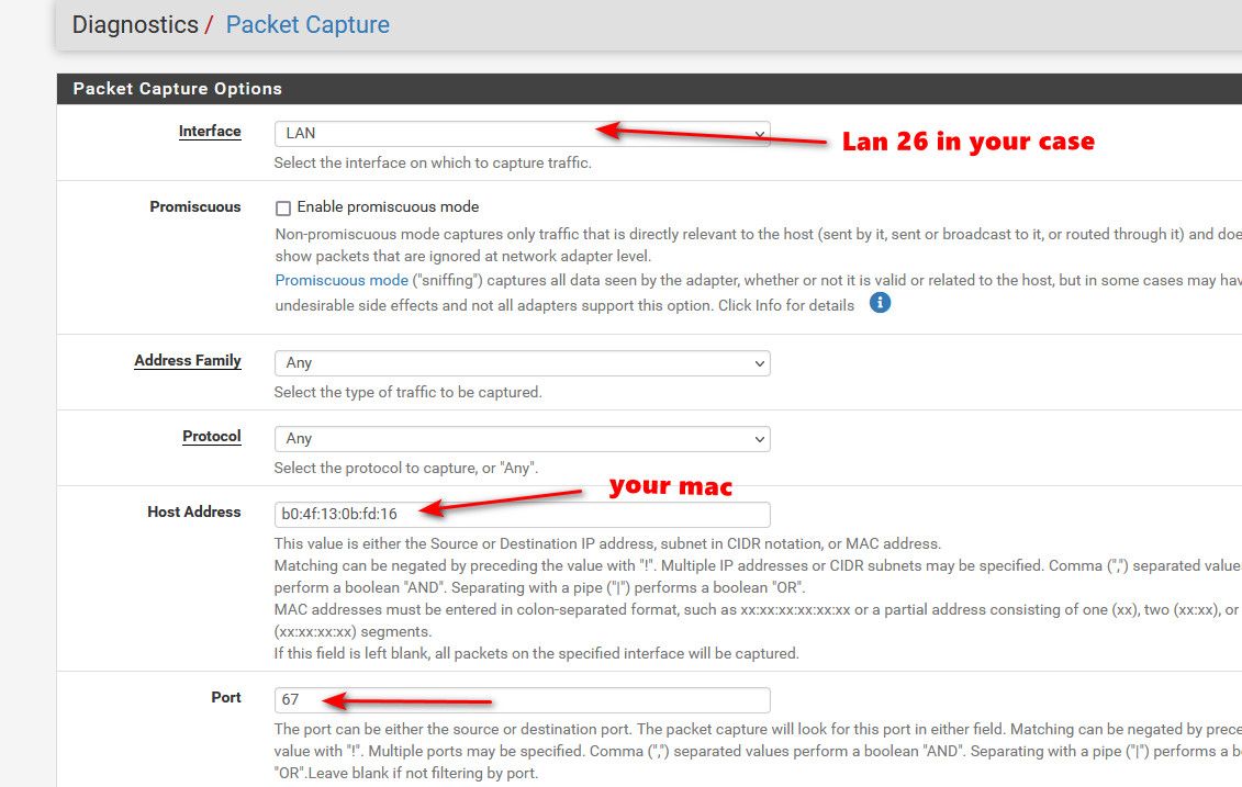

                                  6. I tried to use the Diagnostics as proposed above but saw nothing on LAN26. Verified I was using it properly by capturing traffic from 25.25 to 25.250 using constant ping.
                                    if you don't have a IPv4 gateway, how would you get anywhere? Other then local network - maybe you have a dhcp issue, or just connectivity issue.

                                      I appreciate you replying. To be clear let me go over what happens.
                                      1. 25.25 laptop can successfully ping 25.1 and 25.250 (the server). I run the gui from a web browser on 25.25
                                      2. 25.25 pings 26.18 and gets: PING: transmit failed. General failure.
                                      3. 26.18 laptop pings 26.1 successfully
                                        4 26.18 pings 25. and gets: PING: transmit failed. General failure.
                                      4. Ping diagnostic in GUI to 26.18 fails
                                      5. Ping diagnostic in GUI to 25.250 succeeds.
                                      How do I set up a ipv4 gateway for LAN26? Do I have to add a gateway in System/Routing/Gateways. I didn't have this set up last week and 26 could get to 25.1 and 25.250 but not today. Where does that gateway get set up?
                                        that would be correct if you have no gateway..
                                        So if I try and ping something on a different network with an interface that has no gateway. My 192.168.10.9 interface is a SAN connection only between my PC and NAS, so there are no gateways on these interfaces.
                                        If I try and ping something off that network.
                                        $ ping -S 192.168.10.9 8.8.8.8
                                        Pinging 8.8.8.8 from 192.168.10.9 with 32 bytes of data:

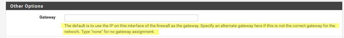

                                        Your interfaces on pfsense lan25 and lan26 should not have gateways set.. If you set a gateway on pfsense interface, then it considers it a "wan" interface - ie a connection that can be used to get to other networks.

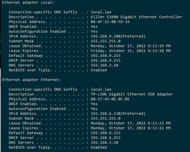

                                        So for example.. Here is my pc.. on my lan..
                                        $ ipconfig /all
                                        Windows IP Configuration
                                           Host Name . . . . . . . . . . . . : i9-win
                                           Primary Dns Suffix  . . . . . . . : local.lan
                                           Node Type . . . . . . . . . . . . : Broadcast
                                           IP Routing Enabled. . . . . . . . : No
                                           WINS Proxy Enabled. . . . . . . . : No
                                           DNS Suffix Search List. . . . . . : local.lan
                                        Ethernet adapter Local:
                                           Connection-specific DNS Suffix  . :
                                           Description . . . . . . . . . . . : Killer E2600 Gigabit Ethernet Controller
                                           Physical Address. . . . . . . . . : B0-4F-13-0B-FD-16
                                           DHCP Enabled. . . . . . . . . . . : No
                                           Autoconfiguration Enabled . . . . : Yes
                                           IPv4 Address. . . . . . . . . . . : 192.168.9.100(Preferred)
                                           Subnet Mask . . . . . . . . . . . : 255.255.255.0
                                           Default Gateway . . . . . . . . . : 192.168.9.253
                                           DNS Servers . . . . . . . . . . . : 192.168.3.10
                                           NetBIOS over Tcpip. . . . . . . . : Enabled
                                        Ethernet adapter Nas-San:
                                           Description . . . . . . . . . . . : Realtek USB 2.5GbE Family Controller
                                           Physical Address. . . . . . . . . : A0-CE-C8-CC-57-DE
                                           IPv4 Address. . . . . . . . . . . : 192.168.10.9(Preferred)
                                           NetBIOS over Tcpip. . . . . . . . : Disabled
                                        So devices on your 25 network would point to pfsense 25.1 address, and devices on your 26 would point to pfsense 26.1 address as their gateway.
                                        If your manually setting the IPs on your devices, you have to set a gateway if you want them to get to anything off their local network. If they are getting their IPs from dhcp, then that should auto hand out the gateway to the dhcp clients.

                                          So where does LAN26 get it's gateway set.? The LAN adapter settings are the same between the laptops and the behavior follows the LAN connection. First lan26 with no gateway Screenshot LAN26 ipconfig.png
                                          Second lan25 with gateway.
                                          Is the LAN26 adapter not sending out the information? It's a dual-LAN card, so the driver, etc should be the same.
                                            I think you're asking how to set that on a PC on LAN26 but that's a confusing way to ask that...it sounds like you're trying to set a gateway on pfSense's LAN26 interface. There is no gateway set on the pfSense interface. If 192.168.26.1 is your pfSense (?) then since that's the DHCP server it should be providing itself as the gateway. On the DHCP Server tab for LAN26 the "Gateway" should be blank. Alternately you could give the PC a static IP/gateway.
                                            With no gateway set, the PC has no idea where to send packets for 192.168.26.1. Or for the DNS server 192.168.10.229 for that matter.
