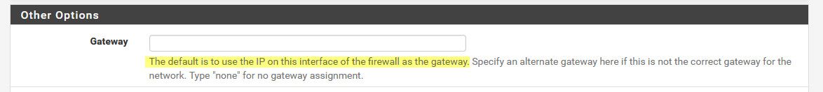

              I don't think I have ever on a windows machine, or any machine for that matter ever tried pulling dhcp from 2 different networks on the same machine. That is not a good idea really to be honest, I sure hope your just trying to do this for a test? Multi-homing can be very problematic and lead to asymmetrical routing, etc..
              It could be windows saying hey I already have a default gateway, and not setting it on the other interface..
              Both LAN25 and LAN26 have the ipv4 upstream gateway to None
              But not in the dhcp server settings like I posted.. That should just be left blank and it would hand out its address as the gateway to dhcp clients.

                                        @ofcoit said in interface cannot ping lan to opt5:
                                        set 25.1 and 26.1 as the gateways in the Services/DHCP
                                        that is the default, dhcp server would hand out the IP address of pfsense that your running dhcp server on.
                                        O 1 Reply Last reply Reply Quote 0
                                        • O Offline
                                          ofcoit @johnpoz
                                          @johnpoz I know it's the default but it wasn't working until we typed them in
                                          • johnpozJ Online
                                            johnpoz LAYER 8 Global Moderator @ofcoit
                                            @ofcoit Well you got something else wrong then.. Did you do the sniff like I asked? If you remove them does it still fail?
                                            You can look at the actual conf file.
                                            cat /var/dhcpd/etc/dhcpd.conf
                                            This conf file is generated, if its not showing your interface IP in their for option routers then something is wrong. Did you maybe have a space or something in that field?
