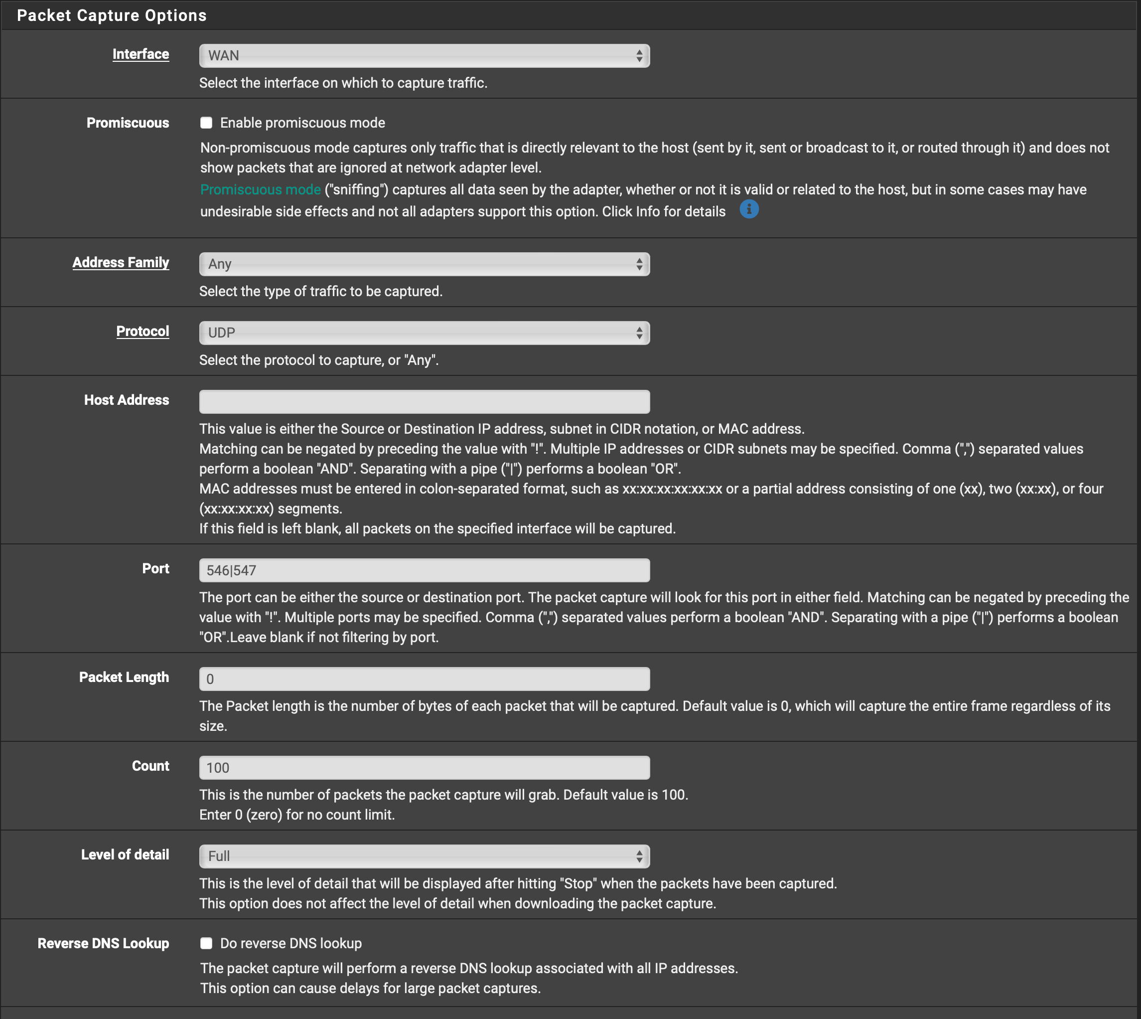

              This is the setting I used to do the package capture
              JKnottJ 1 Reply Last reply
              Reply Quote 0
              • JKnottJ
                JKnott @samleemc
                @samleemc
                In that capture, I see the solicits going out, but nothing coming back.
                This would indicate a DHCPv6 problem at your ISP.

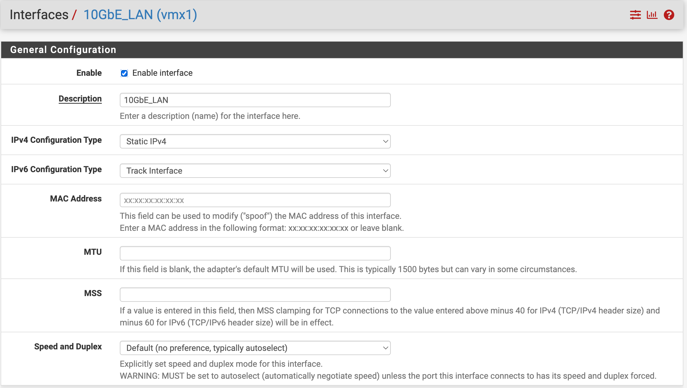

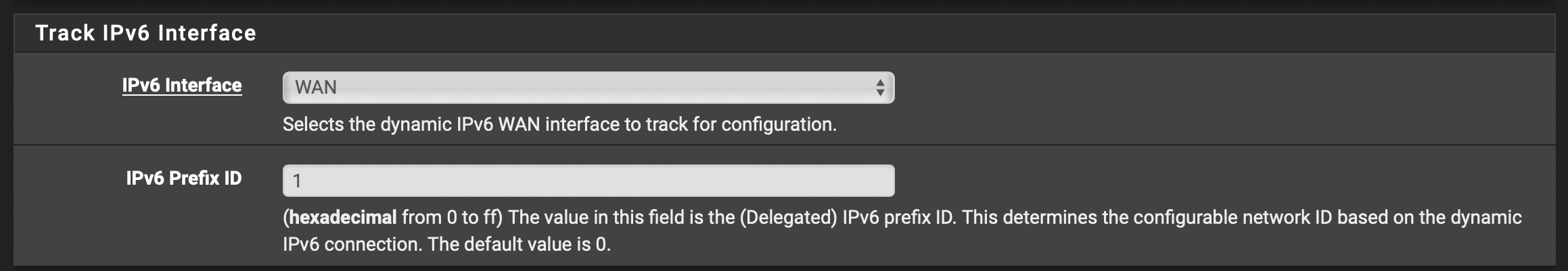

                                        Those are my setting related to IPv6

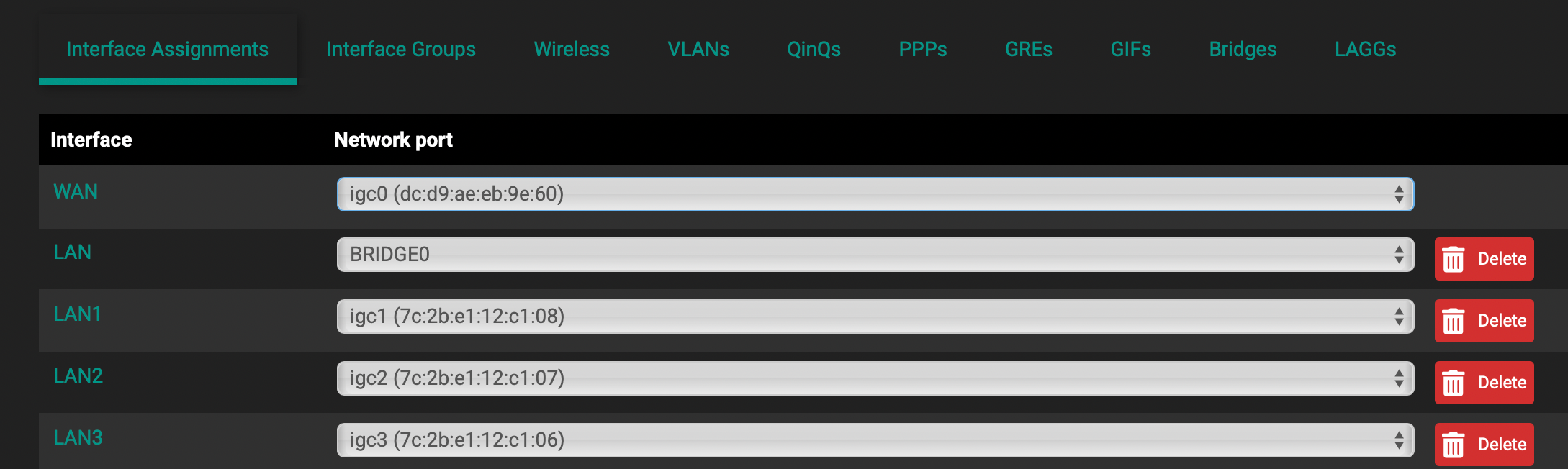

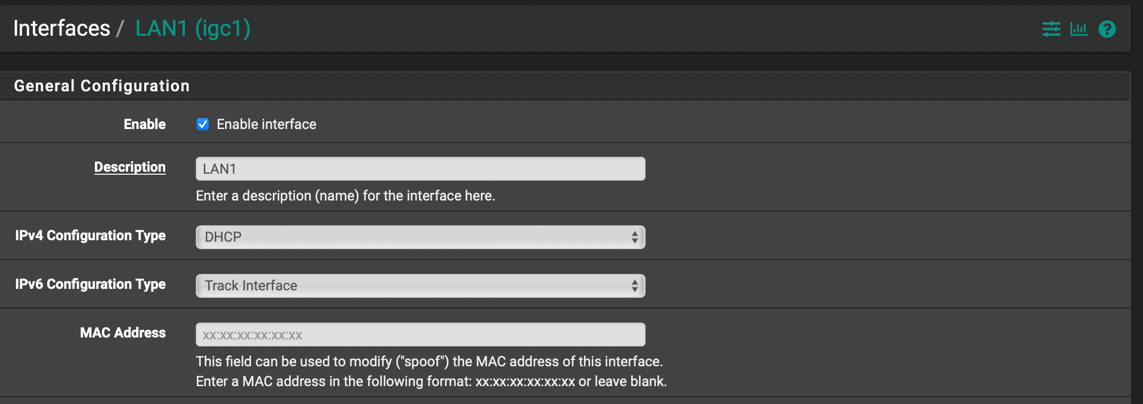

                                        I have 3 physical LAN ports in the machine, and I have setup a bridge "LAN" to join them together as below
                                        Then each LAN is set to track the WAN interface for IPv6
                                        All LAN are pretty much the same.

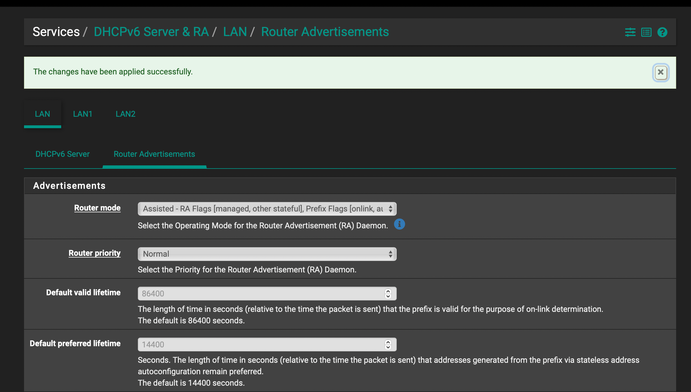

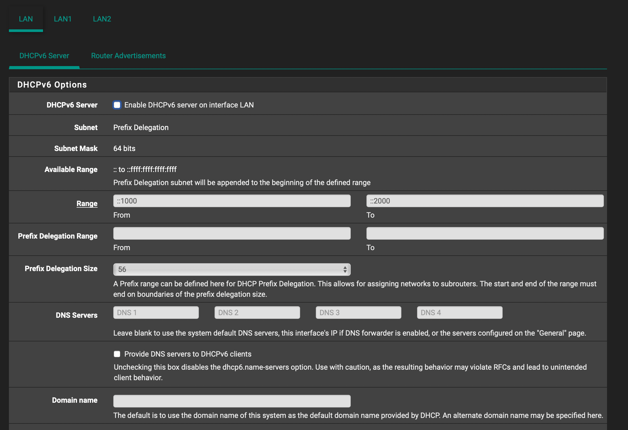

                                        As for the DHCPv6 and RA, I have turned off the DHCPv6 and enable RA as below
                                        I think that's pretty much all the setting related to IPv6.
                                        Any difference from yours?
                                        Sam
                                        S 1 Reply Last reply
                                        Reply Quote 0

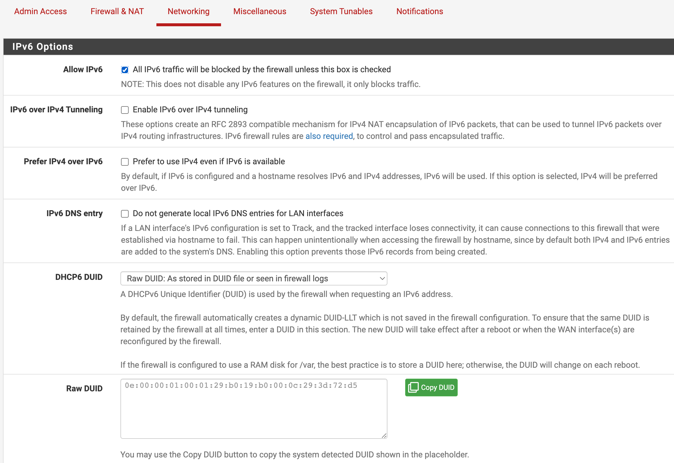

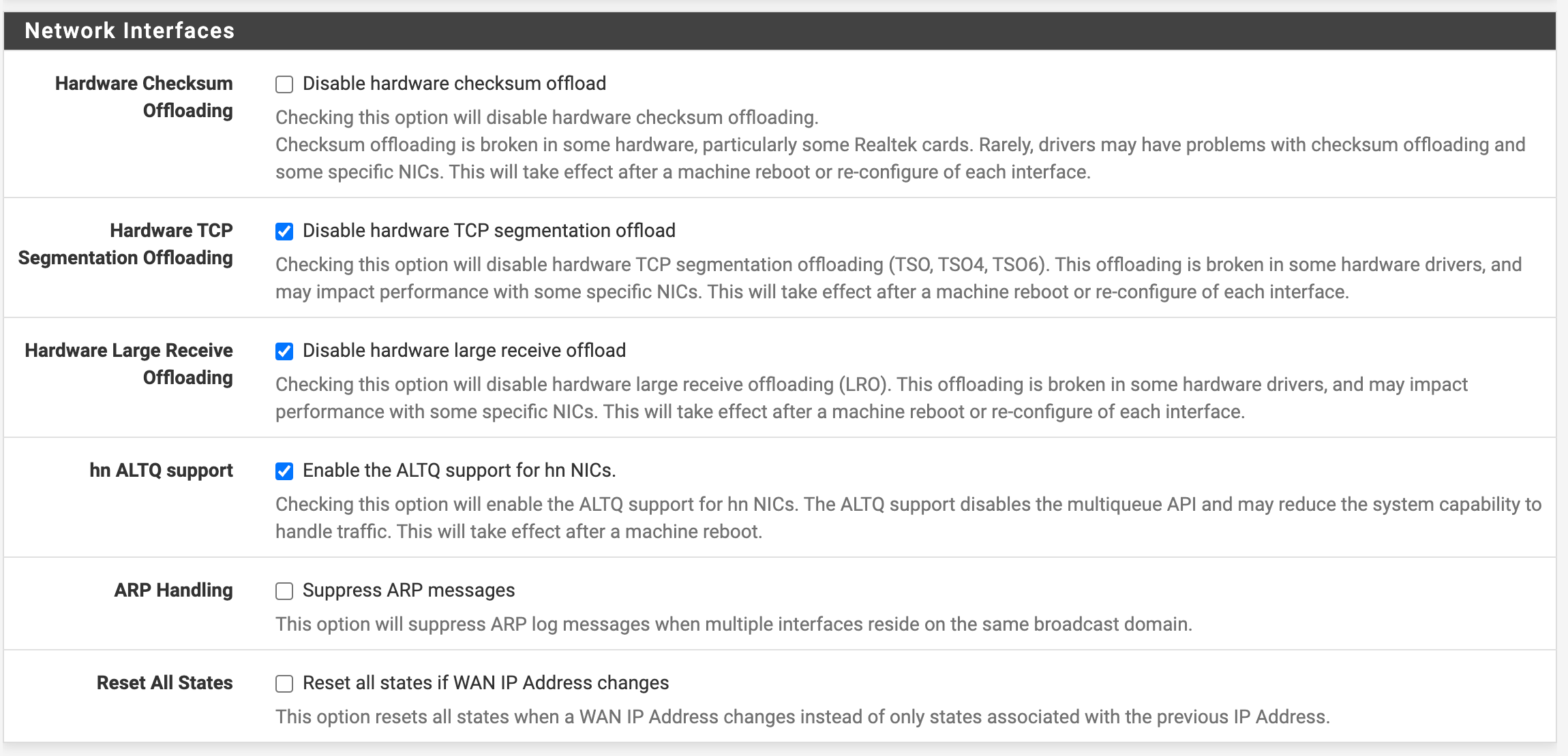

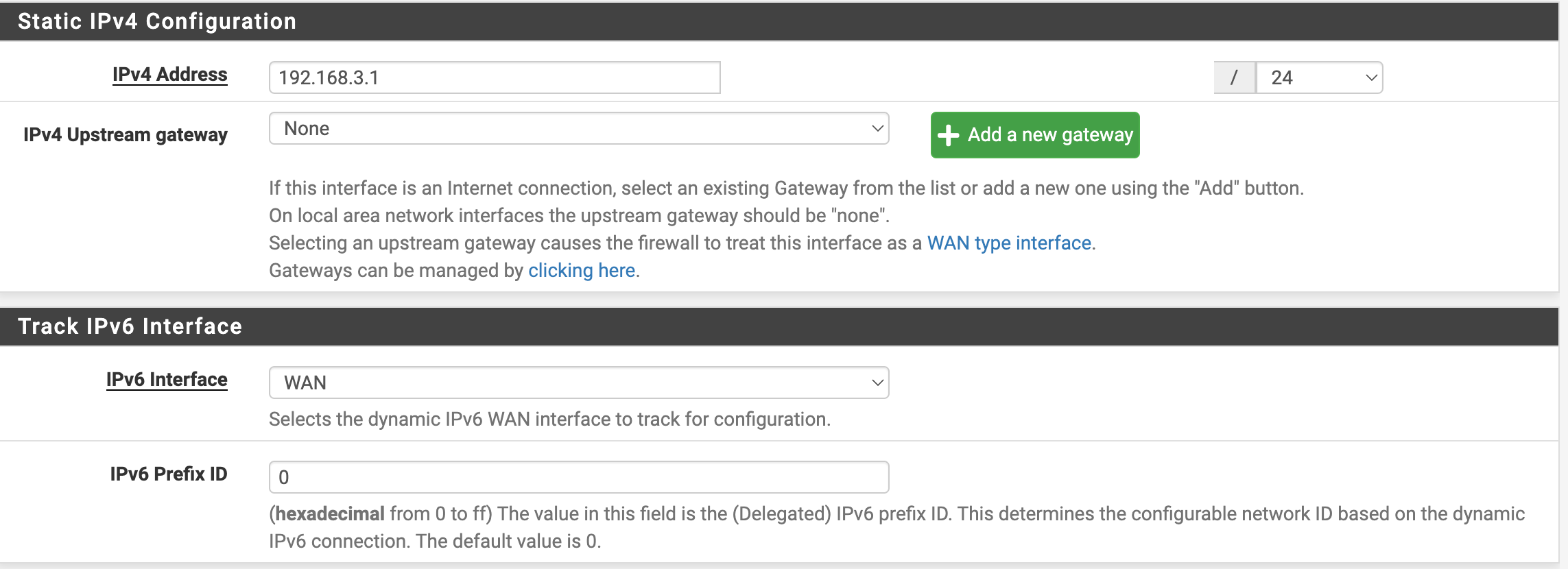

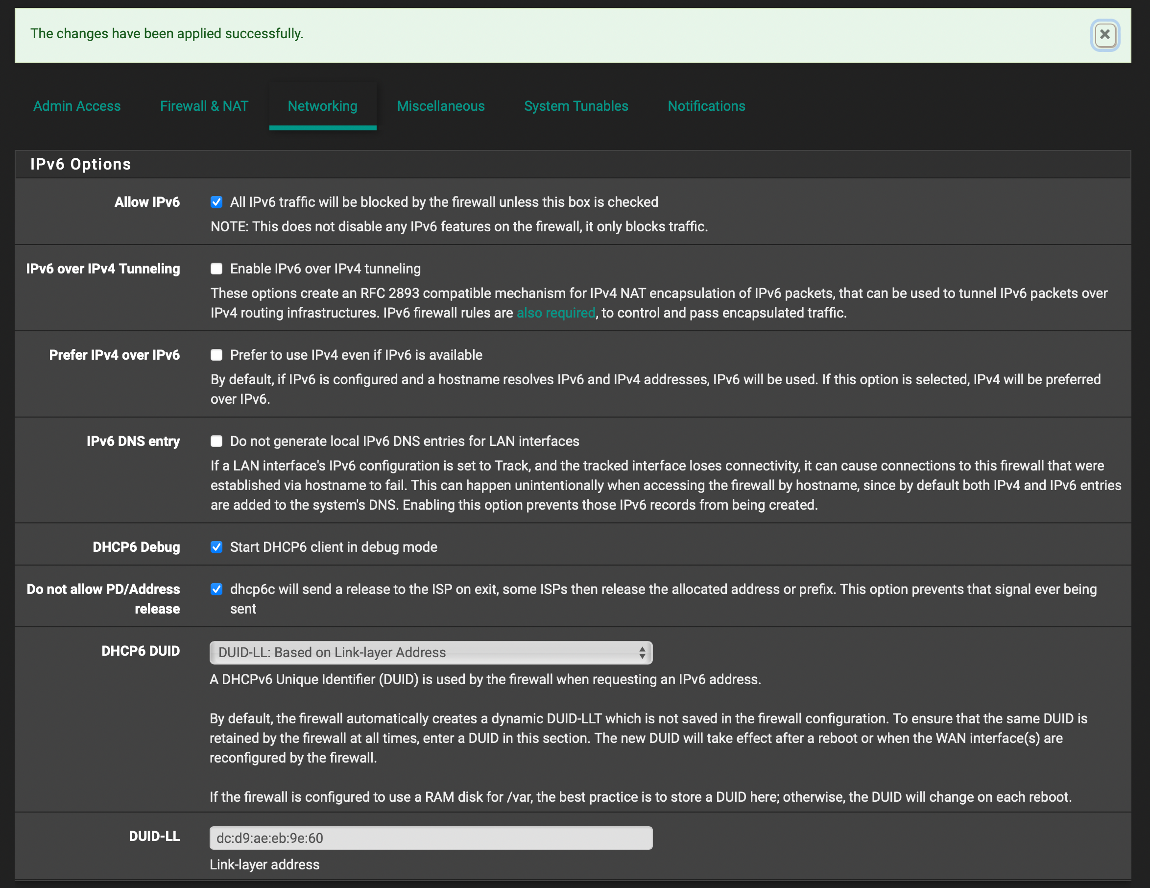

                                            Your LANs are on the bridge, and the IPv6 configuration type is "track interface." This is the best setting, so DCHPv6 automatically assigns the client's network, but I can see some tweaking is required on your end.
                                            As you can see, I did not configure MAC spoofing!
                                            If the below settings don't work, I would tell you to start from scratch and use one LAN without bridging the LANs to see if works.
                                            My pfSense version: 2.6.0-RELEASE (amd64)

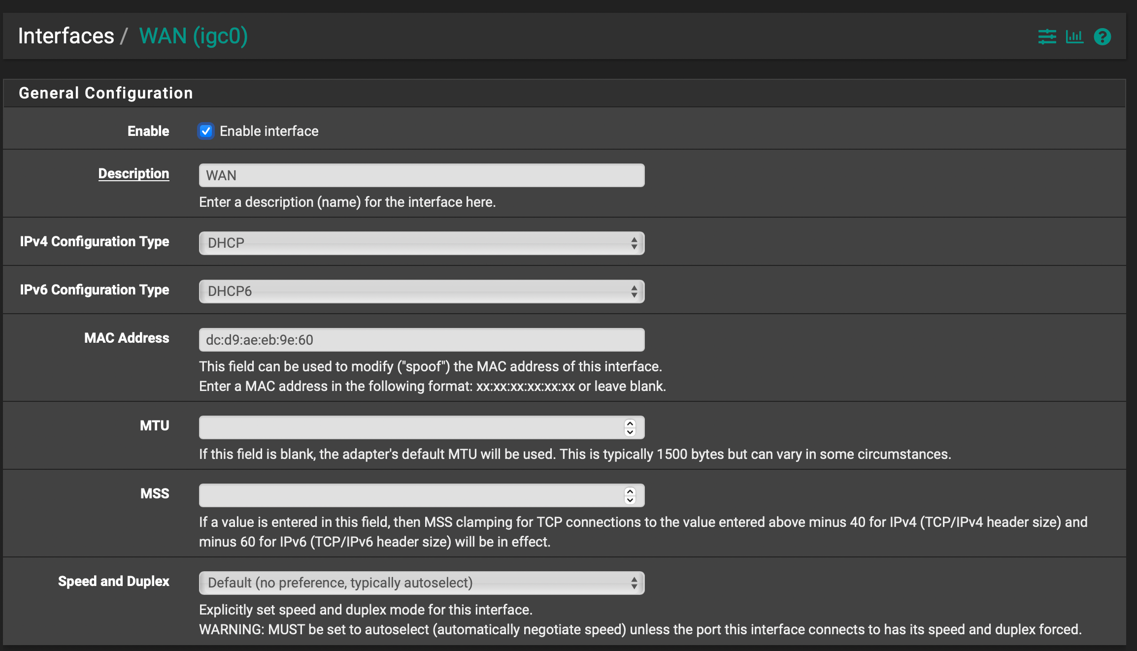

                                            WAN:

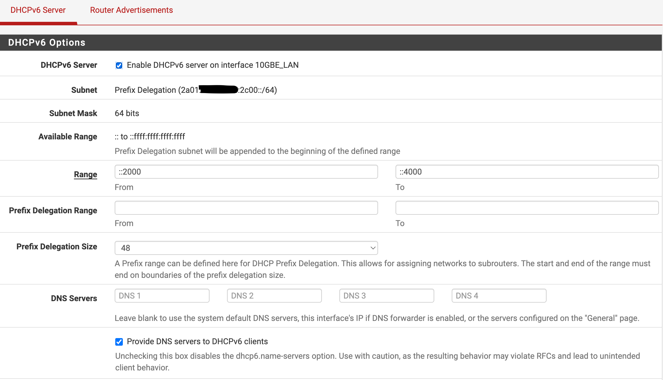

                                            DCHPv6:

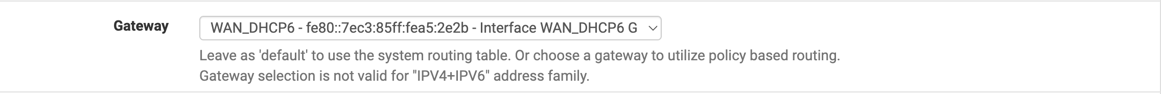

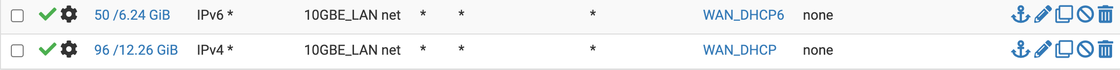

                                            Rules tab:
                                            This rule is for the LAN and includes an HO IPv6 gateway, so traffic will be routed through the HO gateway.

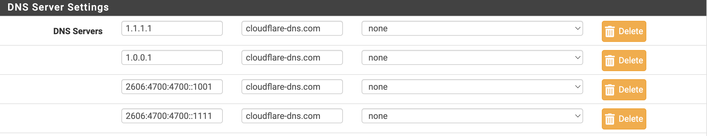

                                            DNS:
                                            The DNS is also important for the HO connection. you can setup Hyperoptic DNS however, i have setup Cloudflare:

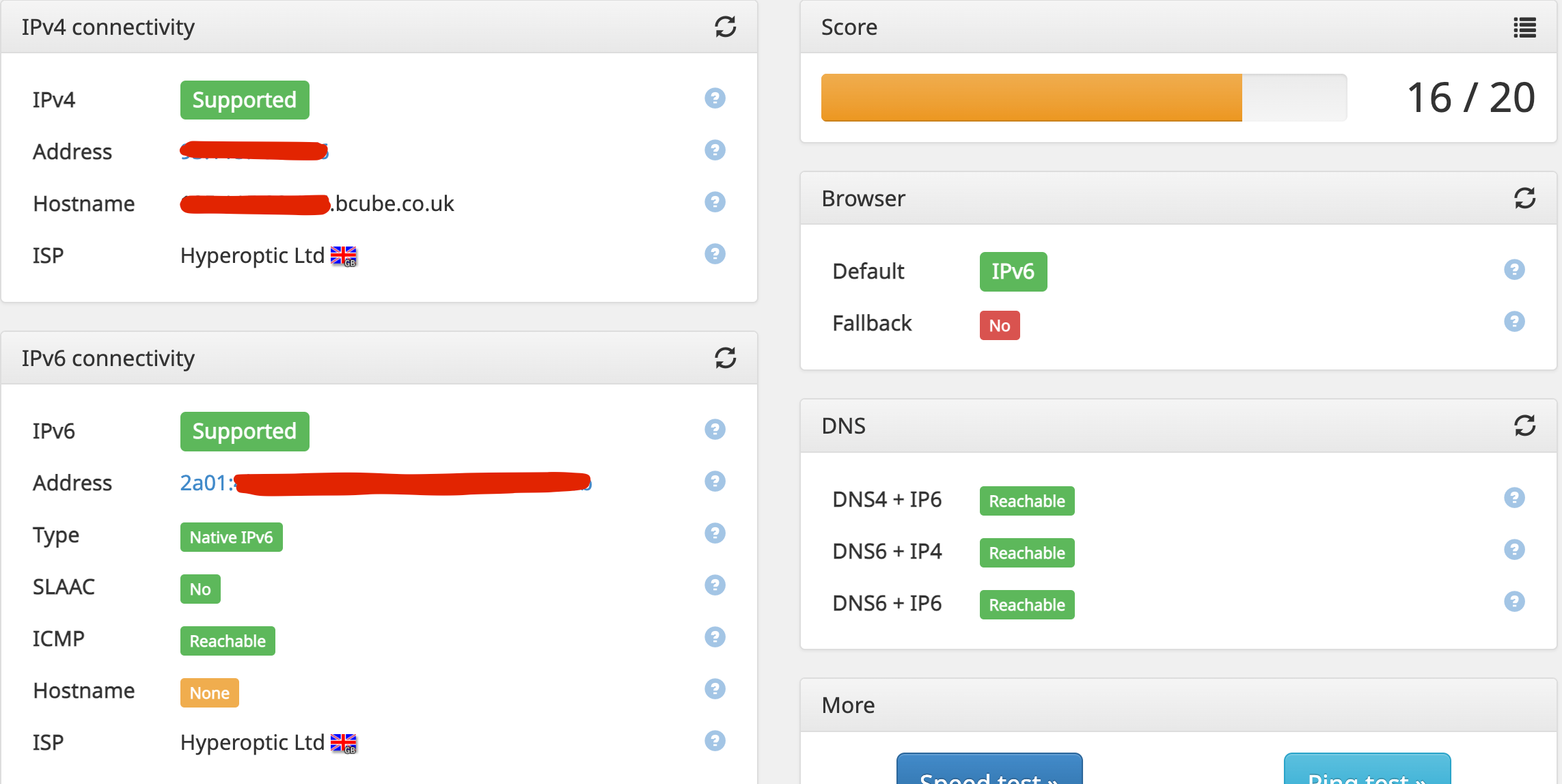

                                            HyperOptic Gateway up and running:
