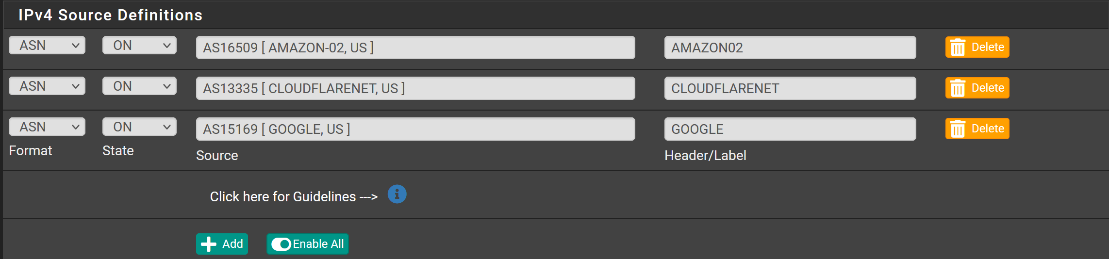

      I have an IPv4 list which contains a list of ASN which are being retrieved and enumerated properly. It's marked as Alias Native.
      But in that list of ASNs I have a custom CIDR list in the same rule in the section at the bottom in the "IPv4 Custom_List" area containing a list of CIDR networks, one per line.
      It seems that the custom addresses are not being added to the Alias. I've had to create a new rule just with the IPv4 Custom_List and then have two f/w rules on the same i/f.
      Am I doing it wrong? Should I be able to do this in one Alias list?
      SG-3100 26.03-RELEASE (arm) | Avahi (2.2_10) | iperf (3.0.6) | nmap (1.4.4_11) | ntopng (6.2.0) | openvpn-client-export (1.9.13) | pfBlockerNG-devel (3.2.16) | sudo (0.3.4) | System_Patches (2.3.3)
      • lohphatL Offline
        lohphat
        Here I list 3 ASNs:
        Then I add manual CIDRs to the custom section:
        But in the resulting Alias file the custom CIDRs are NOT there:

          johnpoz LAYER 8 Global Moderator @lohphat
          @lohphat I just duplicated what you showed and not having any issues. Did you actually enable the list?
          Did you look at the right table under diagnostics?
          lohphatL 1 Reply Last reply Reply Quote 0
