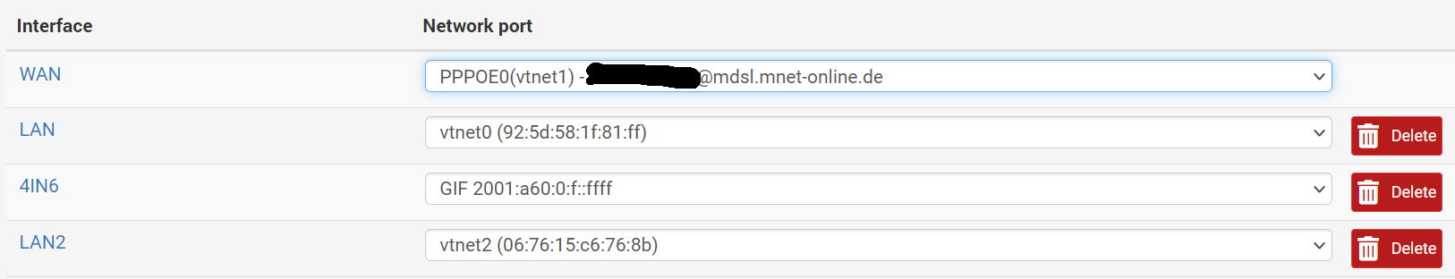

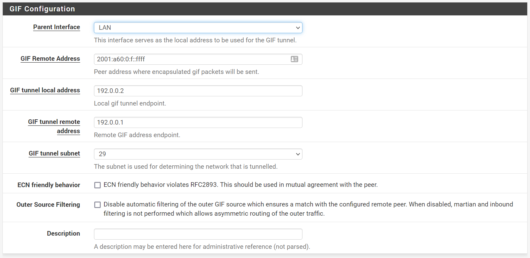

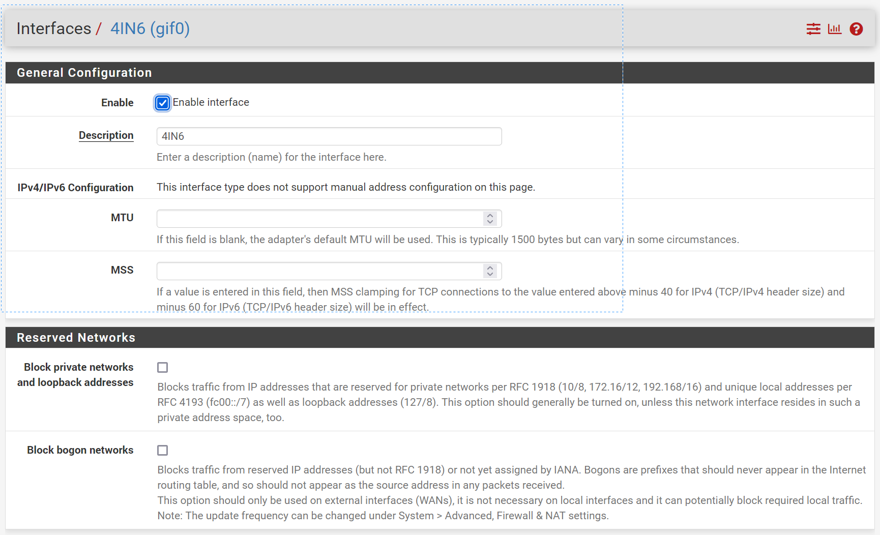

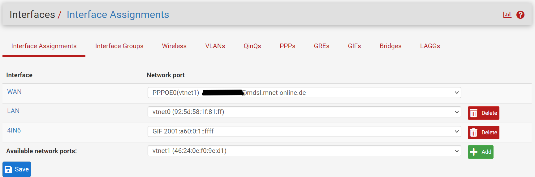

          This is the current configuration I have on that interface:
          Kind regards

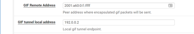

            Gertjan @vex
            @vex
            This looks strange (to me) :
            and
            A GIF tunnels IPv6 over a IPv4 link.
            The GIF Remote address should be IPv4 - not IPv6.
            A tunnel can't have a IPv4 on one side, and a IPv6 on the other ....
            Or are you tunnelling IPv4 over a IPv6 ?

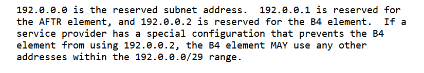

                • V Offline
                  vex @Gertjan
                  @gertjan What I do seems to be standard for Dual-Stack-Lite setups RFC8585. This tunnels IPv4 packets in an IPv6 connection to an CG-NAT or AFTR element, which in turn unpacks the precious IPv4 contents.
                  The tunneling addresses and netmasks are defined in RFC6333.
                  My AFTR address is equal to the GIF Remote Address.
                  As I've mentioned earlier in my post: everything is working perfectly after I a click into the gif0 Interface, click "Save" and "Apply changes" (although I haven't changed anything in the interface). My only problem is that the connection does not come up automatically after a reboot of pfSense.

                      • V Offline
                        vex
                        I wanted and I tried to set WAN as parent because it’s only logical, but that‘s barking at me with an error (creating interface). I can only set a LAN as parent during creation. But yeah, that‘s explaining the issue. Changing the parent after creating the gif is also not possible.
                          Mmm, appears to be the rather unhelpful:
                          The following input errors were detected:
                              Error occurred creating interface, please retry.
                          Let me test....
                          • V Offline
                            vex @stephenw10
                            @stephenw10 Exactly this error.. :)
                              Ok, that error is shown if the PPPoE interface is not up at the time. It wasn't on my test box. But I can create a GIF tunnel on a PPPoE interface as long as it's connected and has an IP at that time. And it does then re-establish at boot.
                              However I tested here with IPv4, it's possible it will refuse to allow a tunnel with a remote IPv6 address even if the PPPoE interface has one. I assume that's the situation you're in?
                              It's possible your ISP only provides a prefix and the WAN doesn't get a routable v6 IP.
                              Also I'm testing between local machines which mean the PPP connection estblishes almost instantly at boot so it's possible there is a timing issue. I don't think that is the case though because the GIF tunnel doesn't attempt to establish until the PPPoE is up because it's parent interface is down. The way you have it setup LAN appears to be up to it tries and fails.
                              What does appear to be a possible bug is that the LAN interface gets a new IP address when the PPPoE comes up and it can track the prefix. But that doesn't trigger the GIF tunnel to restart.
                              However there are a number of features missing from dynamic IPv6. This is probably one of them.
                              Anyway I would retry to create the GIF on WAN directly. At least that might give us a different error. I can't easily test an IPv6 PPPoE connection here.

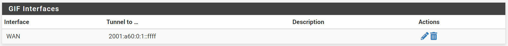

                                • V Offline
                                  vex @stephenw10
                                  @stephenw10 I managed to create a second gif while the first one was still down. Setting the parent interface to WAN worked this way.
                                  Unfortunately, the interface still doesn't come up during boot and even more unfortunate is that the IPv4 routing does not work if I use WAN as parent interface. It shows as up, but the tunnel does not work.

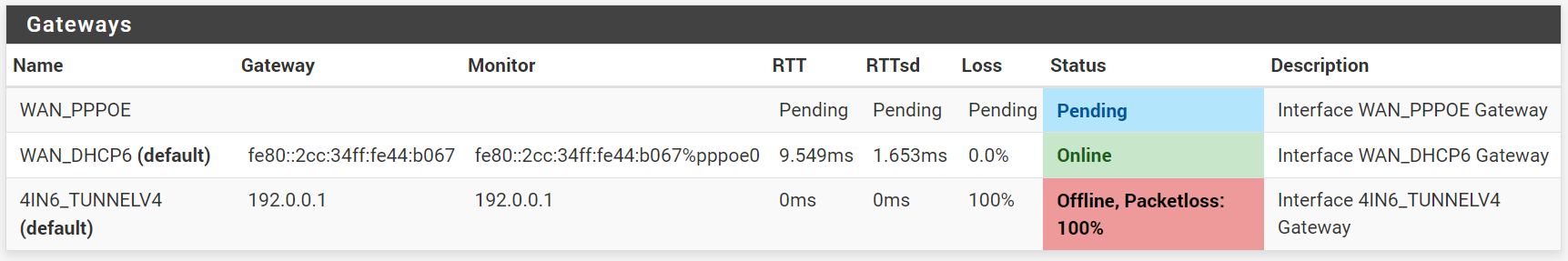

                                      What I find slightly interesting, is that the IPv4 tunnel gateway has 100% packet loss in the gateway monitor, although it works flawlessly.

                                        @vex said in gif0 does not come up after reboot:
                                        Oct 22 20:19:13 php 458 rc.bootup: The command '/sbin/ifconfig 'gif0' description '4IN6'' returned exit code '1', the output was 'ifconfig: interface gif0 does not exist'
                                        Oct 22 20:19:13 kernel vtnet0: link state changed to UP
                                        That's with the gif tunnel using WAN as the parent? Or LAN still?
                                        Is the PPPoE interface first in the list?
                                        I note that you appear to have WAN set to dhcpv6 but the PPPoE is passing an IPv6 address via IPV6CP directly.
                                        The IPv4 gateway may simply not respond to ping. Try setting a monitoring IP somewhere further upstream like 8.8.8.8.
                                        • V Offline
                                          vex @stephenw10
                                          That's with the gif0 using LAN as parent. PPPoE is first in list, yes.
                                          So instead of using DHCPv6 as configuration type, should I use something else there?
                                          Yeah, I switched to monitoring the IPv6 CG-NAT/AFTR address.
                                          This is the complete log of booting with gif0 and WAN as parent:

                                          As I already mentioned: With this configuration the 4IN6 tunnel does not work.
                                          Thanks again for having a look into this.
