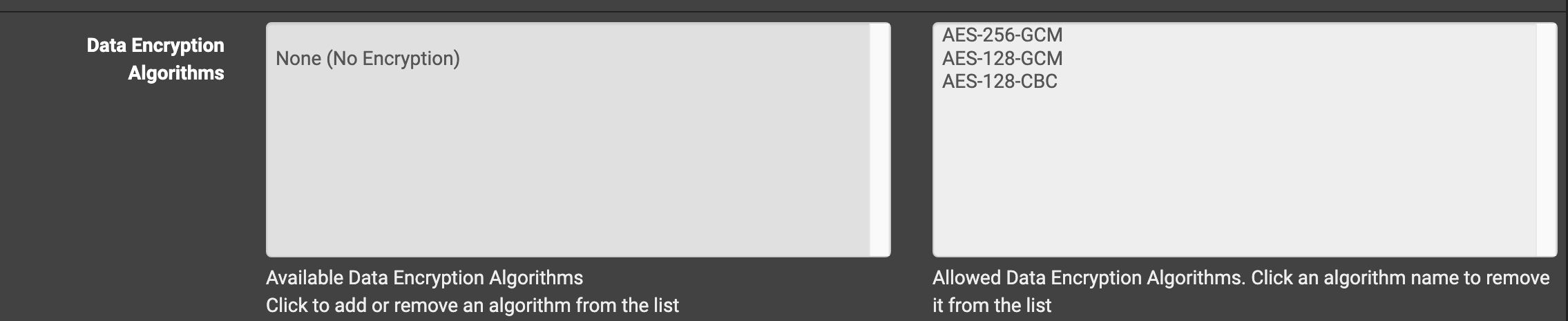

@gertjan It is very strange. There are no encryption algorithms in the Data Encryption Algorithms.
@n-lopyrev
Probably related.Is there a reason you are not using the latest version ?
