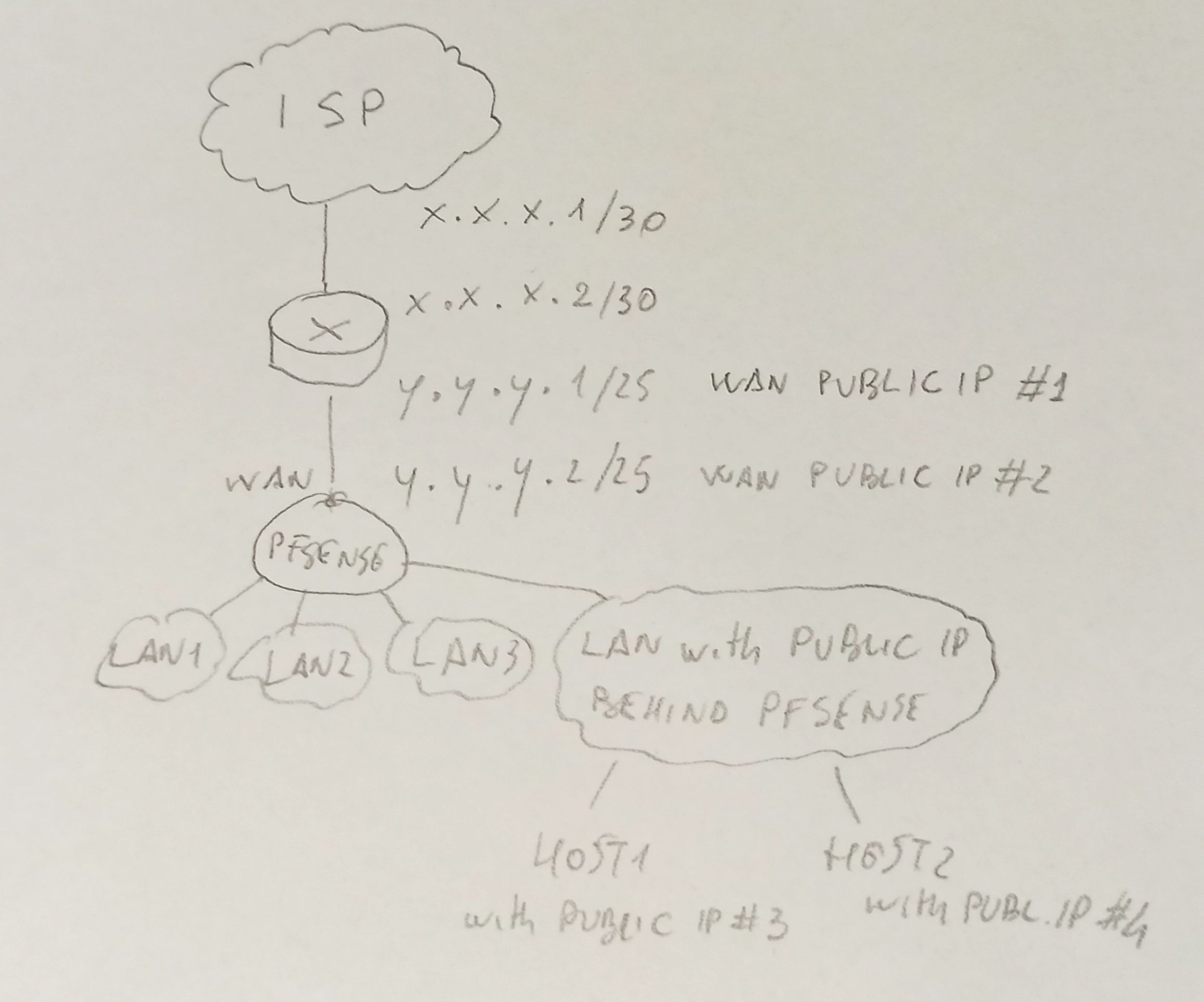

@viragomann @stephenw10 you can find in attachment a sketch describing the scenario I'm trying to create.
From the top to the bottom, you can see:
- the ISP, that is connected to our router with a point-to-point link;
- our router, that have 2 IP addresses (one IP address for the point-to-point link and the first (#1) public IP of the public subnet that ISP provided us)
- the pfsense router that acts as firewall (the second (#2) public IP has been assigned to the WAN interface of pfSense)
- the existing LANs
- the new LAN ("LAN with public IP behind the pfsense") that I created in order to group every hosts with the public IP.
I created the "LAN with public IP behind the pfsense" without doing anything else. So, I don't know if the LAN is a "routed" LAN; when a lan is defined "routed"? (sorry for my stupid question, but I'm a newbie...).
My ultimate goal is to protect hosts with IP address using existing firewall.
@stephenw10 this is definitely the answer I was looking for. the bridge and related limitations impact only the bridge itself.
So, the existing NAT rules, involving WAN and other LAN interfaces, are not involved.Many thanks,

@mauro-tridici
A routed subnet means, that the ISP routes the subnet to your primary WAN IP.
This is applicable to your WAN network y.y.y.0/25 for instance. This is routed to the WAN-side routers IP.If the "public LAN" was routed to your WAN IP it would be routed to the outer router IP as well. Additionally it would need to route on the ISP router to point it to the pfSense WAN IP.
Is the "public LAN" a separate subnet or are the IPs part of y.y.y.0/25?
If the latter case you can go with bridge WAN <> public LAN and you should be able to access the IPs inside from the internet without issues. Proper firewall rule on WAN presumed.
Otherwise it needs to be routed to your WAN IP by the ISP to use it behind pfSense. The configuration is well described in the docs: Routing Public IP Addresses. -
Yeah, it looks like you do have a routed subnet there, the /25 is routed to you over the /30.
But you can't use it as a routed subnet in pfSense because you have some other router upstream and the /25 is on the pfSense WAN directly.
In that situation you would have to bridge it to use the public IP on servers directly.A much better setup though would be to remove the upstream router so pfSense uses the /30 on it's WAN. Then you can use the /25 directly on an internal interface as a routed subnet.
That may not be possible/practical.Steve
@viragomann thank you very much for the detailed explanation. The "public LAN" is not a separate subnet and related IPs are part of y.y.y.0/25.
So, I can proceed with the bridge WAN <> public LAN.
