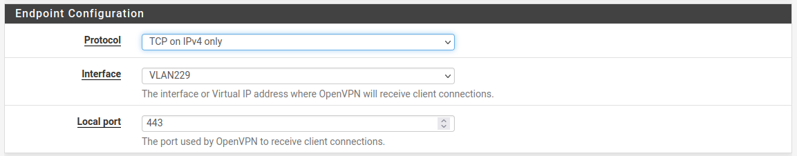

                                0.0.0.0 can also be a placeholder for 'all IPs'. If it can't bind to it is there something else already listening on port 443? HAProxy perhaps? One of the OpenVPN servers?
                                What does sockstat -l show?
                                  axxxxe @stephenw10
                                  @stephenw10 said in SG-3100 rebooting:
                                  sockstat -l
                                  [22.05-RELEASE][root@gateway.home.localdomain]/var/log: sockstat -l | grep 443
                                  root dpinger 87220 6 stream /var/run/dpinger_OVPN443_USER_VPNV4~10.200.1.1~10.200.1.1.sock
                                  root openvpn 90098 6 tcp4 84.73.89.100:443 :
                                  Yes, there is an OpenVPN server listening on 443. 84.73.89.100 is the WAN interface. Is it bad for me to have set it up this way?
                                    Gertjan @axxxxe
                                    @axxxxe said in SG-3100 rebooting:
                                    Is it bad
                                    Yes.
                                    A single server process can listen on a port. Ones started, another server can't use that port.
                                    You could use UDP as a protocol for you OpenVPN on port 443.
                                    As nginx, the pfSense web server, uses port 443 protocol TCP, this will be ok.
                                    Or move the pfSense web server GUI to another port, like 8080.
                                    Or just leave the OpenVPN on the default 1194 port.

                                      Ok, thanks for the helpful info. I find it bizarre that this config worked for years and only in the last 2 weeks suddenly broke the WebGUI.
                                      Two questions:
                                      How do I fix this from the console, at least so I can get in over the web interface and adjust the OVPN server settings?
                                      Does this explain the random rebooting of the unit?
                                        Gertjan @axxxxe
                                        You have the console access working ?
                                        Then easy : edit** the pfSense master config file /cf/conf/confiig.xml
                                        Locate the openvpn server settings, you'll see the port number "443", change that for "1234".
                                        Save.
                                        Reboot.
                                        All is well.
                                        There is a command that can help you :
                                        viconfig
                                        (if you know what 'vi' is 😊 )

                                            axxxxe @stephenw10
                                            Or you can use the 'Set interface(s) IP address' function from the menu. If you set one of the interfaces to the same address it already has it will ask if you wish to revert the webgui to http on port 80. You can then connect there and make other changes in the gui.
                                            I followed this route. Once in over the WebGUI I just deleted the OVPN server since I didn't actually need it anymore. After a reboot the system came up with far less complaining in the log. Fingers crossed that the issues is resolved.
                                            I have to say that it seems like a bug to me that one can break the system by listening on 443 on the WAN port. This didn't used to be the case. I've had that OVPN server configured to listen on 443 since at least January of 2018 and until recently there was no issue. Note that I only upgraded from 2.4.5 to 22.05 two months ago. Maybe this issue was introduced in 22.05?
                                            Anyway, thank you Steve and Gertjan for the help!
