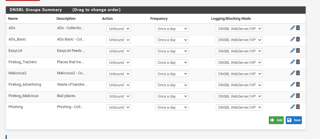

      I have installed pfblockerng-devel and enabled many ip and dnsbl's. I am testing the config with this page https://d3ward.github.io/toolz/adblock.html from a client. with pihole in default config i can reach over 70% blocking, with pfblockerng and many lists akiv, i got only 40% and this does not change (most difference in Analytics, Social Trackers) . if my search was correct pihole only uses StevenBlack (StevenBlack_ADs in pfblocker).

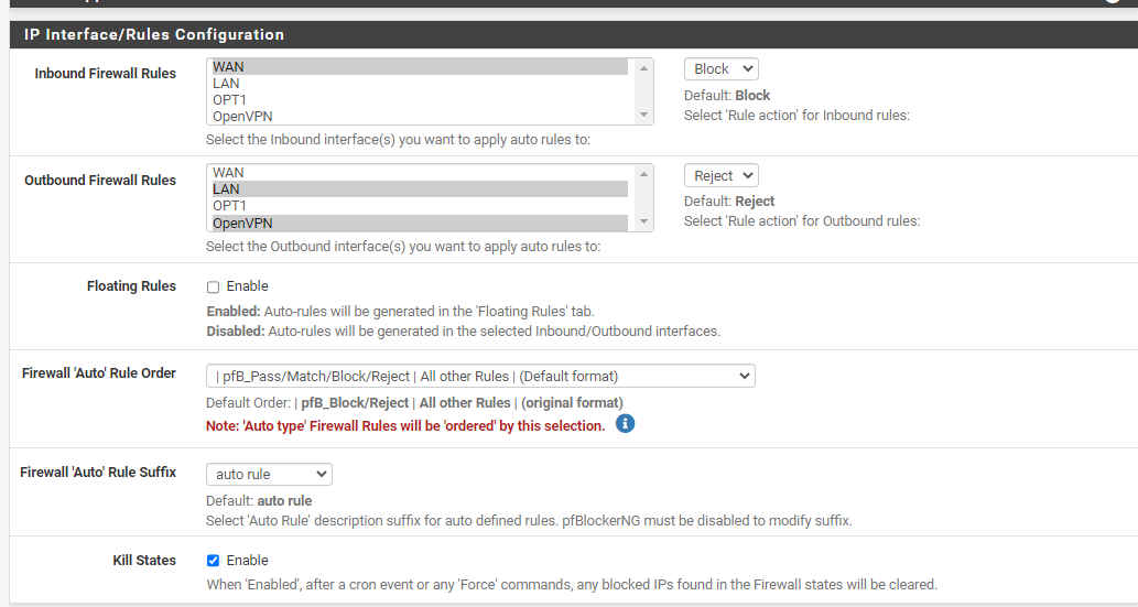

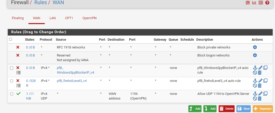

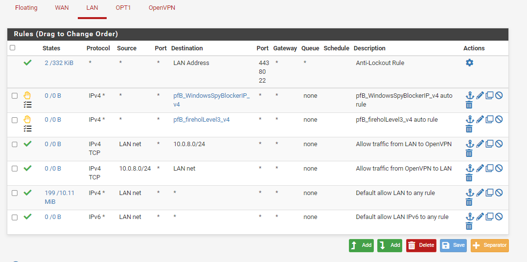

      what i discovered is, that there are no rules added after pfblockerng-devel konfig
      the update log (for me) do not look as its load all list i have added (force option reload All)

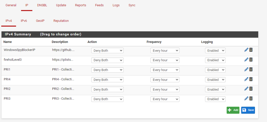

      the lists (every list fill checked)

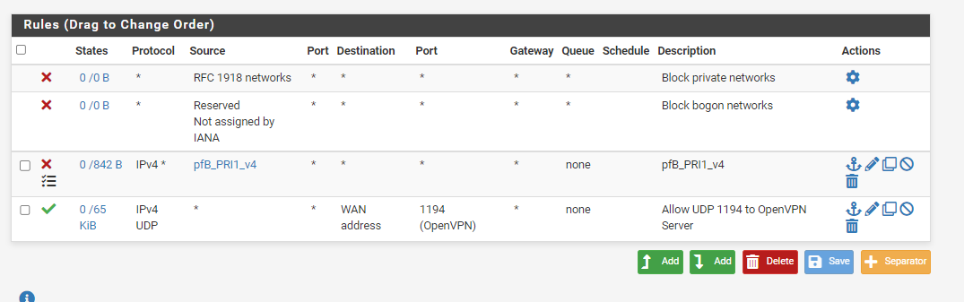

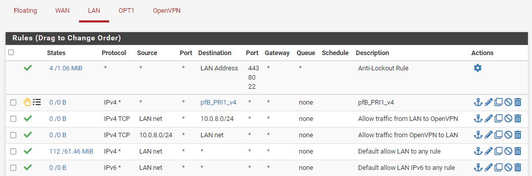

        News: After starting the wizard and doing the config (same feeds) the state on testpage is not better but update looks better and the rules are removed, a new rule was added
