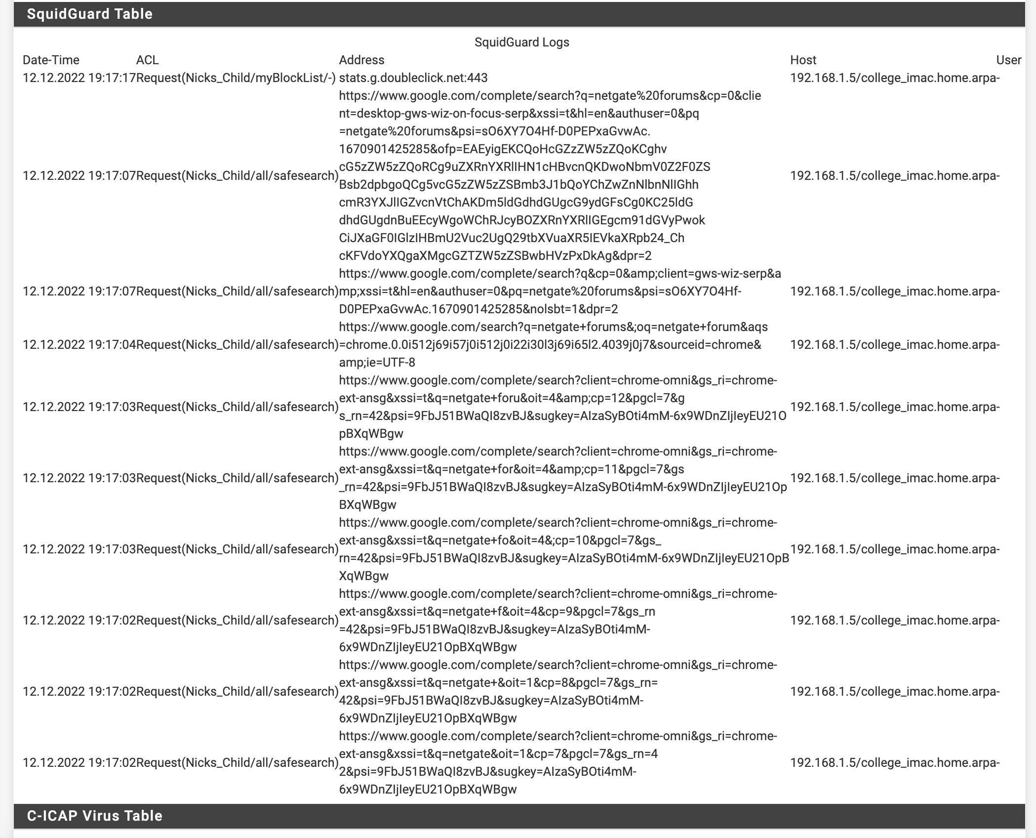

                            Make sure you make group ACLS this is just the IP addresses of specific requirements
                            Example loopback:
                            Example Protected Child Group ACL:
                            note the deny items.
                            Targets are what you want to filter approve or block they would show in the Target rule list

                              @jeffrey_223
                              What do you logs for this look like?
                              Make sure to upvote
