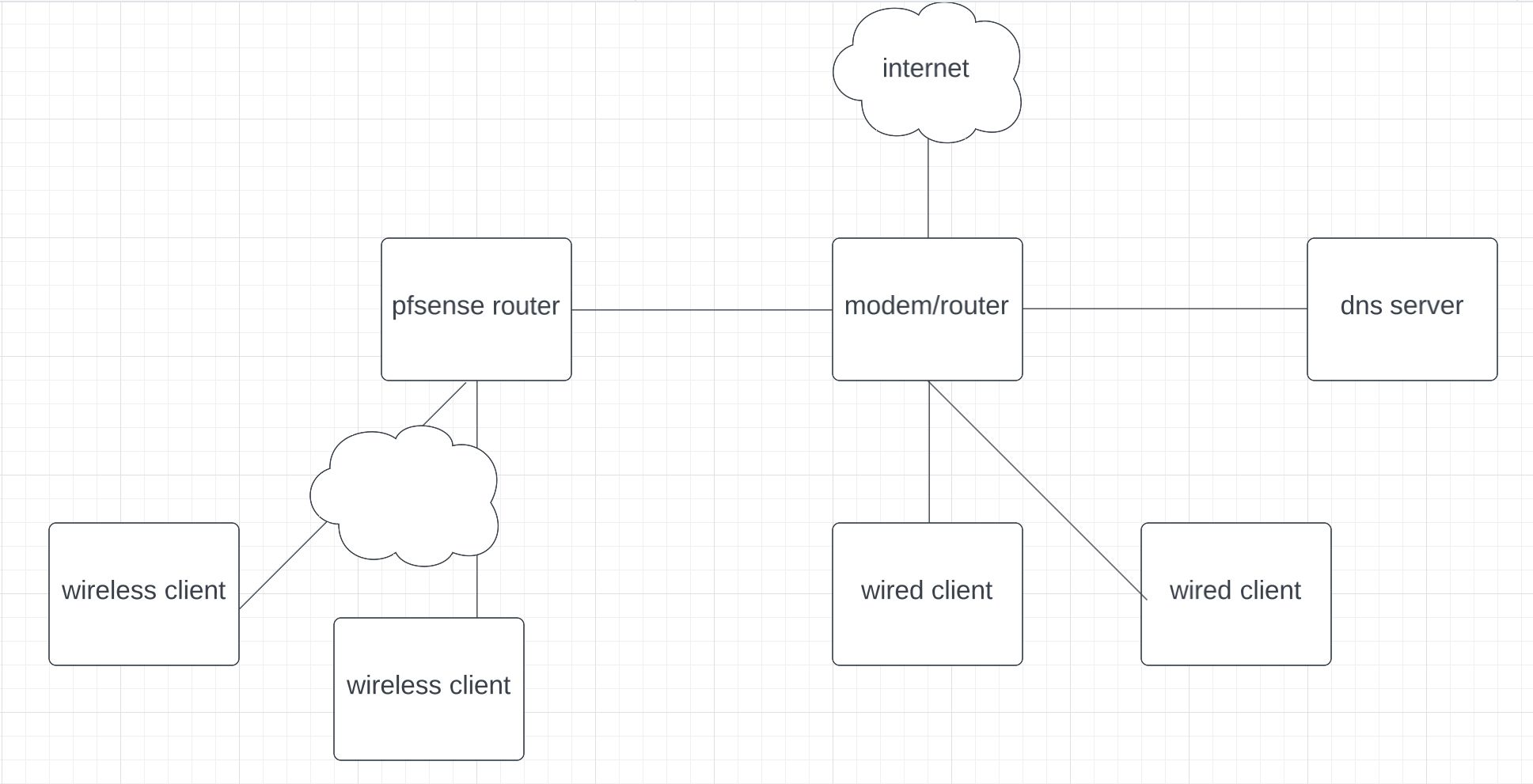

                    @johnpoz yes the modem router I suppose is acting as a gateway.
                    Have attached diagram.
                    The wan on pfsense is actually the lan in my network. Confusing I know.
                    S johnpozJ 2 Replies Last reply Reply Quote 0

                      @pfsensenewbie1 That simplifies it for me. :) Setting it to forward DNS to your DNS server IP should work.

                        johnpoz LAYER 8 Global Moderator @Guest
                        @pfsensenewbie1 said in 2 weeks still nothing.:
                        Confusing I know.
                        no not at all.. And again - the default rules in pfsense would allow you to talk to anything on its wan, or anything beyond that - ie the internet
                        You talking your dns server on pfsense "wan" is no different than you talking to say 8.8.8.8 for dns.
                        This would work out of the box for your wireless clients. Unless you were policy routing traffic out some vpn you setup on pfsense. Or you turned off the automatic outbound nat pfsense would be doing. Or you created rules on pfsense lan that prevented access.
                        Or you have overlapping networks on pfsense wan and its lan.
