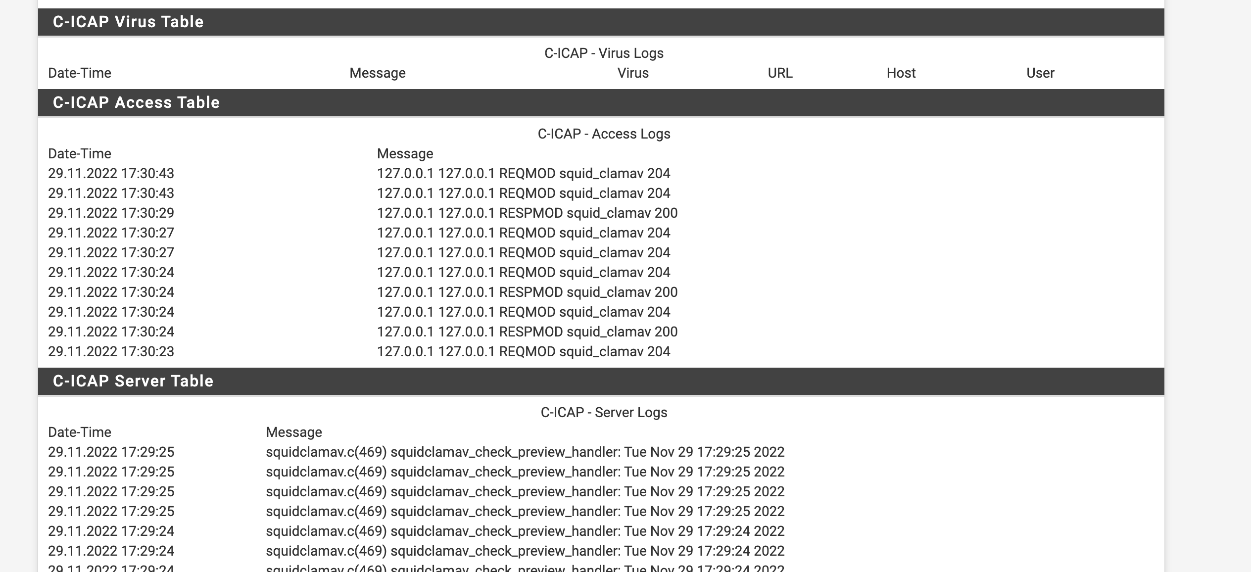

      (Virus Catching functional)

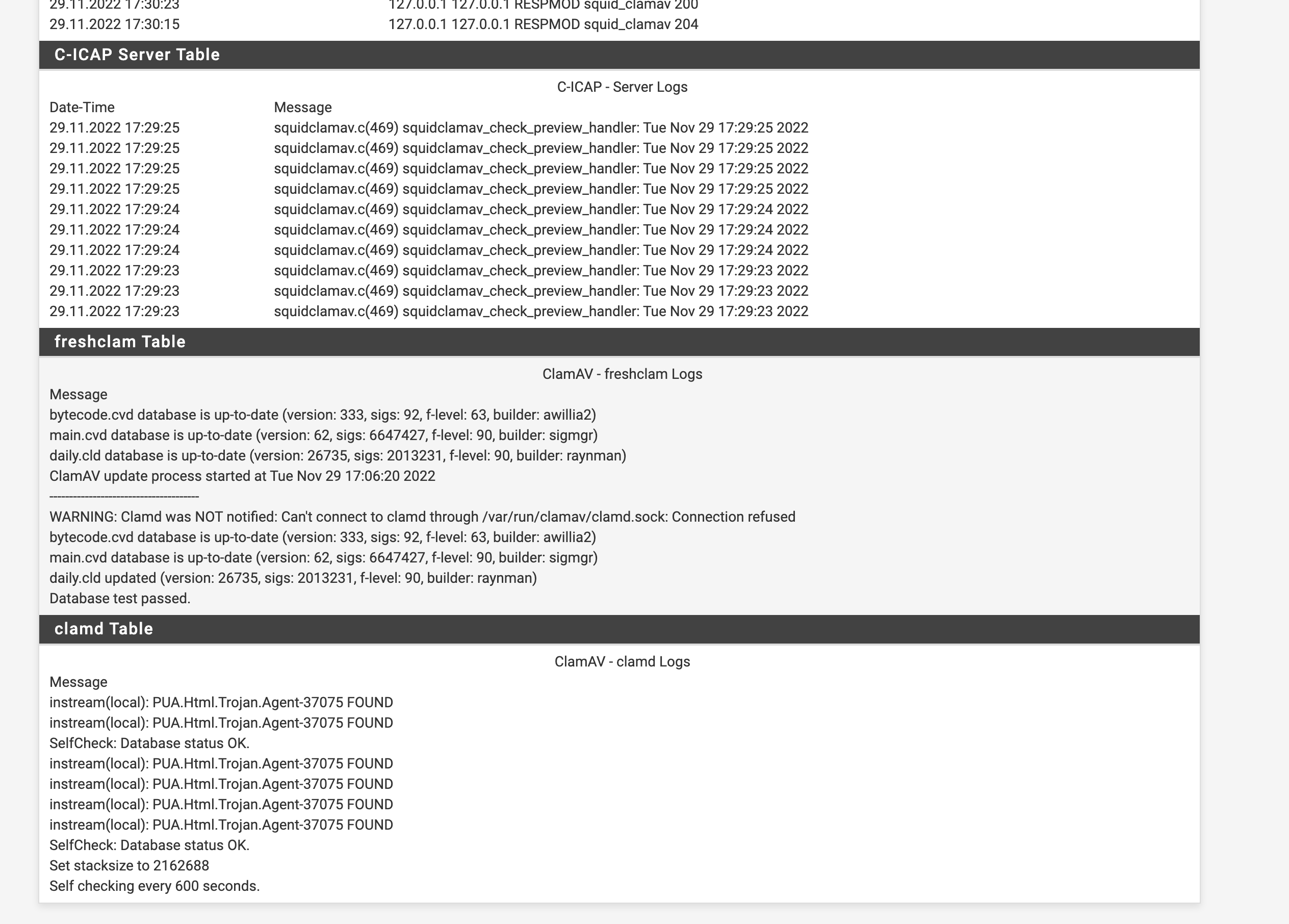

      (Logs no longer saving for CLAM AV Virus Table for tracking empty on clear)

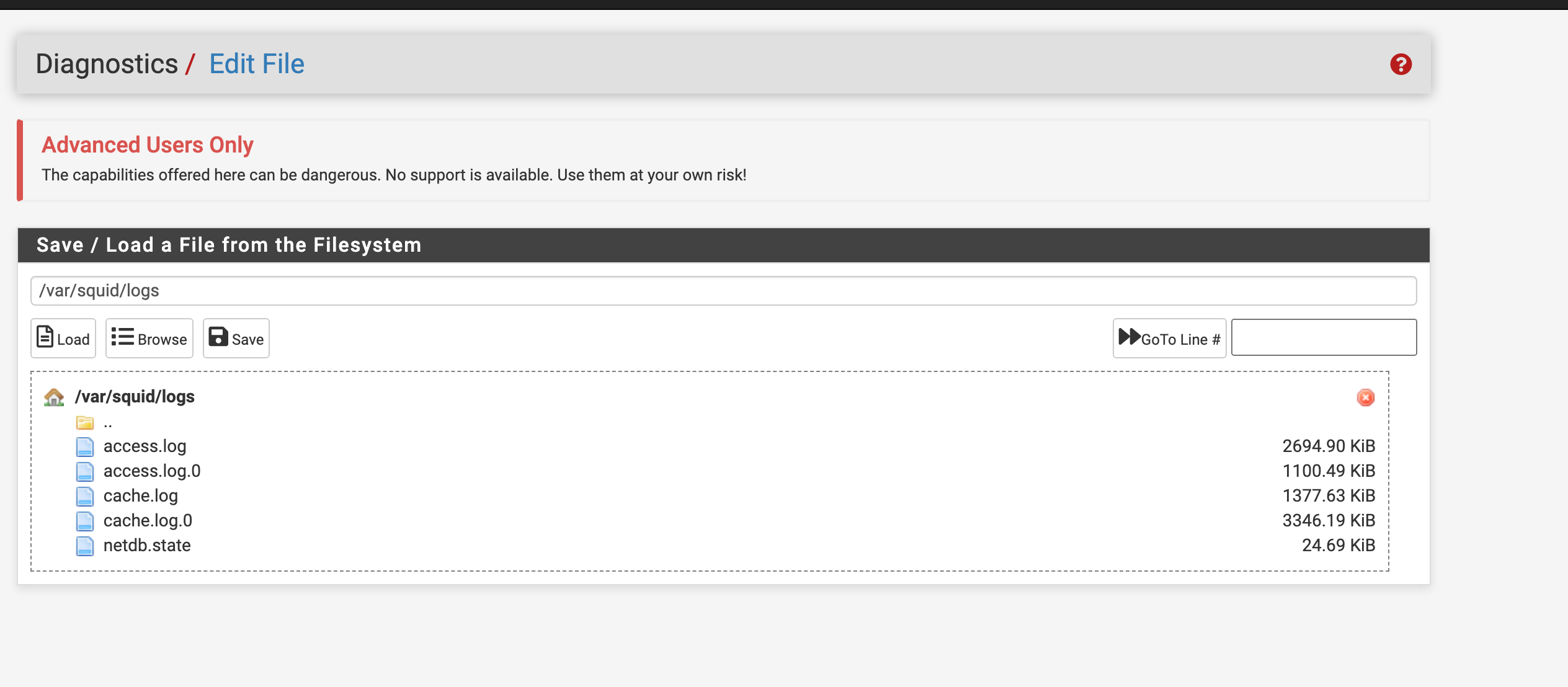

      I had to clear the logs as it would no longer save them something got corrupted.

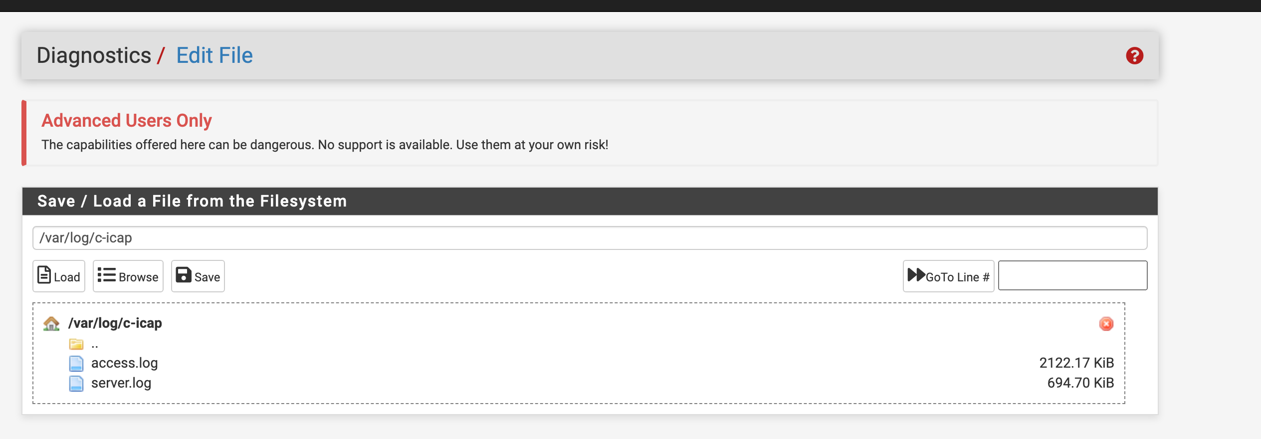

      (I have cleared all log files locally and they have restored)
      (I have also cleared all log files locally for C-iap)
      The virus table will not restore.
      The red stopped page no longer is functional.

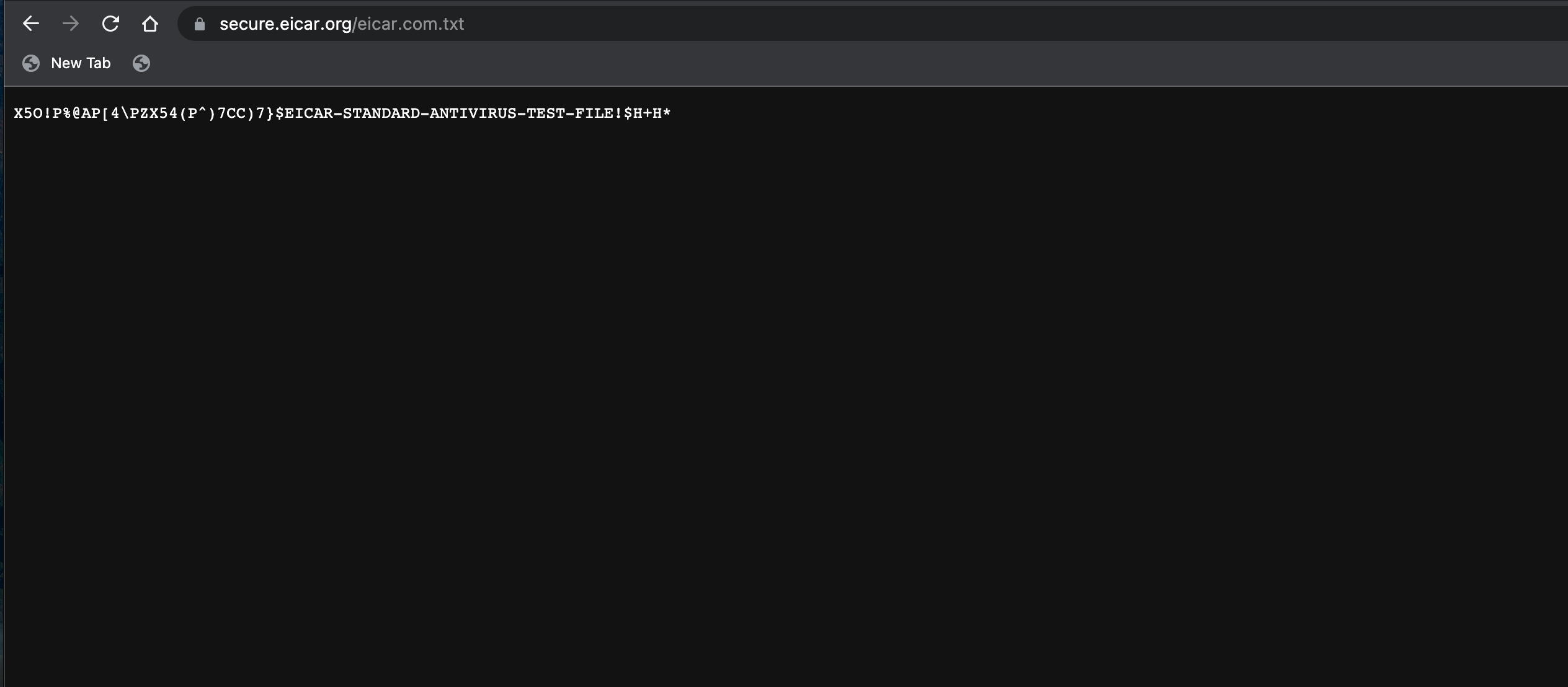

      (system will not catch test file)
      Again when it does catch a virus it shows an errored page that the certificate is unknown.

          You saw :
          which means, to me, that the part that feeds de data to be tested can't contact the scan deamon, clamd.
          Because it isn't running ?
          Because the socket 'rights' are not ok ?
          Because something else ?
          Check the 'clamd' log file.
          When it start, and fails to create the socket, it should log this.
          Tthe proxy can't pipe the received info through the scanner. Result : info isn't scanned any more.

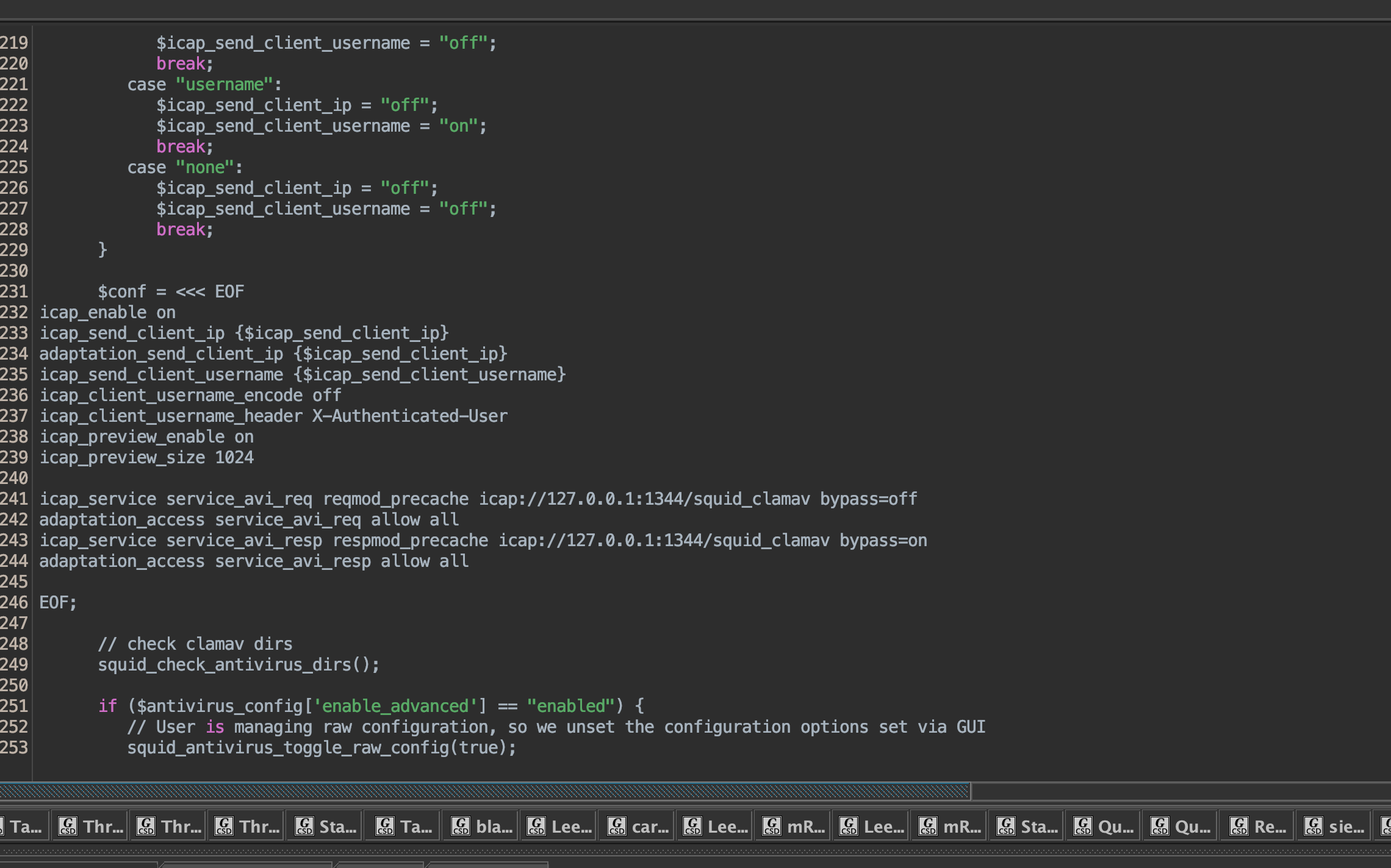

                          squidclamav_check_preview_handler: Wed Nov 30 15:56:36 2022, 92197/1098002432, ERROR clientip is null, you must set 'icap_send_client_ip on' into squid.conf
                          It goes on and on...
                          I have also just added
                          adaptation_send_client_ip {$icap_send_client_ip}
                          to line 234 of
                          ref https://forum.netgate.com/topic/129331/adaptation_send_client_ip-vs-icap_send_client_ip?_=1669853066007
                          It seems to already be enabled also, any ideas?
