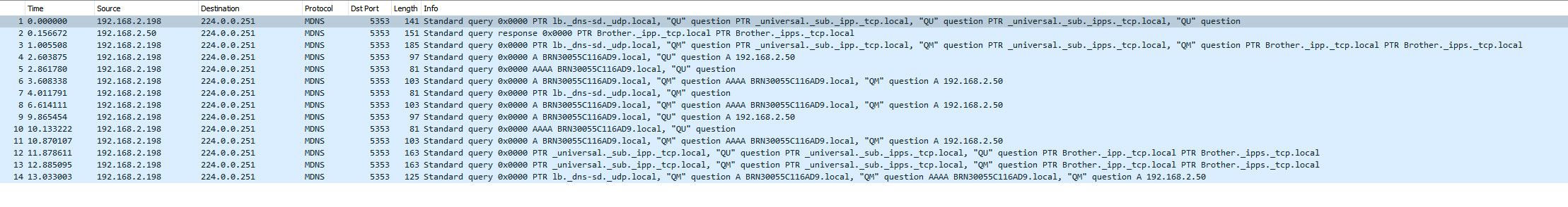

                mdns works by sending a multicast query to 224.0.0.251, all devices on that L2 network would see that traffic - unless at your switch or your wifi AP you were filtering that traffic.. Or that traffic was being bridged across 2 different L2 segments across your router.

                        Have you even bothered to look over the rfc of how mdns works that I posted?
                        mdns is a non server method of resolving.. A device wanting to resolve something sends out a query via multicast - any device that sees this multicast query will answer if that is its name. This has ZERO to do with the router device on the network - ZERO!!
                        I put a bunch of devices on a network.. They send out a multicast query for hey is your name XYZ - what is your IP, etc. If your "routers" name is not what its looking for - your router has zero interest in this multicast traffic..
                        If your mdns query for hostA is not working - that has zero to do with the router.. What that could have to do with is your switching network, and or your wireless network blocking this traffic. Or it has to do with hostA answering..
                        If what you want to do it resolve hostA to its ip, sure mdns is an option. which has zero to do with some router that might be on the network. This is multicast and devices on the same L2 seeing the traffic and answering - your router has zero to do with this.

                                          Here for example is some mdns on my wireless network my phone and printer are on..
                                          You can see my phone 192.168.2.198 sending out queries, and the stuff it already knows about, and you see a response from my printer on 192.168.2.50 to the multicast address. What I don't see is any directed unicast responses directly from the printer to the phone for example. I would have to setup span port of where my AP is to see that, since my printer is wired..
                                          Iphone loves to use airprint to find printers - wish I could just give it the fqdn or IP of the printer so I didn't have to allow for that nonsense noise on my network.. My PC for example has no issue just printing to the fqdn of the printer across vlans.. But vs breaking the boundary - I just put the printer on the same vlan as my wireless that devices that insist on using mdns, so I don't have to break boundaries passing mdns across network segments.
                                          edit: here I did a sniff directly on my AP via tcpdump for this sort of traffic.. This way I did not have to really change anything on my networks or clients or create a span port to see the traffic..
                                          12:29:06.767697 IP 192.168.2.198.5353 > 224.0.0.251.5353: 0 A (QU)? BRN30055C116AD9.local. (39)
                                          12:29:06.787748 IP 192.168.2.50.5353 > 192.168.2.198.5353: 0*- [0q] 1/0/0 A 192.168.2.50 (49)
                                          You can see where my phone 2.198 did a query to the multicast address, and the printer at 2.50 did a directed unicast answer back to the phones specific IP..
