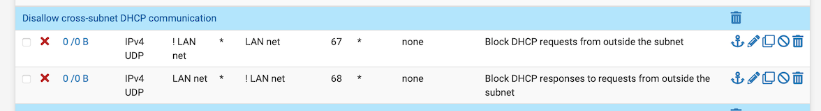

        I do think that this is not the right way to go about it, but I put two sets of firewall rules in place to prevent this from happening, even though my problem shouldn’t happen in the first place:
        LAN is the interface with a DHCP server providing addresses for the 192.168.14.0/24 subnet:

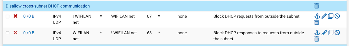

        WIFILAN is the interface with a DHCP server providing addresses for the 192.168.15.0/24 subnet:
        Only time will tell, whether this will prevent any leakage of requests from one subnet made to the DHCP server of the other. If it doesn’t, we’ll certainly have a piece of evidence leading to the solution.

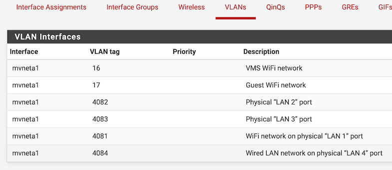

                    The physical ports relate to the VLAN tags like this:

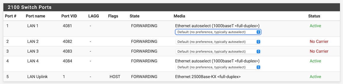

                    My interfaces LAN and WIFILAN are assigned to the ports like this:

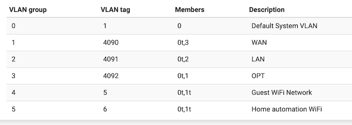

                    And the VLAN switching is like this:
                    It’s the last one I feel might be the culprit. I have never been really clear, what needs to happen here. I am eager to learn!

                        You have 3 networks on port 1, but you said you are using separate physical interfaces.
                        You also have then tagged, if they really are separate, they should be untagged.
                        And your WIFI LAN is the untagged on that port so that probably explains why you're still getting the old IP's, you're still connected to the old network.
                                  Which are you referring to? Port 1 in the listing of 2100 Switch Ports?
                                  That physical port is connected to a managed PoE switch, which powers the access points. Its members are:
                                  • the untagged traffic on that network segment,
                                  • the tagged traffic of hosts on (1) a guest SSID and (2) a “VMS” SSID.
                                  The way I understand it, the setup VLAN group 1’s and 2’s members ensures that the tagged traffic is forwarded to the router, where they are identified with the two corresponding interfaces based on the VLAN tag. The fact that VLAN group 5 also has a “5t” in it, I don’t fully understand. It’s duplicated from a setup I am using on an SG-1100:
                                  In other words, why would VLAN group 5 and 6 (back to the SG-2100 now) not have the members set up as “1,5” and “4,5,” respectively?
                                  If either of you could elucidate that, I would be very grateful.

                                      @dominikhoffmann
                                      They should be 1,5t and 4,5t, but you don't have them like that.
                                      You have them both on 1.
                                      Again, you said they have separate interfaces now, is that true?
                                      If so, they should not be tagged, no need to as they are the only network on each interface.
                                      I'll throw this out first, I never used a Netgate appliance with a built-in switch but as I understand it, the members are the switchports.
                                      So for vlan 16, the members should be 1,5t (or 4,5t if that's the way you connected them) with 1 being the untagged switchport and 5t being the WAN.
                                      Vlan 17 should be 4,5t (or 1,5t).
                                      You have them both tagged on port 1 which would be fine if you're breaking them out in your managed switch.
                                      You said separate interfaces, so then separate them.

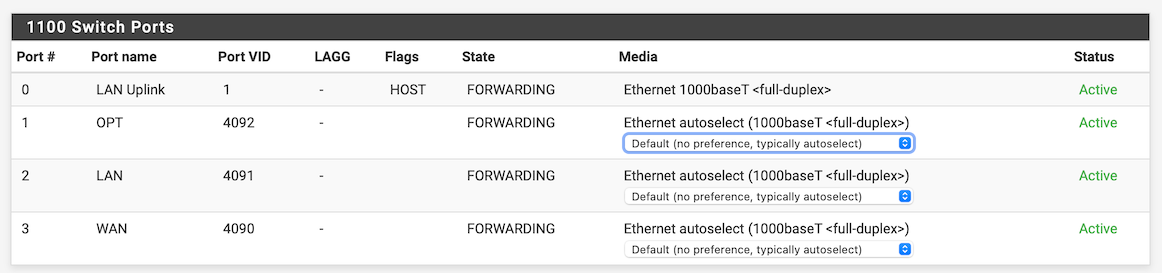

                                        @jarhead: The numbering of the ports is different between the SG-1100 and the SG-2100. This is what the SG-1100 has:
                                        Showing again the SG-2100’s:
                                        In other words, what’s a “0” on the SG-1100 has to be a “5” on the SG-2100.
                                        Yes, on the SG-2100 the LAN and WIFILAN interfaces are on separate physical ports. On the SG-2100 I just duplicated, what was the default on the SG-1100: “0t,1” and “0t,2.” Those became “1,5t” and “4,5t.”

                                          Double check the wifilan interface, if that is set to the 15.0/24 network, then it looks like your problem is gonna be in the managed switch.
                                          From what I see, the 'new' wifi is the untagged on port 1.
                                          The new wired is port 4.
                                          For some reason I was thinking vlans 16 and 17 were the new network, my mistake.
                                          Are the AP(s) vlan capable?
                                          Are you sending the correct vlans?
