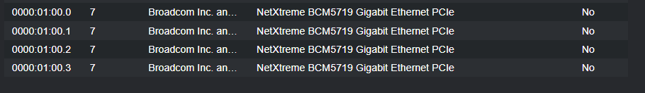

          Somewhat understand your answer. I have tried passing 2 ports of the 4-port NIC card as separate ports to pfSense VM (see below - 1:00.0 and 1:00.1) - but when the VM starts, only one of them is seen.
          This is why I asked can I just pass-thru the WAN port and use paravirtualized as the LAN port? Any advantages to this? Disadvantages I understand if I have to backup or restore, I cannot unless everything is virtualized.
