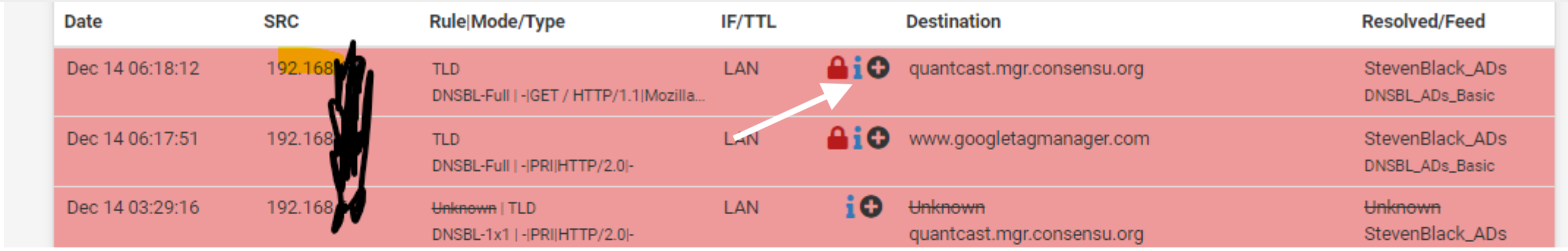

        @nollipfsense Thanks, but no i don't see no block event under that firewall logs, I always thought that ip_block is your file for pfblockerng block events. I can see blocks events under "unfied logs", as color red yet which is strange
            As you can see i can see under "unified logs" the blocks of DNS but on highlighted IP Block set there is no IP?

                @asadz If you click on the Info button, see arrow, it should show the IP you were trying to go to. You don't need to mask you LAN address as no one can get to it.
