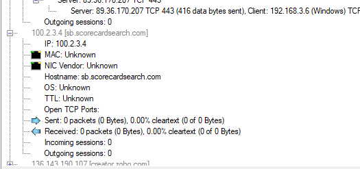

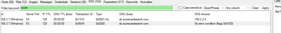

                    1415:40:17,reply,A,A,Unk,sb.scorecardresearch.com,192.168.3.6,100.2.3.4,US
                    this log entry from pfsense dns_reply.log shows the DC is requesting A record resolution for sb.scorecardresearch.com and it is however returned a wrong IP address.

                      asadz @johnpoz
                      @johnpoz also i don't expect the local DC to resolve this , as its external IP address, and the local DC is only responsible for .local network host names resolution. You can see the dig command comparison as well. Pfsense is using cloudflare for name test.png

                                    Also when I do wireshark I see A query record returned by DC for 100.2.3.4 and not by pfsense. I flush cache at DC but no change, also rebooted DC as well
                                    1 Reply Last reply
