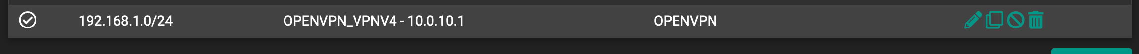

      pfsense static route:

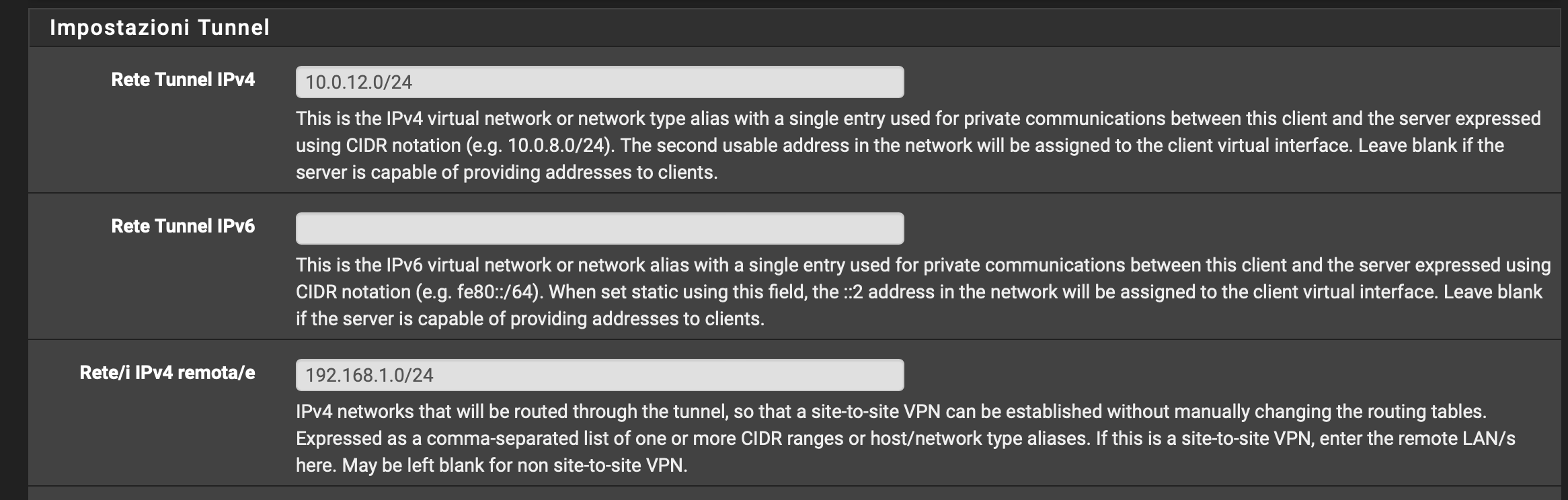

      pfsense tunnel remote IP

        @lucaset256 Make the tunnel a /30 or /31.

          @jarhead problem solved, I was missing some static routes on both the routers...
