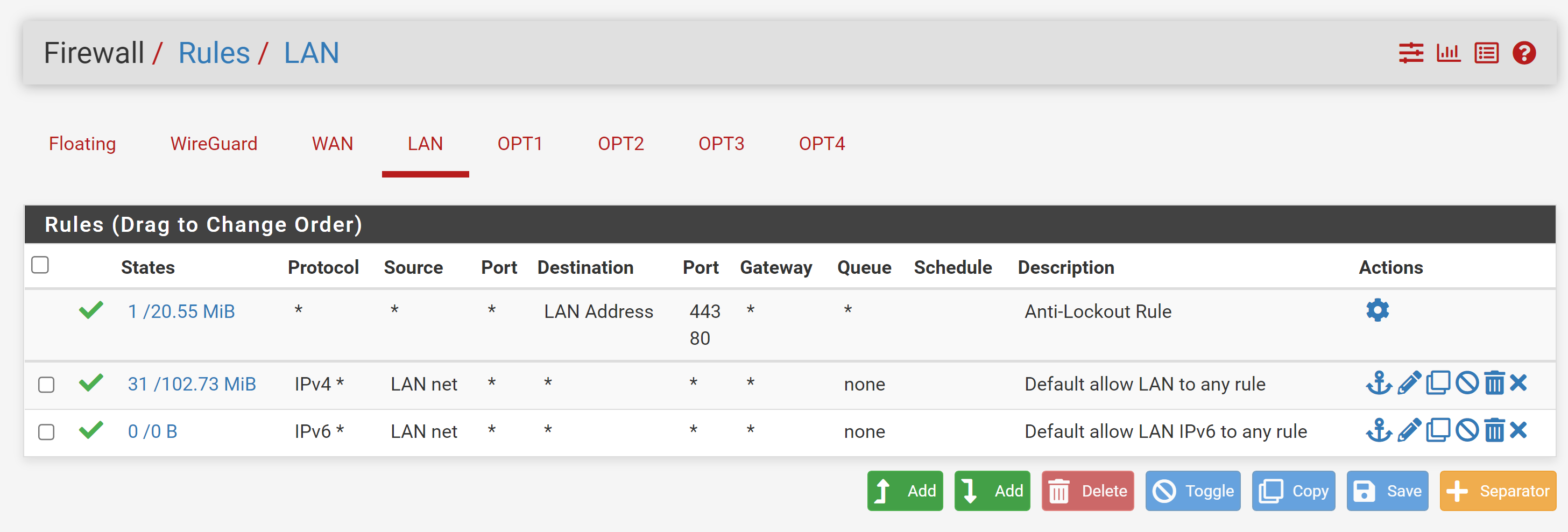

                  @chinchun said in Wireguard remote access:
                  is there any option to set pfsense only listen on LAN interface?
                  No, you have to make rules on all the interfaces to allow and or block access to pfSense.
                  One common rule to create for this looks like this:
                  But you might want to add a DNS rule before that if clients should access the DNS-server on pfSense.
                  C 1 Reply Last reply Jan 5, 2023, 2:21 PM Reply Quote 1

                      Bob.Dig LAYER 8 @chinchun
                      @chinchun I updated the screenshot above so that the rule is more secure and can be copied easily to other interfaces.
