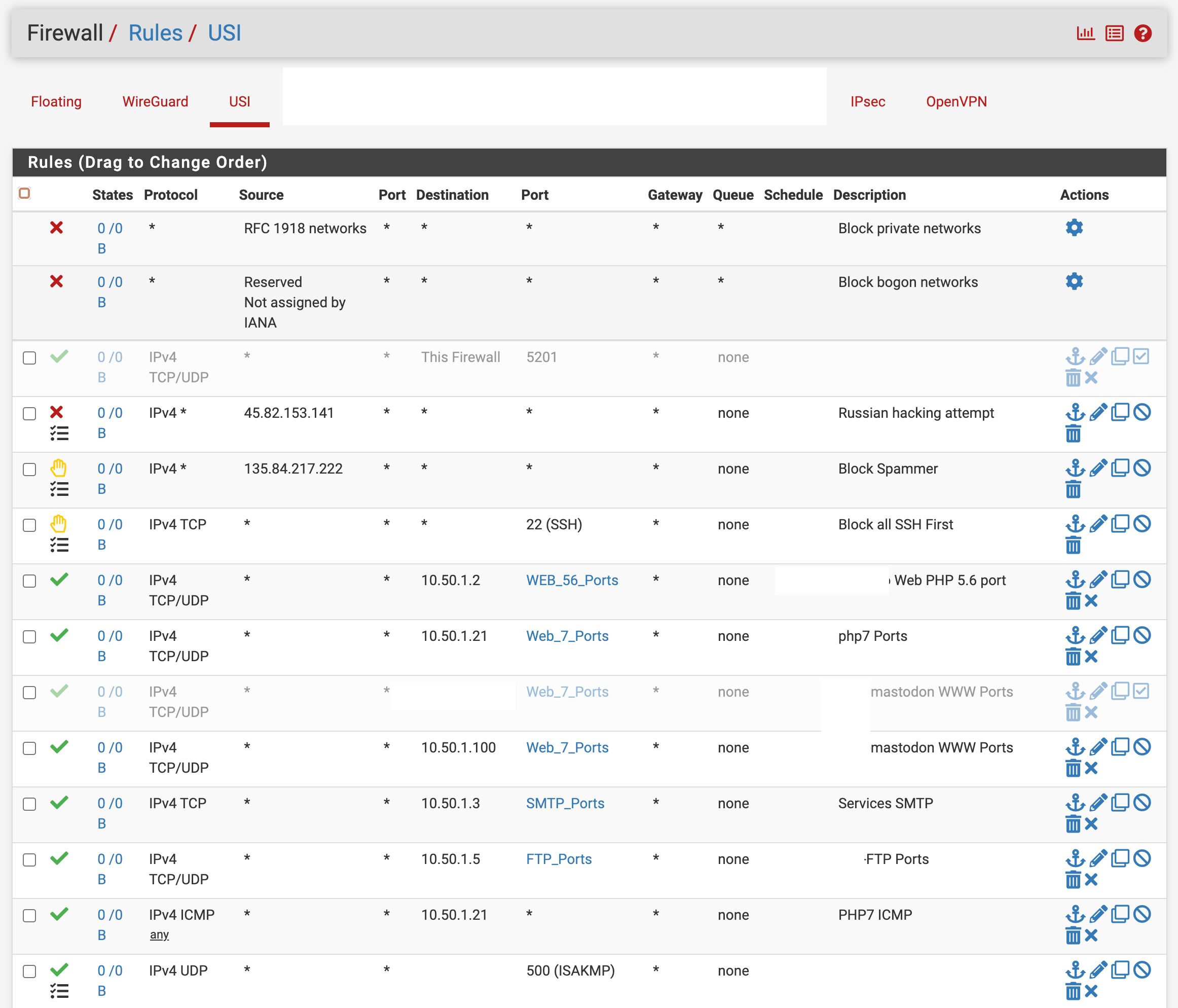

                • R
                  rcoleman-netgate Netgate @leonidas-o
                  @leonidas-o said in 1:1Nat, two public IPs for one server with one nic:
                  So I still need a port forwarding rule and I still need firewall rules allowing the traffic?
                  Just doing the 1:1 means it will also communicate on that IP going out to the world... you need to still open ports to allow it through the firewall.
                  I might have overdone mine in 2014 when I switched to my ISP but here's my WAN firewall rule tab for my VIPs and the internal servers, the supporting VIP and 1:1 NAT pages.
                  Ryan
                  Wireless: Aruba, Ubiquiti
                  1 Reply Last reply
                  Reply Quote 0

                    @rcoleman-netgate Okay I see, you got the visual IPs, so do I. Yours is USI and Proxy ARP, I'm simply using WAN and IP Alias.
                    You got the NAT 1:1 mappings, the external IP to internal IP and destination "*".
                    And finally you have some firewall rules. Okay, I thought if using 1:1 Nat it will automagically add the rules, so this is not the case and I have to add the rules, I see.
