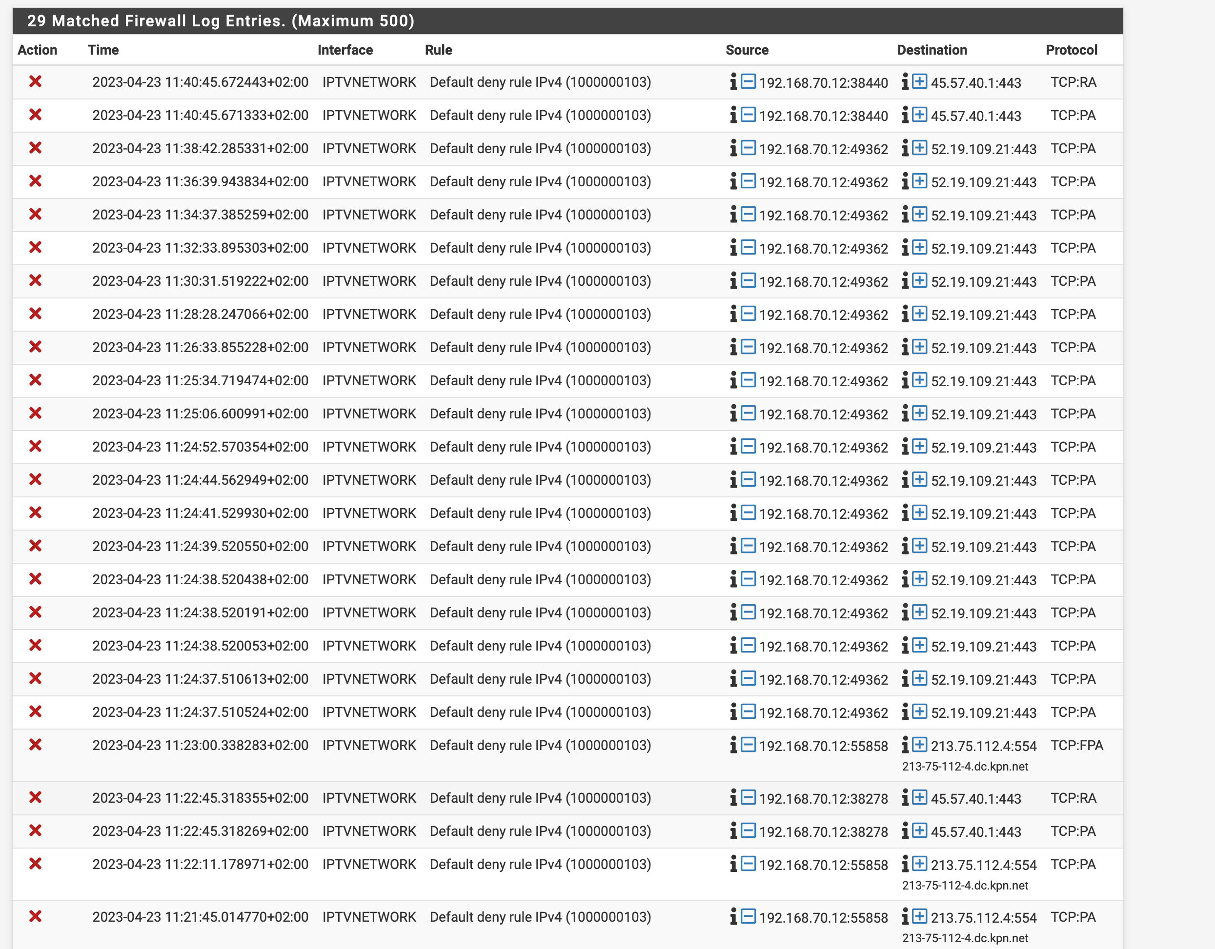

            Found some more evidence of what went wrong in the firewall logs:
            I rebooted my device around 11:21. Before the reboot, you see that some address in the 213.75.112.x range is getting blocked. After the reboot, this block does not appear anymore. I was doing my testing after this period.
            Unfortunately and in all honesty, I don't fully grasp all the settings that are required for IPTV, but it appears that the changes I made based on @thebear's settings made a change after the reboot.
            I wonder though what the https request are that the box is trying to do and that get blocked... What functionality does this block? Anybody any clue?
            • H Offline
              haraldinho @haraldinho
              Ok, pasting 45.57.40.1:443 into a browser leads to a site with a blocked Netflix certificate. So that gives some idea into what the box tries to do. The other IP, 52.19.109.21:443 does not reveal any information as far as I can see.

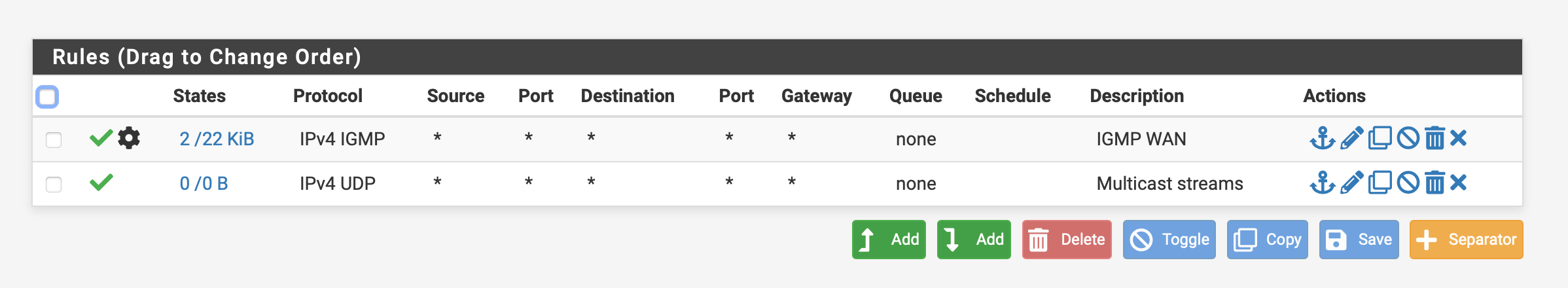

                  Can you guys build the firewall rules like this:
                  IPTV_WAN
                  IPTV_LAN
                  The screenshot showing that regular internet traffic is blocked, so also your DNS and TCP traffic which is needed to communicate with the streaming platform.
                  M H 2 Replies Last reply Reply Quote 0
                      Indeed see my post above where I ask you to use my FW rules and delete all other rules for these two interfaces. You are blocking too much traffic which causes different issues. NTP, DNS issues but also proven by the logs that Netflix traffic is denied.

                          @thebear Thanks for the settings! I was busy in the past days, but this afternoon I changed my settings to match the above. I struggled a bit with the "IP Options": it took me some time to realise I had to enable those for the lines with the settings wheel in front of them to get it to work. I am currently testing to see if this resolves my issue that after some time you cannot unpause paused recordings. And I am monitoring my logs to look out for blocked calls.
                          Question for @thebear: it seems to me the way you have set your rules up is allowing basically all IGMP and UDP traffic into the IPTV_WAN interface, rather than from specific IP ranges? I understand it is more future proof but isn't that a security risk?

                                thebear @haraldinho
                                @haraldinho firewall and nat are two separate things.
                                Can you post your FW rules for IPTV WAN and IPTV LAN?
                                Via IGMP is the box requesting streams, the streams could be source from multiple subnets. Therefore its way to complex to filter on the sources, software updates comes from 10.a.b.c. and streams from other sources.
                                Regarding security, it's not the internet. It's a private IPTV vlan within your ISP. That reduces the risk for an attack with a million percentage. But yes hack could occur always, every minute your pfSense instance is attacked on the WAN internet interface.

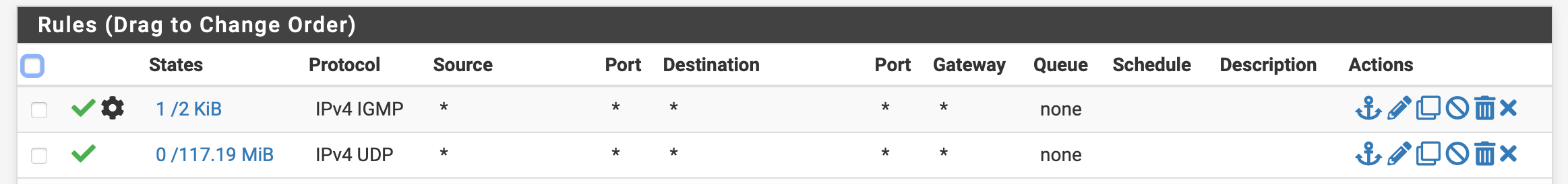

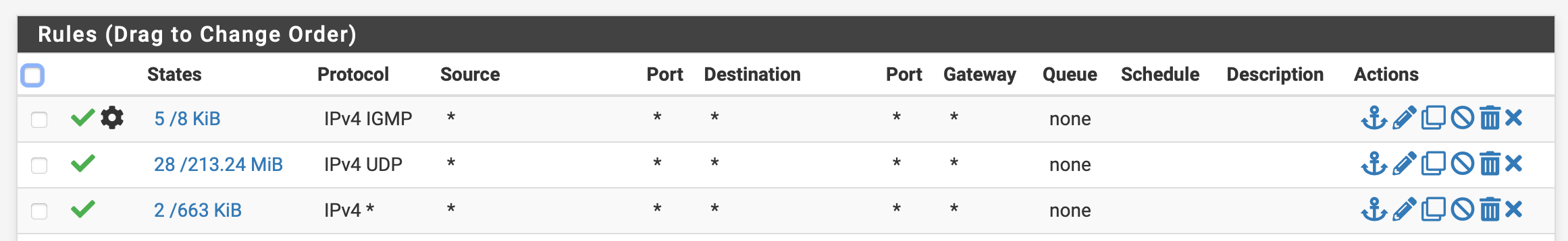

                                    haraldinho @thebear
                                    @thebear thanks for the help, below are my rules
                                    WAN IPTV rules
                                    LAN IPTV rules

                                          thebear @haraldinho
                                          @haraldinho @michiel
                                          I'm not seeing a mistake in the share configuration parts, don't know where you hitting the default deny log rule. I'm sorry
                                          In generic the fixed the issue in the GUI where we where not able to add 0.0.0.0/0 that's fixed for now.
                                          I have added some more security to the ruleset, there is no traffic allowed to the other LAN components when "the hacker" has access to the STB.
                                          WAN
                                          LAN
                                          M T 2 Replies Last reply Reply Quote 0
                                            michiel @thebear
                                            @thebear @haraldinho
                                            I read about solving the GUI issue as well (0.0.0.0/0 is possible now).
                                            @haraldinho Perhaps clearing the stating table via the "x" in the firewall rules on IPTV_WAN and IPTV_VLAN solves your issue? Or rebooting the Netgate...
                                            @thebear thanks for the extra security; that's partly going back to what I had. What extra settings do you have in the firewall rules flagged with the 3 thicks in the box; the second WAN rule and rules 2 and 3 at your LAN rules?
