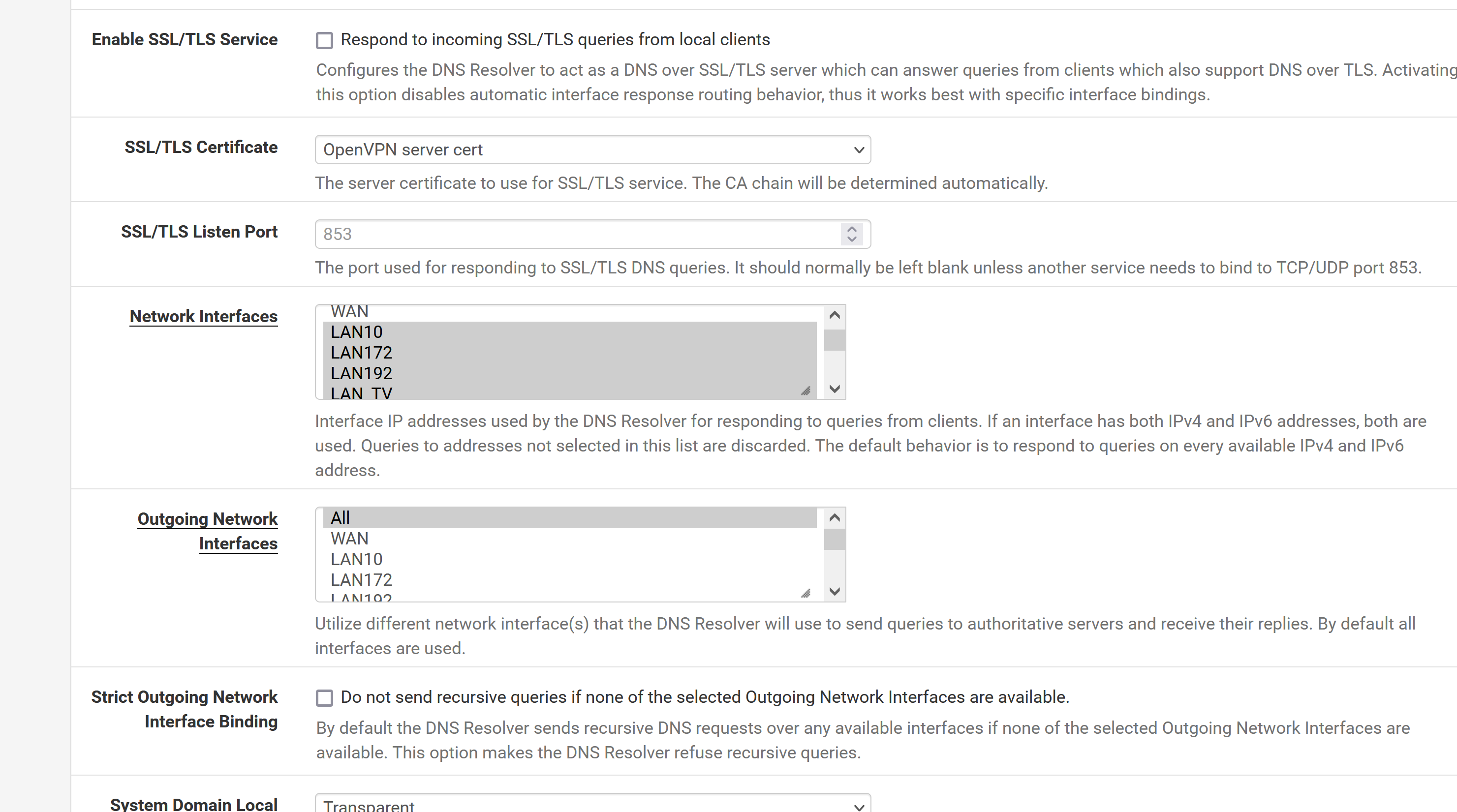

                  maverick_slo @jimp
                  @jimp
                  As for interfaces, outgoing: ALL
                  Listening on:
                  • jimpJ Offline
                    As a test can you try to see if it happens if you have nothing selected in either interface box? Having 'all' selected should be equivalent, but it's still better to test with everything unset.
                    Also, are all of the selected interfaces static (IPv4 and IPV6)?

                      maverick_slo @jimp
                      @jimp The following input errors were detected:
                      One or more Network Interfaces must be selected for binding.
                      One or more Outgoing Network Interfaces must be selected.
                      All interfaces are static
                      • jimpJ Offline
                        OK, so pick 'All' there, that must have been fixed up at some point. In some of those controls in other parts of the GUI, selecting nothing is the same as selecting "All".
