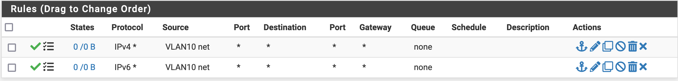

            @viragomann said in VLAN not working in simple test.:
            And changed the source to VLAN10 net?
            Yes, here is the ruleset:

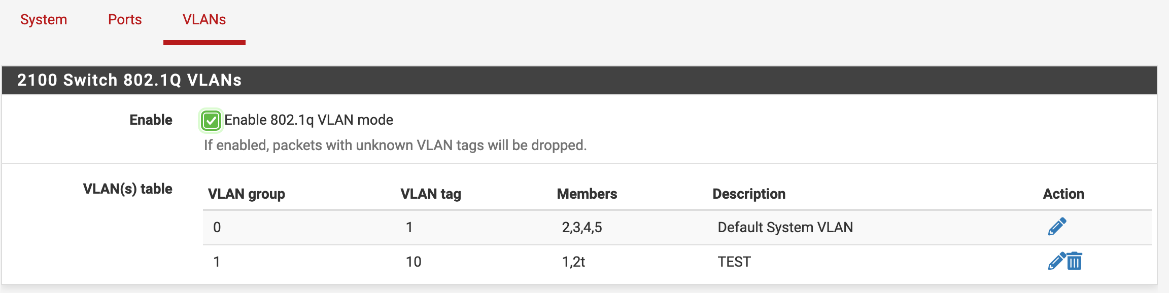

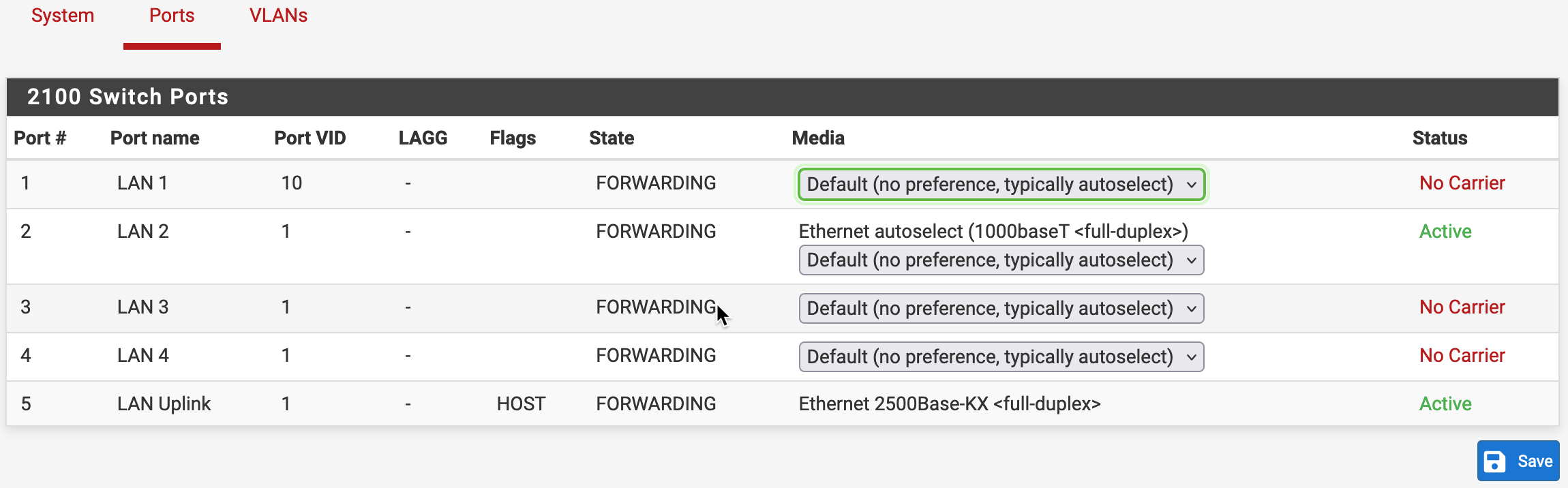

                Tried that, and my config looks exactly like that, let me show you, now that screenshots work:
                (Last image wouldn't paste, but i've got PVID of port 1 set to 10, all other are still at default 1.)
                I would assume that in this case, all traffic on port 1 should be tagged as vlan 10, but for port 2 vlan 10 is allowed, but not tagged onto untagged packages.
                This was so I could test both senarios, but I don't get anything...
                    Not clear, why you've added port 2 to the VLAN, but you will have to add port 5 as tagged, since this is the uplink to the kernel.

                        akke023 @viragomann
                        So that I could see if maybe I could let the tagging of the vlan happen on another device.
                        eg. on my client/switch I could set a vlan 10 for my device, the pfsense should see this, and since port 2 tagged in vlan 10, I should be able to access vlan 10 also.
                        Either way, neither way work, lol.
                        This is the way!
                        I realize now it was right in my face all along...
                        But I guess after staring yourself blind on a problem you start missing things...
                        So I'd like to thank you all for the help!
                        Consider this one solved guys!
                        Just need to add port 5! For some reason my mind did not register the fact this was not a physical port...
