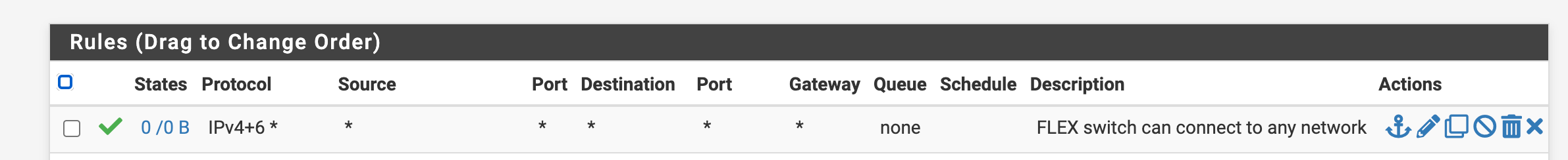

        @viragomann Yes. My fire wall rule for LAN2 is below.

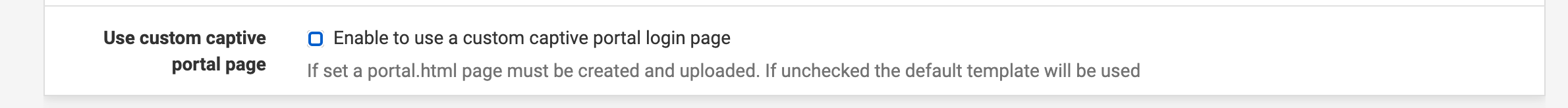

            @viragomann I don't see these options, as I haven't enabled the below option 'Use custom captive portal page' . Screen Shot 2023-02-26 at 9.15.52 AM.png
            Do I need to enable this?

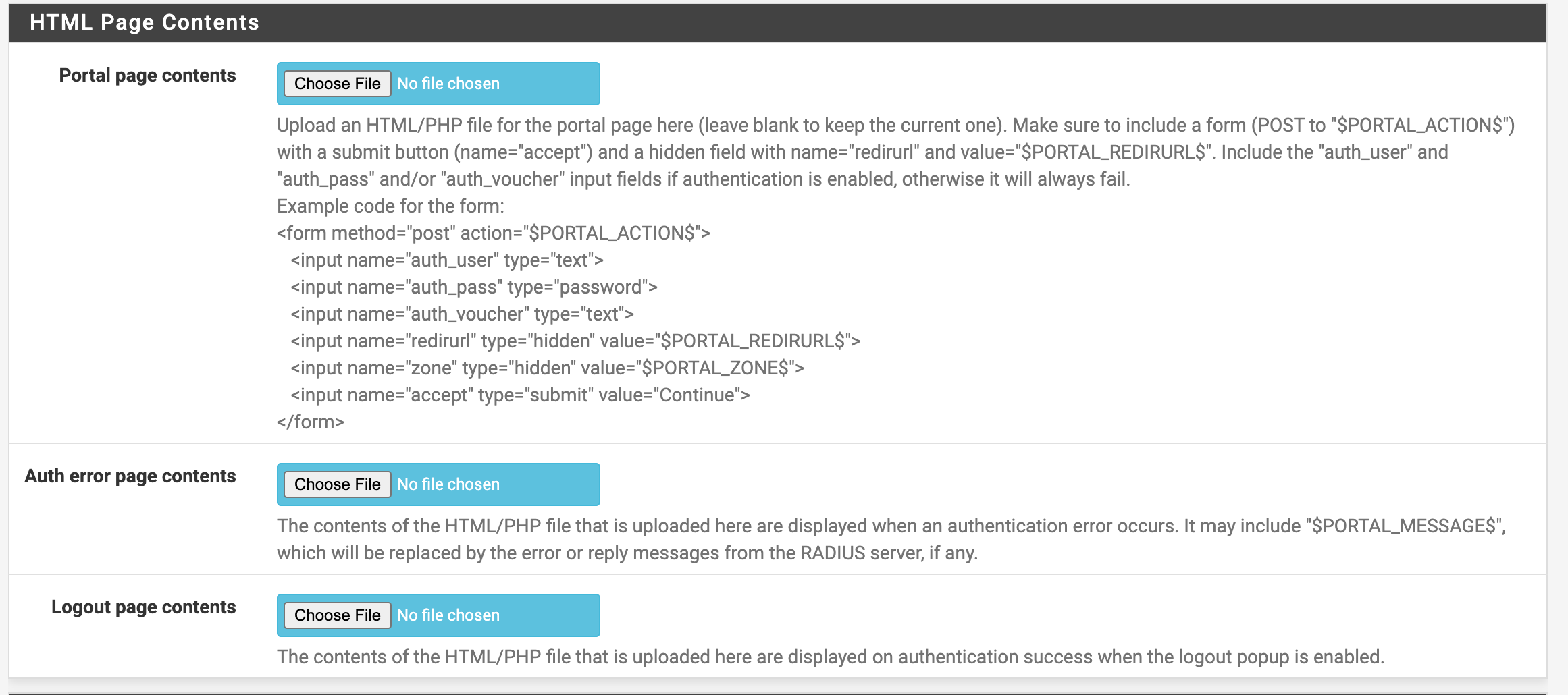

            If I enable this option, I can see the section called 'HTML Page Contents', but I still do not see 'Live View'. See below.
            What am I missing?. Thanks for your help.

              No, this option is only for custom login page. If you don't upload any, pfSense provides its default login page.
              Didn't know that the view button is hidden if no custom login page is used.
