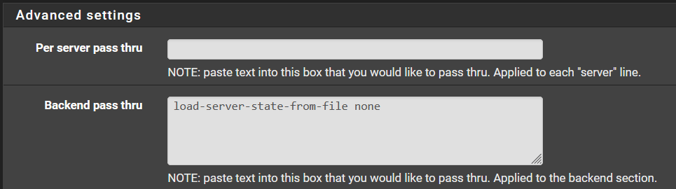

                            Adding
                            load-server-state-from-file	none
                            to the Advanced Settings > Backend pass thru section of each backend overrides the behavior and makes backend changes apply immediately when reloading.

                            • N Offline
                              nick23369 @andrew_cb
                              @andrew_cb Thank you very much for this, I just tried your proposed solution and it did work! That was driving me crasy! Way simpler than deleting the haproxy_server_state file.

                                      @nick23369 You don't have to wait for the official fix. Adding the directive
                                      to each backend will override the default behavior and makes HAProxy backend changes take effect immediately. This is the easiest - do it one time and it's done.
