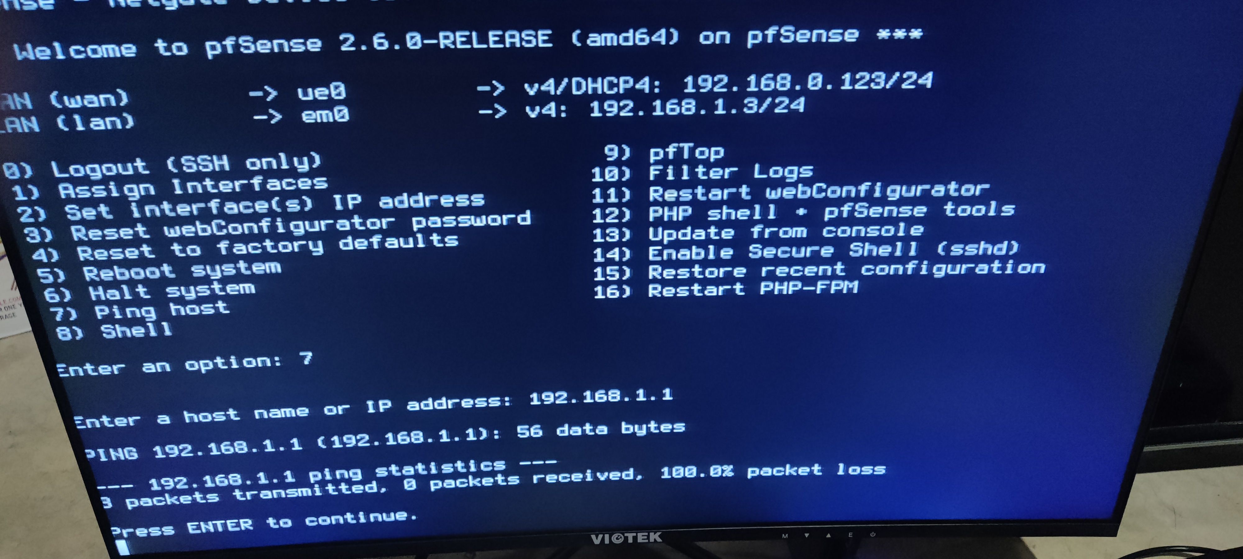

                Can we see a screenshot of the console after you've configured it with WAN and LAN?
                  mathomas3 @stephenw10
                    mathomas3 @mathomas3
                    @mathomas3 192.168.1.1 is the existing router that is pingable from existing machines... ie the old router is still on the network... I am using a dummy USB router for this test build
                      Mmm, OK that looks fine.
                      The ping there shows no response not 'host is down' which implies it is responding to ARP.
                      The client at 192.168.1.1 may be blocking those ping requests.
                      You should be able to ping 192.168.1.2 from the client though. Assuming the client has the correct subnet configured.
