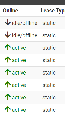

      Hello,
      I see some IPs there online status is not active it's idle/offline, could you please help me what could be the cause, how it can be fixed?
      Thanks for you help in advance,

        @ibnkamala do you think that would create an issue in the network? because we have some packet loss in the network! and sometimes even we lost access to some servers, which are not the idle/ofline once.
          mer @ibnkamala
          @ibnkamala I've seen that on my system, I think there may be some counter that looks at traffic. "I have not seen any traffic to/from that static configured system, so will mark it idle/offline. As soon as I see enough traffic I will mark it active".
          I don't know if that is the logic in the code, but that is the behavior I've seen. If all your systems are on a switch behind pfSense (say off the LAN interface), traffic between them will not pass through pfSense, so you can have lots of traffic passing through the switch, but not through pfSense.
          If you go to one of those idle/offline systems and do something that generates traffic through pfSense (like check email, ping 8.8.8.8, etc) the status goes to active.
          "Would this cause issues...." My opinion, no as long as your network is behind pfSense. If you are using multiple LAN/OPT ports on the pfSense and access to the servers is through pfSense, then "maybe it could cause issues"

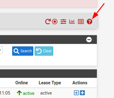

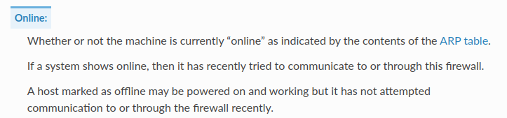

                          For future reference, if you have a question like this, the first thing to check is the help/documentation for the page.
                          Hit this link on the page and it'll take you to the most relevant docs page:
                          The page it links to explains the meaning of that column:
