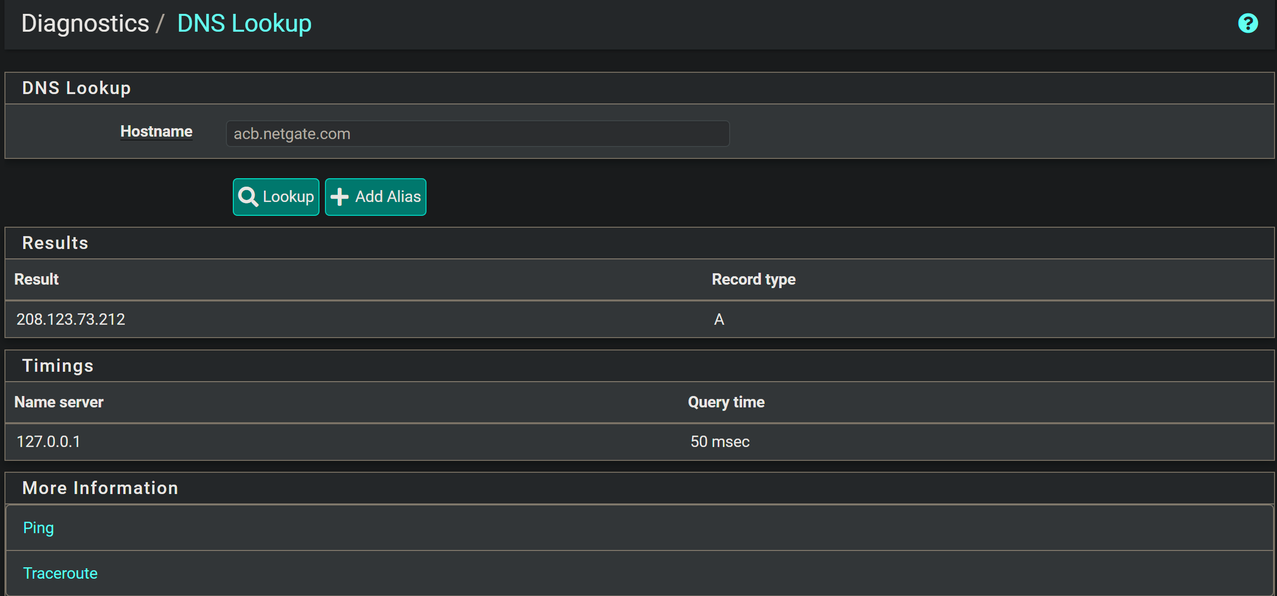

      I am getting a message that my backup is failing to upload to the Netgate servers (which I have it set to do after every config change).
      The message states that "acb.netgate.com" can't be resolved, but when I do a DNS resolution test, it resolves just fine? Please advise:
      • stephenw10S Online
        Do you see that error every time it tries to save?
        How do you have the DNS configured in System > General setup?
        You are only seeing a response from localhost/unbound in the test.

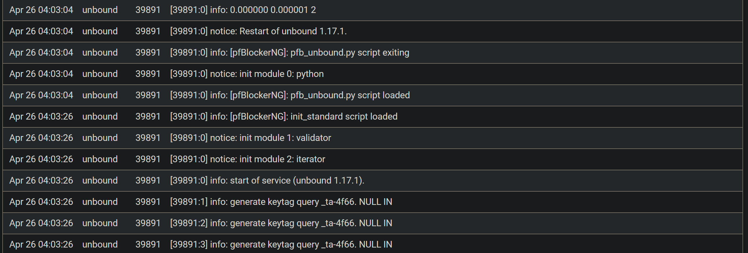

                                          To give you a better sense of my configuration - I have pfBlockerNG installed, so all traffic for all clients on my primary LAN Interface/VLANs go through Unbound, with no downstream server.
                                          The only exception is my guest interface/VLAN used for wireless and IOT - the DHCP server on that Interface/VLAN is set up to dole out external DNS servers (starts with Cloudflare, then to Google, then to Quad9), and I have firewall rules in place to prevent that Interface from exchanging traffic with my primary VLANs. I was actually adding secondary Google DNS server and Quad9 to that DNS server list when I got this error - I wouldn't think that would affect the resolver, but I attempted to replicate the error by changing the order of the DNS servers in the DHCP settings for the Guest network.
                                          The error did reoccur - see below for the logs, the resolver is not showing any issues, but it is showing that Unbound was restarted. The General log shows the error message about the config upload failing.
                                          Unbound log:
                                          General log:
                                          It has been 1/2 hour now since I made that change, and the backup has not attempted to reupload. Also, as another datapoint, the backup didn't fail when I changed some UPS settings in NUT a few days ago.
