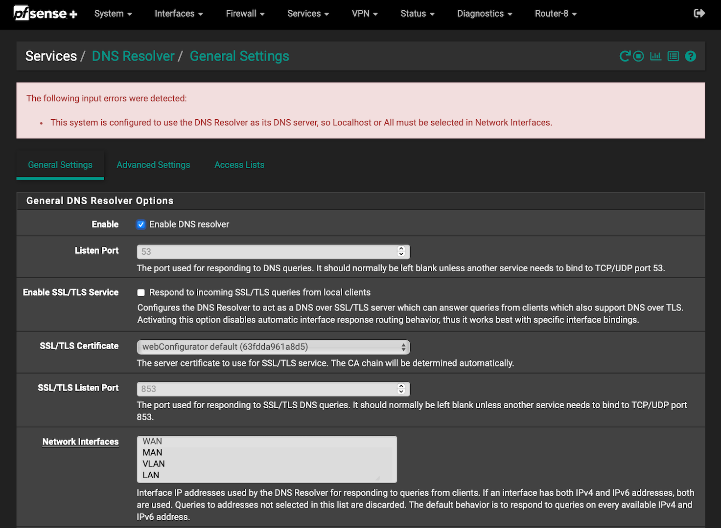

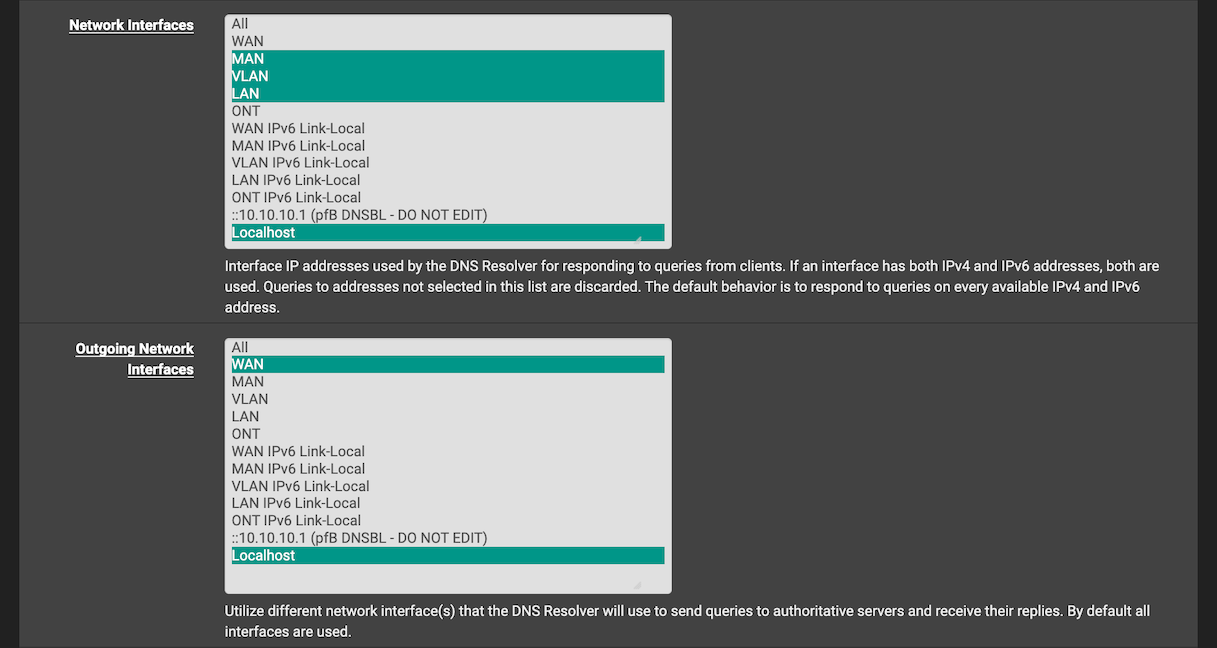

          For Interfaces I have selected only local interfaces and localhost. For Outgoing I selected ALL.
          I tried different scenarious with interfaces and it does not make a difference. Its strange.

            @markster Try All for Network Interfaces just to see. No one can connect on WAN unless it's allowed by firewall rule.

                                      @gertjan I decided, as a last resort try to start from default setting. Reset the box to default and re-entered the rules. Took me a while but now all its working as designed/intended.
                                      My Interfaces are set to include only local+localhost. Outbound is set to ALL.

                                          As for an interface going down, yep - got that T-shirt. I've been minded to change the 'All' bind to just my LAN interfaces to avoid a Resolver restart when my WAN link goes down / up again.
                                            I bind my outgoing to loopback.. That never goes down ;)
                                            And why would you have it listen on your wan? You serving up dns off your wan interface? When it talks outbound, that traffic would be natted to your public IP anyway, etc.
