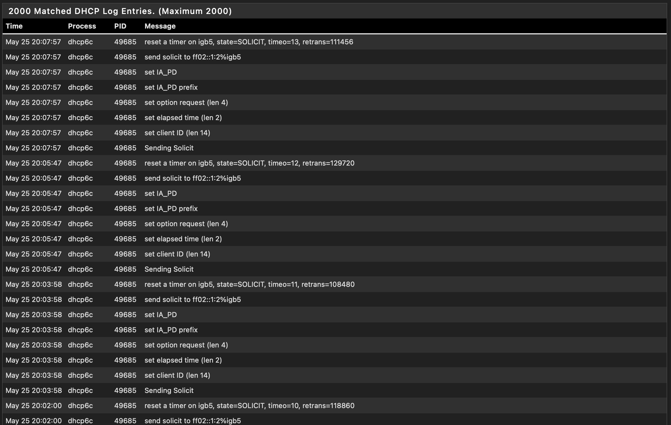

              So I don't get it. I had IPv6 (and working) since the update, I don't get a public IPv6. Only those hits on the firewall.
              Interface config did not change.
              DHCP log:
