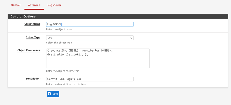

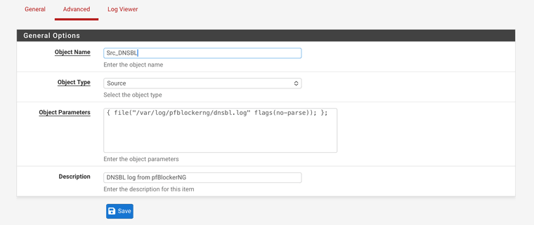

            Here are all my custom definitions:
            A example SOURCE is defined as follows (For just the pfBlocker DNSBL log)
            My LOKI Syslog Distination:
            And the LOG that binds them together:
            I use a REWRITE in the process to transform the content of a line from the logfile to mhy liking (something usable in LOKI). You can leave that out if you just want the raw lines.

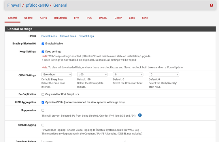

                                    @mauro-tridici Did you enable logging for the LIST or globally in pfBlocker? If you do not set the list for LOGGING in pfBlocker, the filterservice will not scrape the firewall log for entries created by that rule. Again reload - all is needed when you change the logging settings.
                                    But remember, your SIEM will then get the block twice. Both from the firewall log, and from the pfBlockerNG log. The block will be both places. The pfBlockerNG log is mostly used for its own builtin analysis and visualization feature. But you can use it specifically for getting a list of blocks specifically caused by pfBlocker.
                                      mauro.tridici @keyser
                                      hello @keyser ,
                                      yes I enabled logging for each LIST defined in pfBlockerNG. PfBlockerNG has been reloaded.
                                      Anyway, I can see the block entries only in /var/log/filter.log file and they are correctly sent to the SIEM.
                                      I would like to send both block logs (firewall + pfblocker logs) to the SIEM in order to get a list of blocks specifically caused by pfblocker (as you said), but, for the time being, it's okay to receive it once if we can't solve the problem.
                                      This is the current configuration of the test LIST of pfblocker:
                                      Thank you in advance,
                                      Mauro

                                          In addition, I noticed that:
                                          • pfBlockerNG is quite out-of-date and I think it should be updated (if you are agree);
                                          • the pfBlockerNG "rules" have been (correctly) auto-added to the pfsense floating rules;
                                          • no pfBlockerNG related rules have been auto-added to the WAN interface firewall rules;
                                          • this is the configuration of pFBlockerNG
                                          PfBlockerNG rules should be executed before all other rules, but it seems that blocked IPs are logged in the /var/log/filter.log file (and they are sent to the SIEM without any differentiator tag/label to distinguish the IPs blocked by pfsense firewall or by pfBlockerNG)
                                          Mauro
                                          • keyserK Offline
                                            keyser Rebel Alliance @mauro.tridici
                                            @mauro-tridici Oh, that’s a VERY VERY old version of pfBlockerNG. The v. 3.x current series is almost a completely different product - im not even sure your version has the reporting and log scraping features.
                                            What version of pfSense are you using?
                                            I would remove the “keep settings” selection, uninstall your pfBlockerNG, and then install the new v3.1.x from scratch. I would not bet on a succesfull upgrade - even if it is supported (I don’t know if it is).
                                            The try again with the current pfBlockerNG. I’m sure that will work like intended (and described by me)
