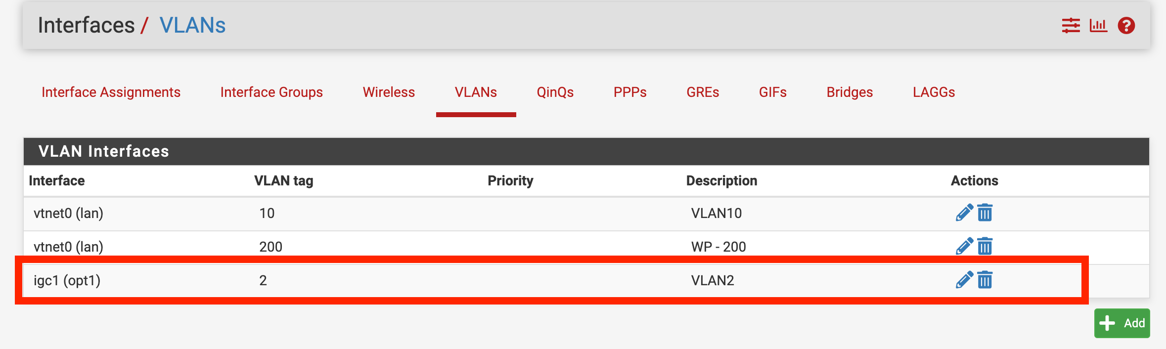

      I have a pfSense installation on a 4 NIC (Intel I-225V) mini-PC, versioning 2.6.0-RELEASE. I want to connect a managed-switch TP-Link SG108e to separate a public-accessible server, so apart from the normal CIDR range on that port(10.3.0.0/24) I added a VLAN2 under 192.168.2.1/24.

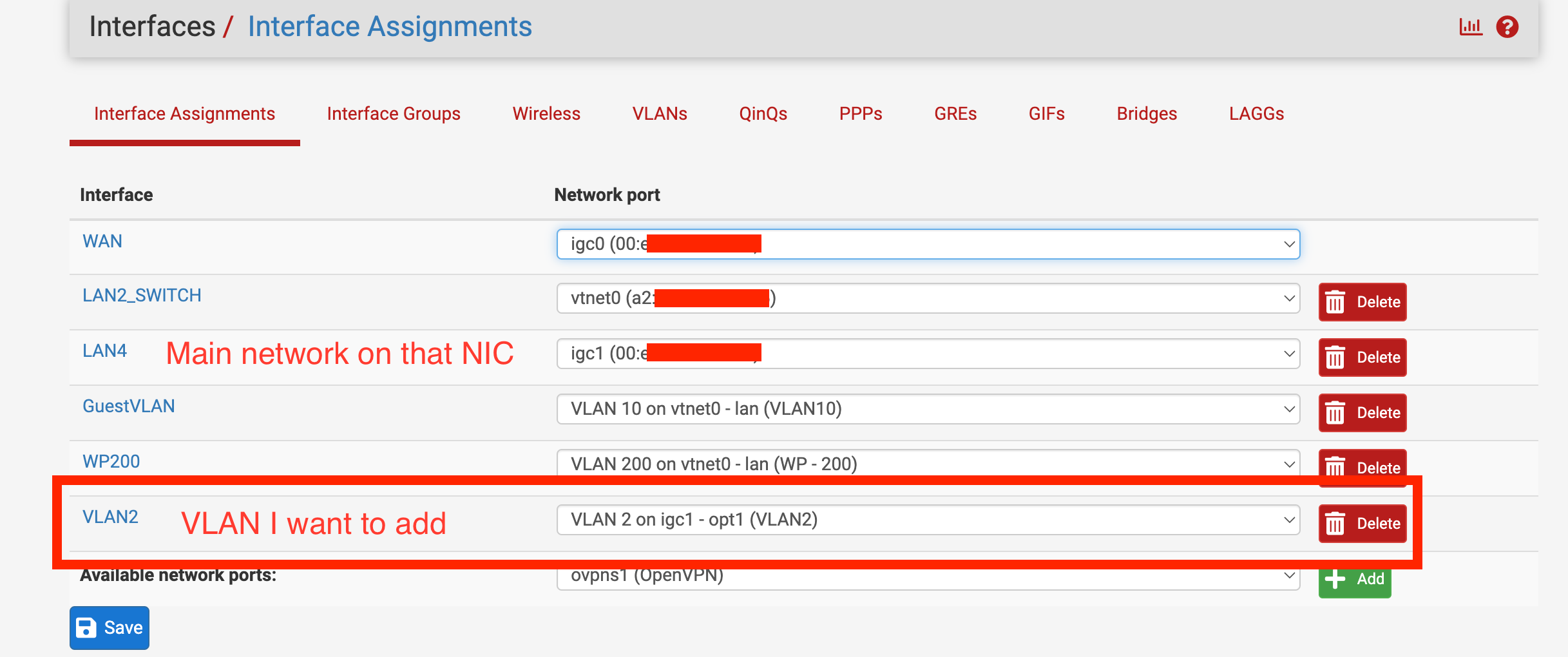

      ... then added an interface on VLAN2, with 192.168.2.1/24. Firewall rule was added to allow all traffic on VLAN2 and DHCP was also enabled with the correct range.
