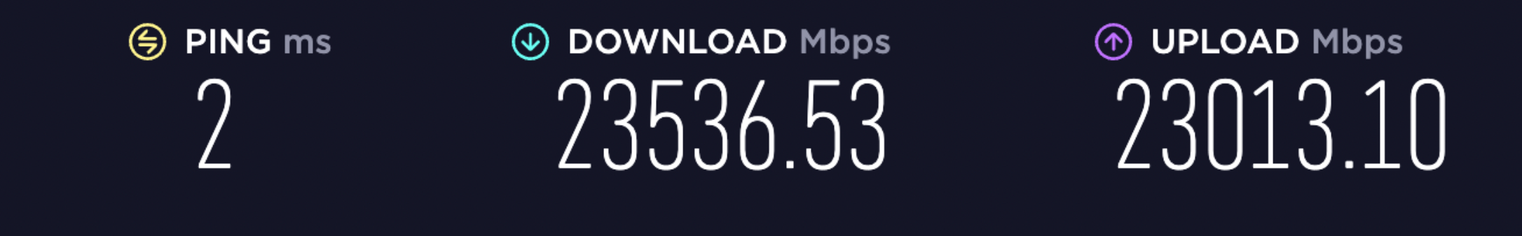

I managed to get PFSense working but I am not sure where the limitations are coming from. I have a 10/10 GBe FTTH Internet. But I am only getting these speed below.

@remi_imer said in Can PFsense handle 10/10 Gbe Internet?:
Wow - that is the highest upload speed I have seen on speedtest.net. Here in the UK it usually chokes at around 4000 to 5000 Mbps. A year ago it was only around 1700 Mbps upload (if it was really quiet), so they have made major improvements to their server infrastructure to test at > 1Gbit.
We still find that speedtest.net offers the highest bandwidth for testing 10 Gbps links but never to saturation point. Other online testers were much more bandwidth limited or, in the case of fast.com, pretty much random number generators at higher bandwidths.

Thanks a bunch for your input and also for sharing the article. Perhaps that was true at the time of publication, however, things have significantly changed at present.
Speedtest.net definitely made some improvements to its server, such that it can give you close to 25 gigabit download and upload.
Check out this guy's article on how he achieved this. Link below. PS: he is using a Linux Router which he wrote himself called router 7
This guy is using the same provider as I am, but he opted for the fastest tier available, which is 25 Gigabit. I am eligible for 25 Gigabit also, but I wanted to test the 10 Gigabit first since the upgrade path was for free
So yeah I am definitely convinced that there are some hardware limitations of some sort.

@stephenw10 hi there,
I did exactly as you said and this is what I found during testing. I dont know what am i suppose to be looking at here
last pid: 52273; load averages: 0.24, 0.23, 0.18 up 3+12:58:31 01:27:23 204 threads: 7 running, 162 sleeping, 35 waiting CPU 0: 0.0% user, 0.0% nice, 0.0% system, 58.8% interrupt, 41.2% idle CPU 1: 0.0% user, 0.0% nice, 0.0% system, 50.0% interrupt, 50.0% idle CPU 2: 0.0% user, 0.0% nice, 0.4% system, 12.2% interrupt, 87.4% idle CPU 3: 0.0% user, 0.0% nice, 0.0% system, 6.1% interrupt, 93.9% idle Mem: 21M Active, 47M Inact, 404M Wired, 82M Buf, 3363M Free Swap: 3656M Total, 3656M Free -
I also did what you suggested here.
/root: sysctl dev.cpu.0 dev.cpu.0.temperature: 57.0C dev.cpu.0.coretemp.throttle_log: 0 dev.cpu.0.coretemp.tjmax: 100.0C dev.cpu.0.coretemp.resolution: 1 dev.cpu.0.coretemp.delta: 43 dev.cpu.0.cx_method: C1/mwait/hwc C2/mwait/hwc dev.cpu.0.cx_usage_counters: 43323265 0 dev.cpu.0.cx_usage: 100.00% 0.00% last 277us dev.cpu.0.cx_lowest: C1 dev.cpu.0.cx_supported: C1/1/1 C2/2/148 dev.cpu.0.freq_levels: 3201/84000 3200/84000 3000/76349 2900/73036 2700/66595 2500/60408 2300/53689 2200/50804 2000/45218 1800/39849 1700/37248 1500/31535 1300/26734 1100/22147 1000/19936 800/15661 dev.cpu.0.freq: 3201 dev.cpu.0.%parent: acpi0 dev.cpu.0.%pnpinfo: _HID=none _UID=0 _CID=none dev.cpu.0.%location: handle=\_PR_.CPU0 dev.cpu.0.%driver: cpu dev.cpu.0.%desc: ACPI CPU -
Here's an update.
I connected my PC directly to the FTTH OTO Socket without pfsense router and perform the test.
Unfortunately the result is the same with or without pfsense router.
Perhaps there is an issue with my 10 Gb NIC. Or there is an issue at the fiber cable somewhere.. or at my ISP. Will call them tomorrow to find out.
Ah, well that's mostly good then.
No CPU core is at 0% idle (100% used). The loading could be spread better.
The CPU is running at 3201MHz. The extra 1 there implies turbo is enabled.
So it should be capable of more if there is more to be had.
You might try a local test between two 10G interfaces to confirm that.
