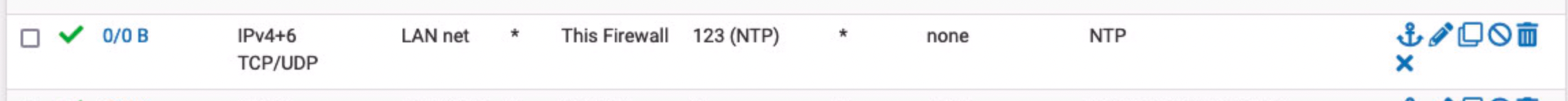

I have this NAT rule;
(local_lans is a interface group with all but WAN)
and enabled NTP server under Services, selected the Interfaces I want NTP for.This should do it, right?

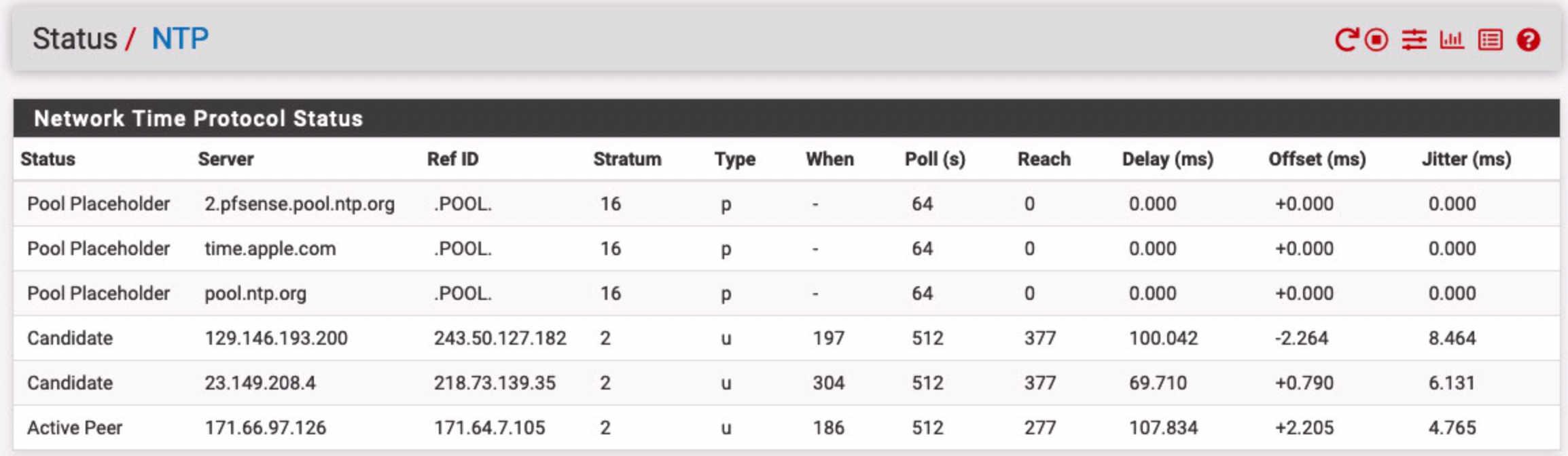

@furom The pfSense GUI will show you when and how often it is polling from the sources and if they are actually available:
You can go deeper than this but it will probably answer your question.

@furom Understood. Are you going to post your Status / NTP table?
@RobbieTT Here it is, it looks a lot like yours I suppose

@furom It's not looking that healthy. One active peer is good but there are no other NTP servers with "Candidate" status.
Has it recently been restated?
@RobbieTT Yes, I have been fiddling with it, so probably why

@furom ntpq is polling at the correct rate, which is at the default of 64 seconds, but it will relax to a slower rate if/when it is happy.
At this point I think we are looking at your ntpq instance issuing KoD at a LAN client or clients. This may be due to an excessive request rate or simply due to ntpq not being happy about its own status.

Did you forward NAT request to your pfSense on local interfaces? -
@viragomann Yes, I have rules like this in place on them
