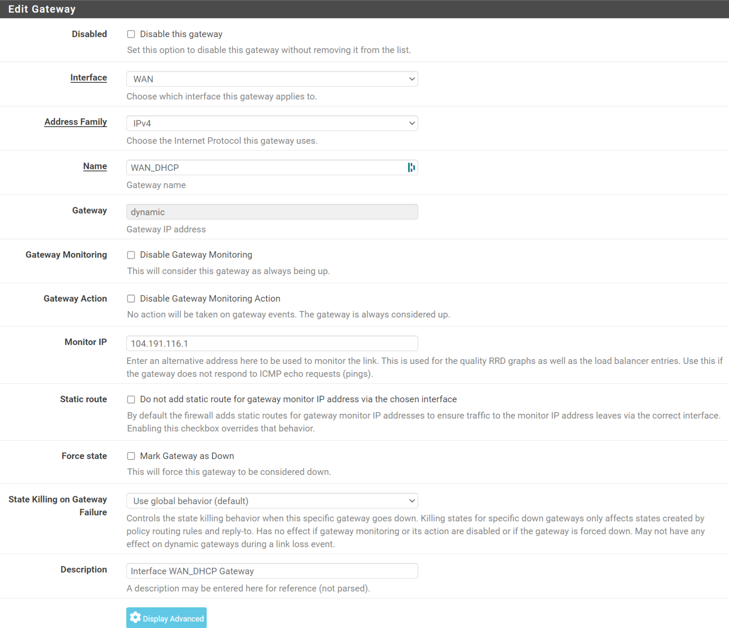

                        The Gateway setup is exactly how the documentation said to do it. I'll include some screenshots taken this morning.
                        Screenshot 2023-06-09 at 10.12.27 AM.png !
                        Screenshot 2023-06-09 at 10.11.57 AM.png Screenshot 2023-06-09 at 10.12.13 AM.png Screenshot 2023-06-09 at 10.09.15 AM.png Screenshot 2023-06-09 at 10.10.27 AM.png Screenshot 2023-06-09 at 10.11.05 AM.png
